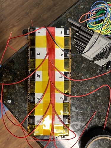

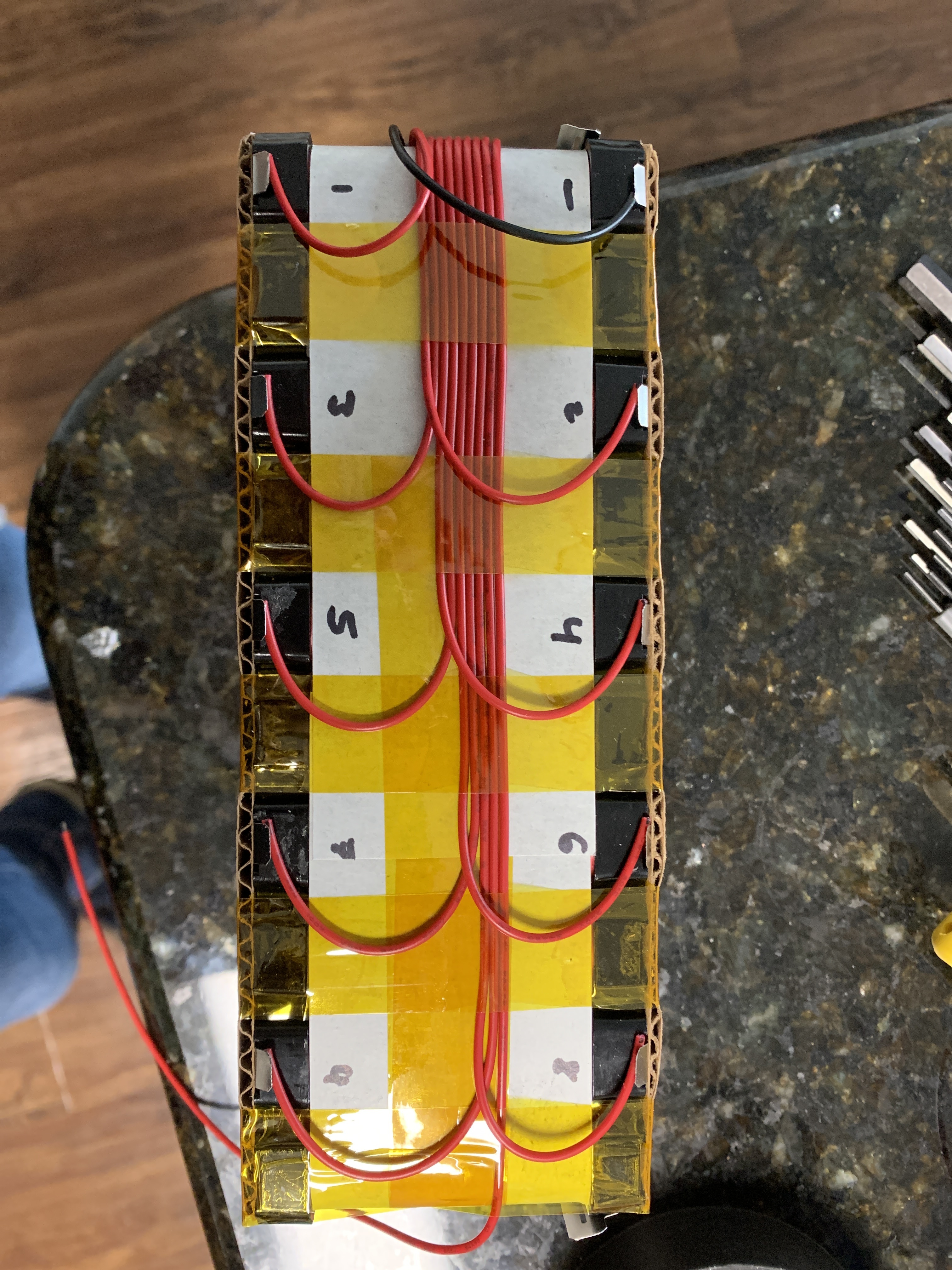

Is there any better way to run the balance leads? I can tape them down so they are secure where they cross but they still cross
Those are quite thick I dont think it will be a huge issue. You could use fishpaper at each point it crosses
That’s totally fine
Something like this…
What’s that tape you’re using?
Fiberglass tape, or more commonly known as heavy duty packing tape

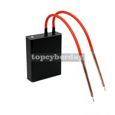

Try this: Battery spot welder :kissing_smiling_eyes:
That looks great!
What size of nickle it can handle? :thinking:
Wait it runs off a USB…? Like 5W charging? How fast can you actually get good welds with that
Can be used to weld nickel sheet with thickness less than 0.12mm.
Built-in battery, no external power supply required.
I don’t know anybody using nickel that thin. Cool device though. For whoever has a use
I saw those on eBay for 50ish I think, up to .15 iirc

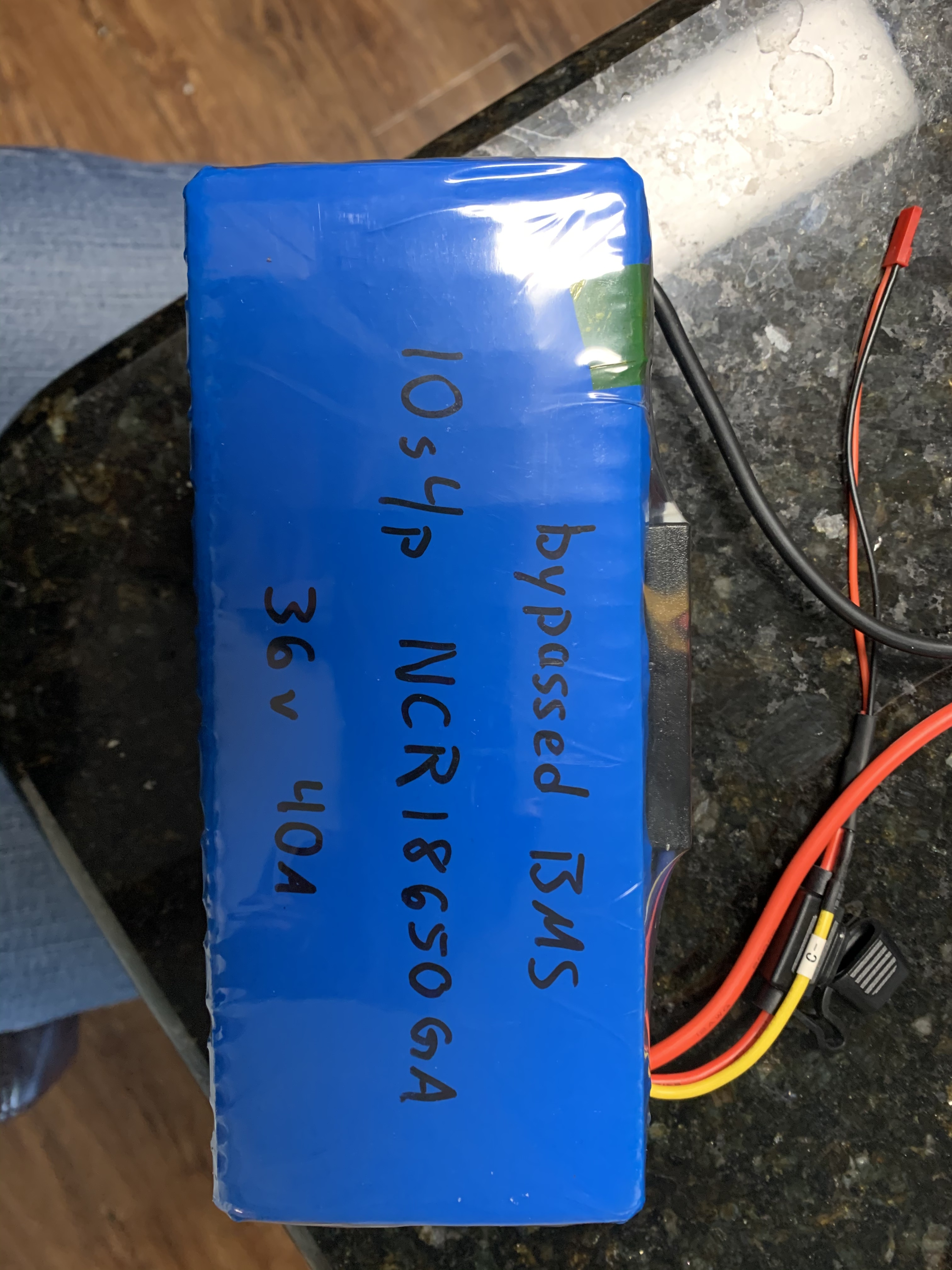

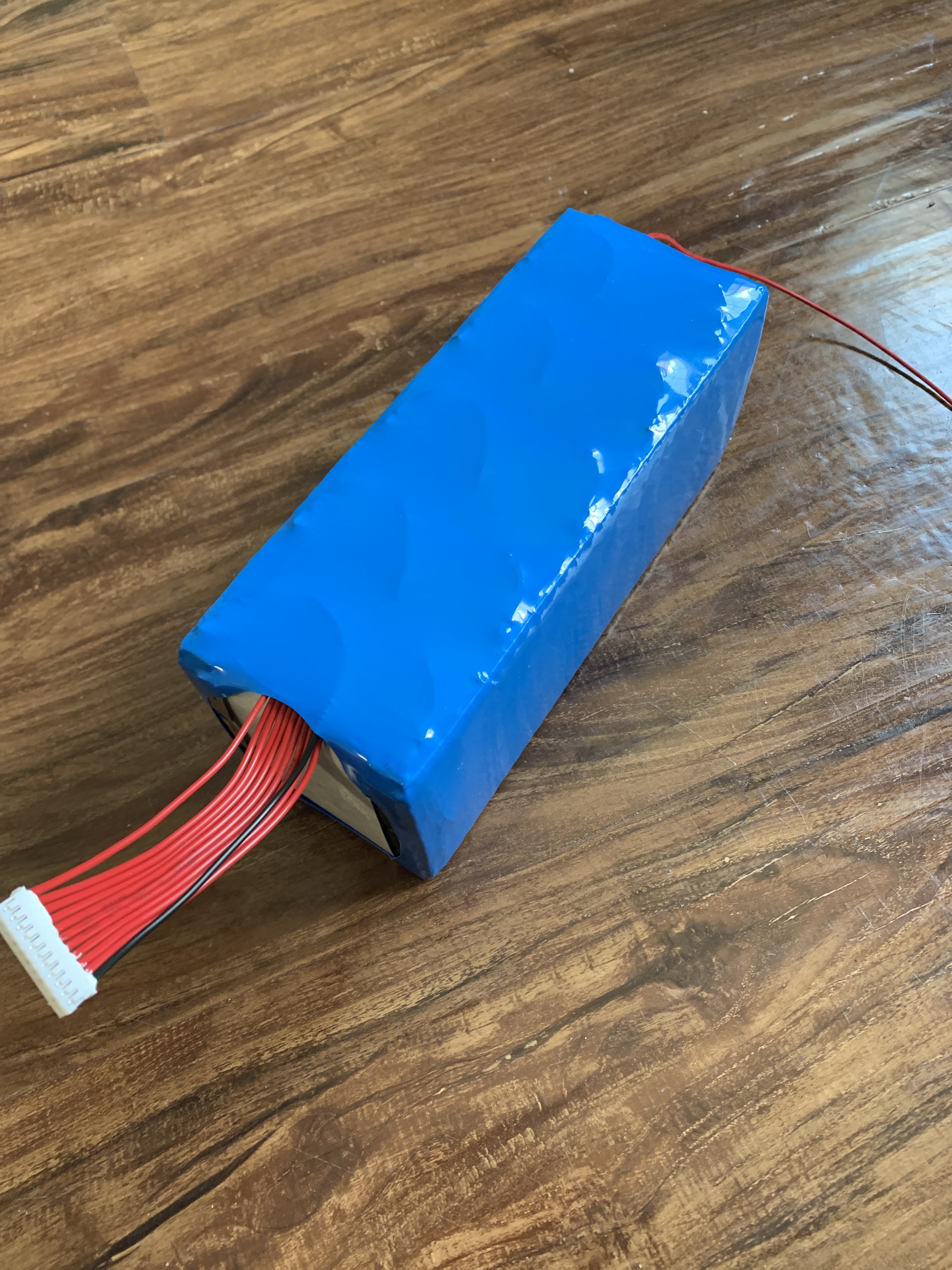

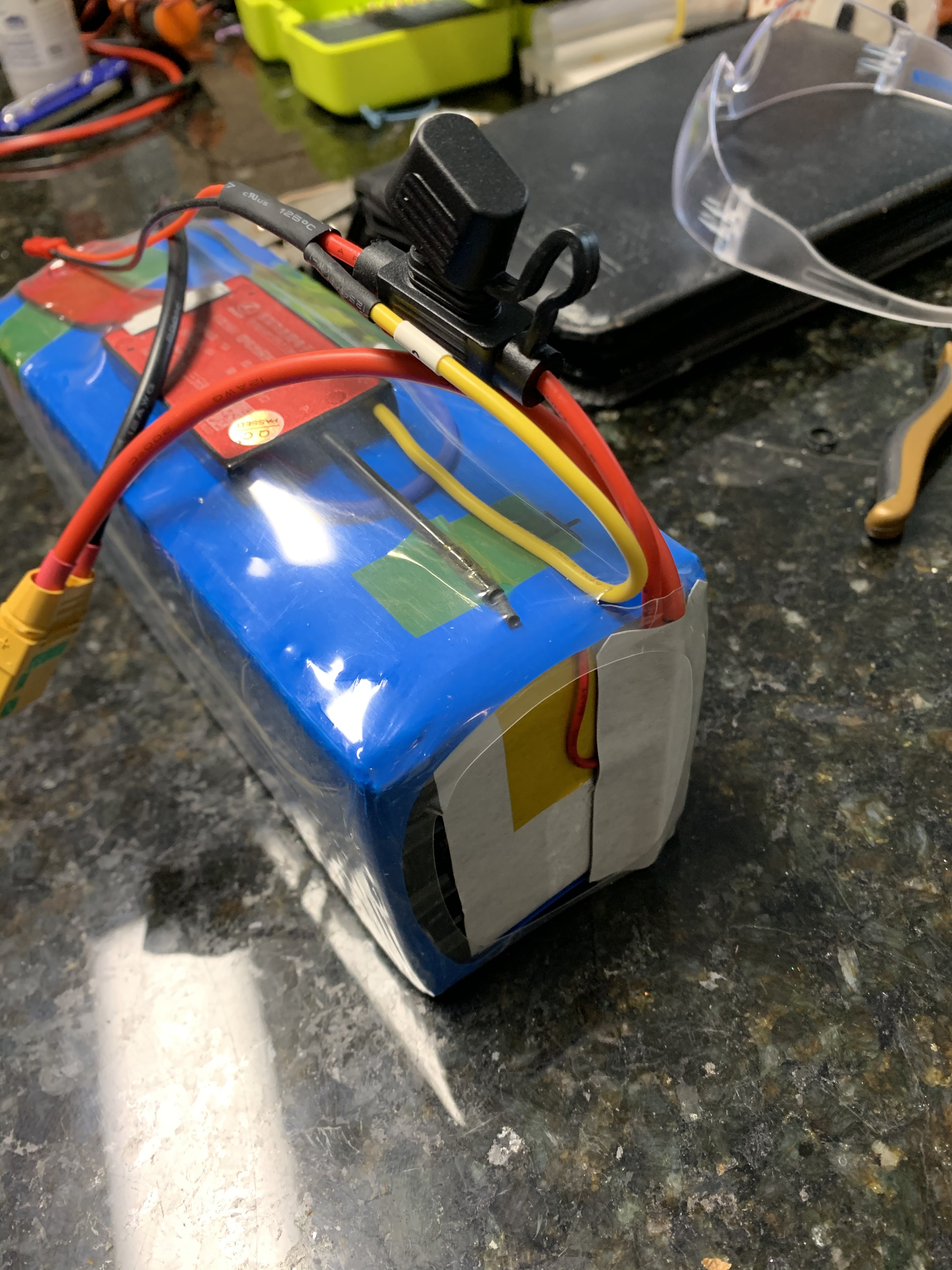

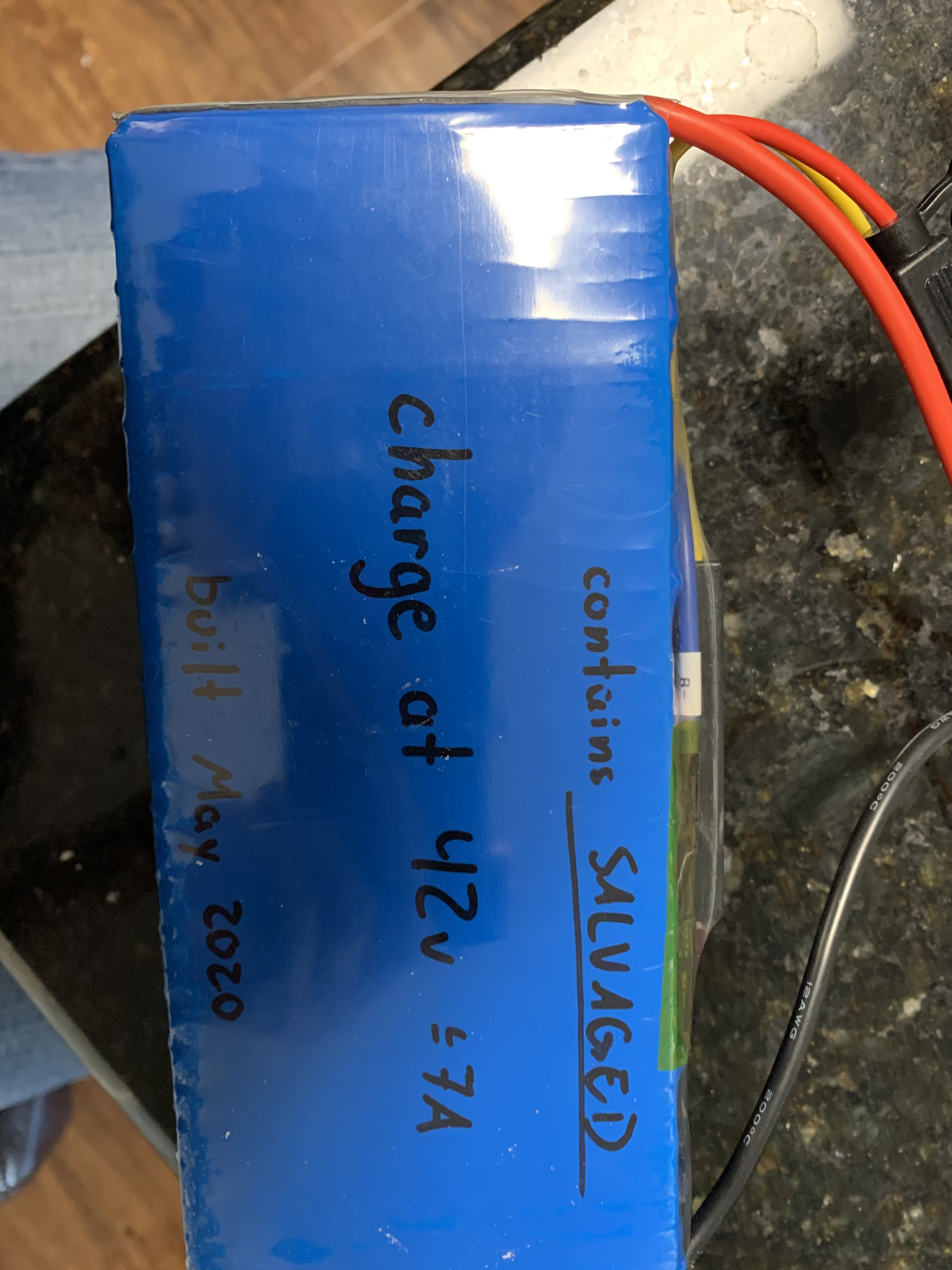

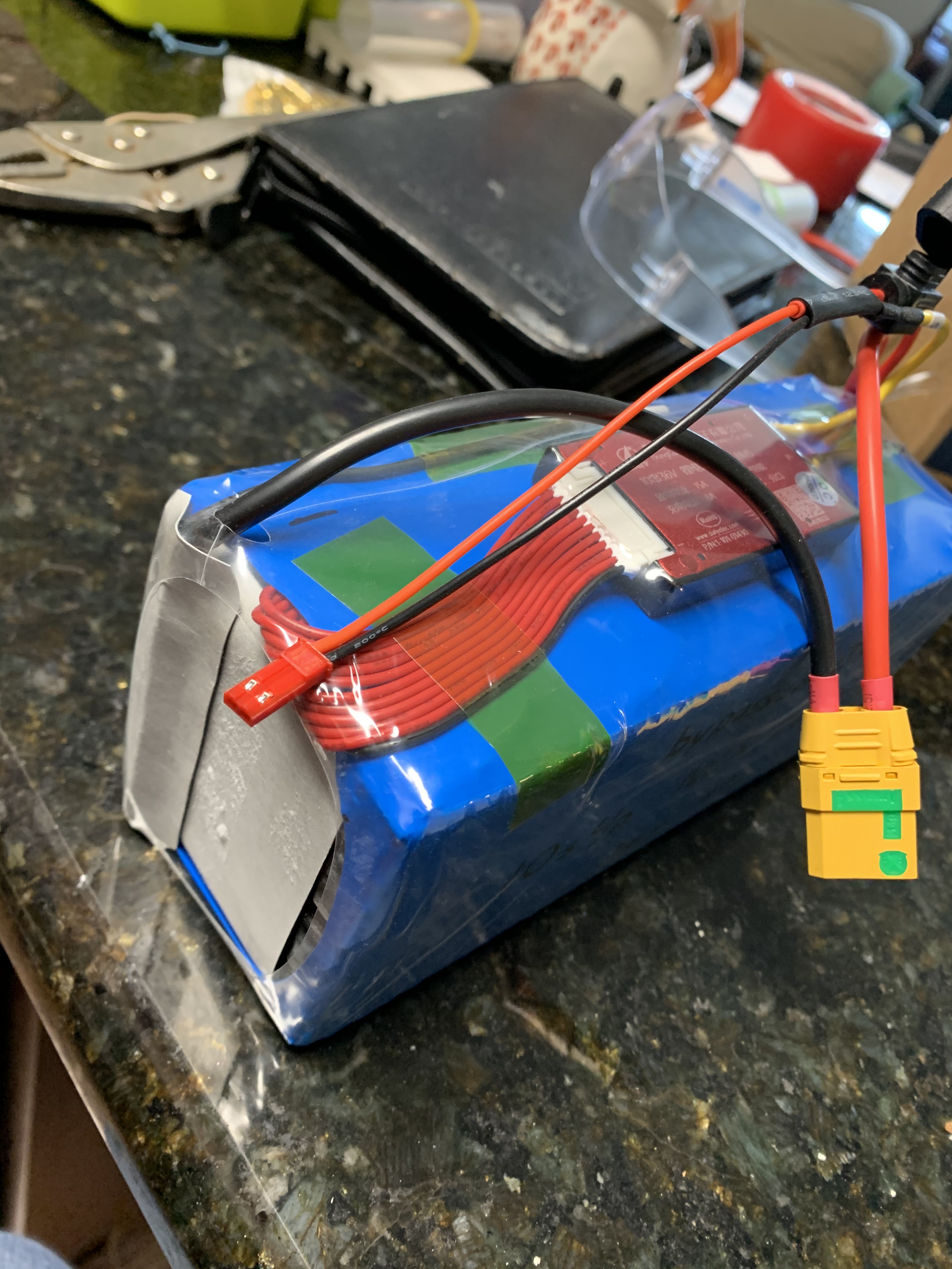

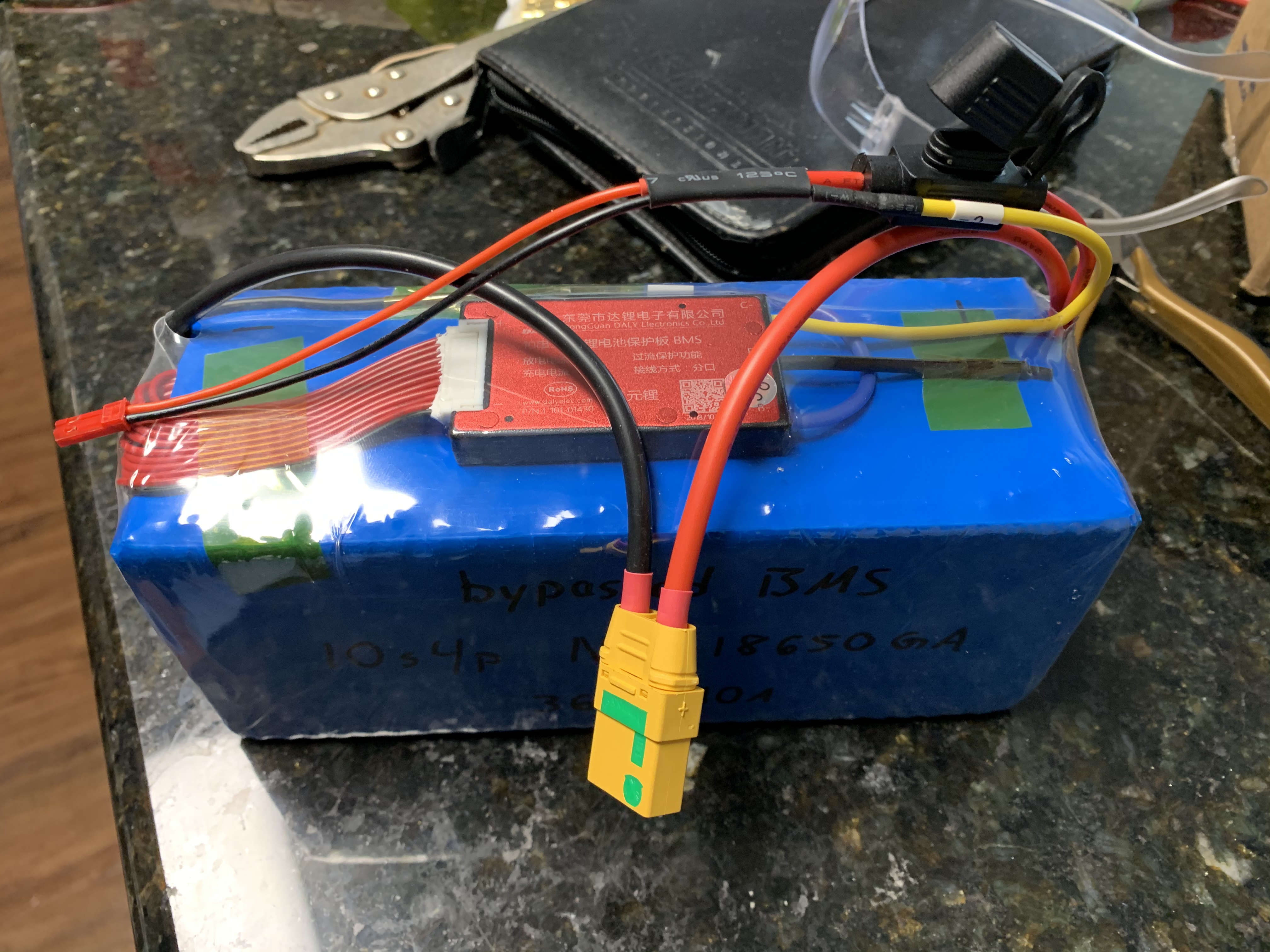

I’m very happy with how this turned out… everything is well insulated (plastic holders space the cells out, fish paper rings on the positive terminals, all nickel has been rounded, all balance wires are layed as flat as possible with an ass load of tape and fish paper, there is a card board plate on the nickel and fishpaper wrapping the cells, it’s been double heat shrinked with the wires coming through little slots), it looks pretty, and it’s idiot proofed (XT90s termination and 5A fuse wired in). I feel this is good enough to give to someone I care about
Actually it’s a 7.5A fuse…I seem to be out of 5A
heck yeah, I’d ride that pack, nice work :+1:
