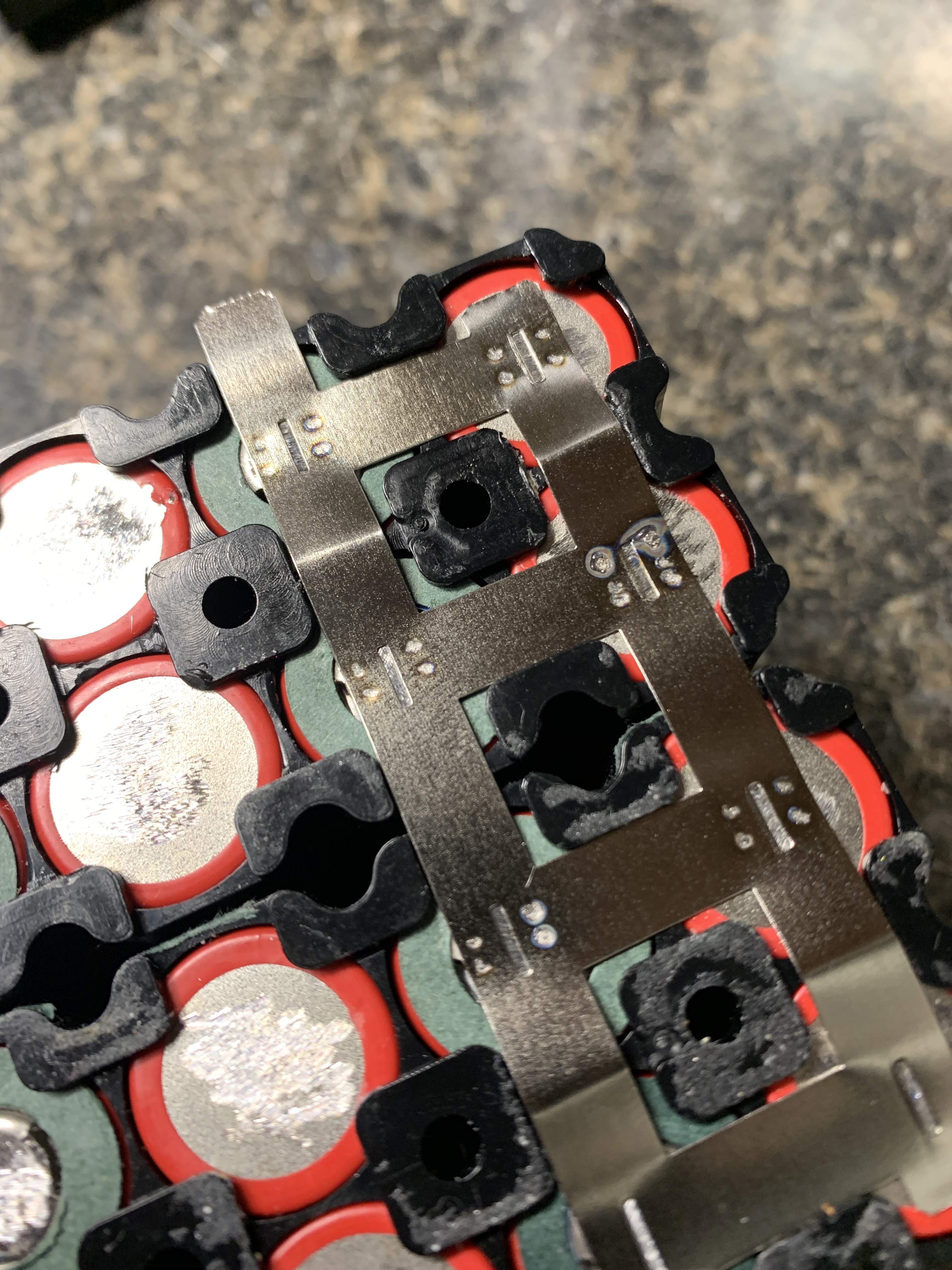

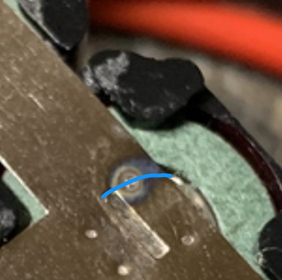

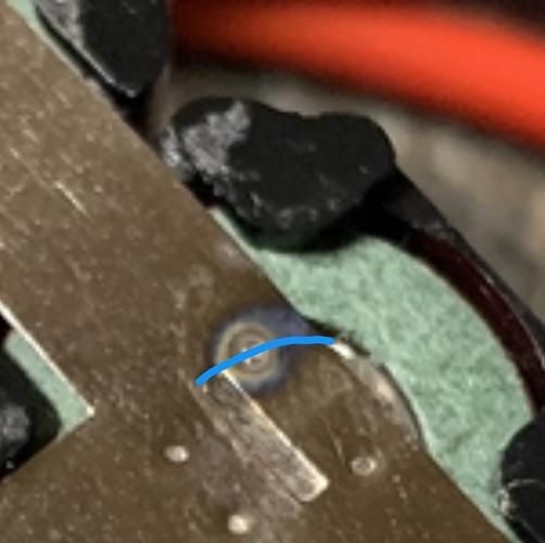

looks like you just missed the battery terminal
Thing is I got it to work on my 12s4p, sanded the cells the same way, basically the same nickel too… All of those cells were totally sanded
Yeah that one I did miss, but on the next belt it looked holes through on the negative ends too that went the problem (that was my first weld off the month so needed some practice)

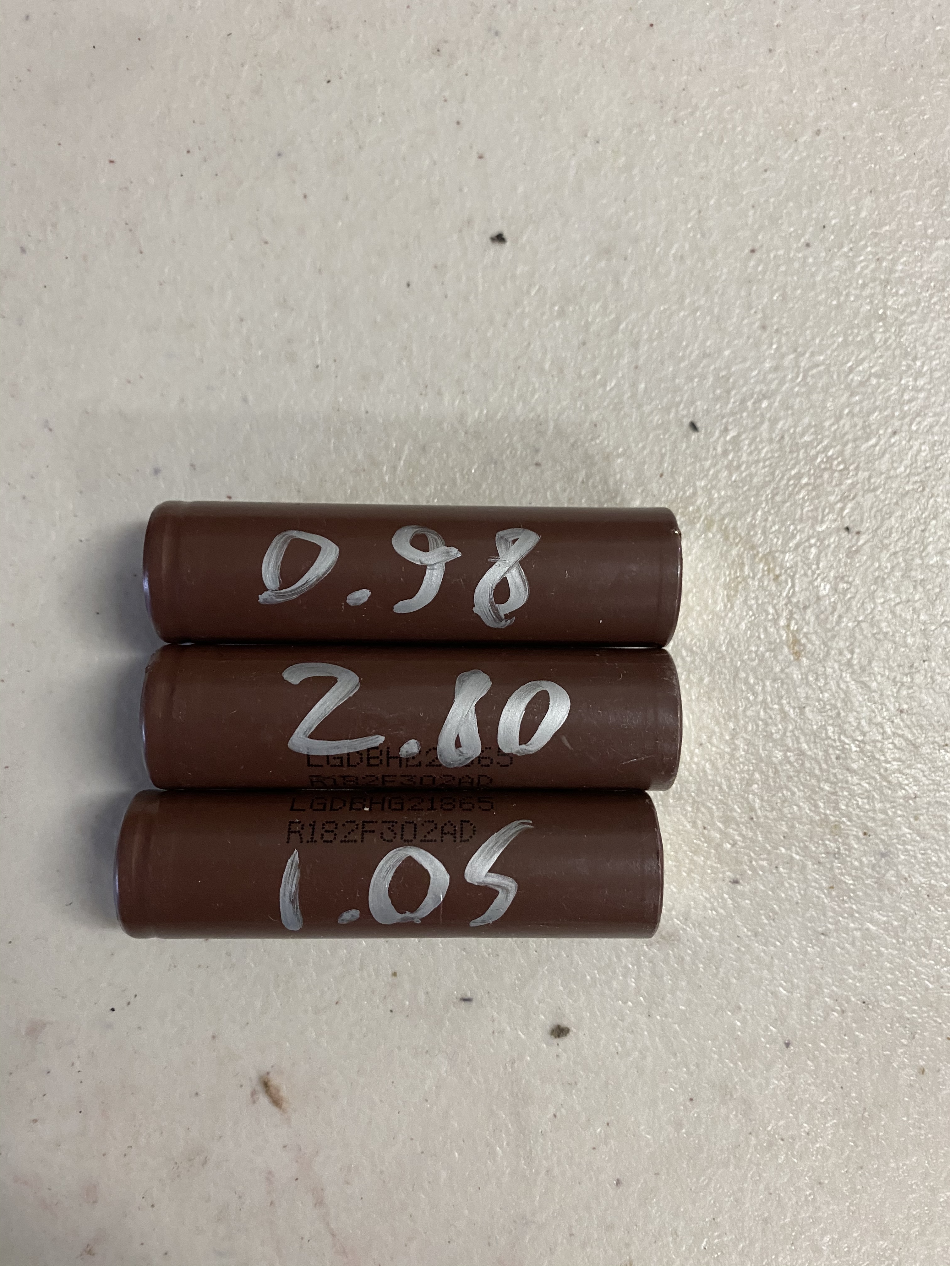

@Arzamenable How are those BatteryClearingHouse LGDBHG21865 cells so far other than Fedex drop-kicking the package out the back of a moving truck? I’m planning on buying some tomorrow, just wanted to get your first impressions.
Three showed up dead. A few other needing to be re wrapped.
Cool. I’m doing a 10s8p so hopefully I get enough good cells for the whole pack and hopefully a spare p group.
