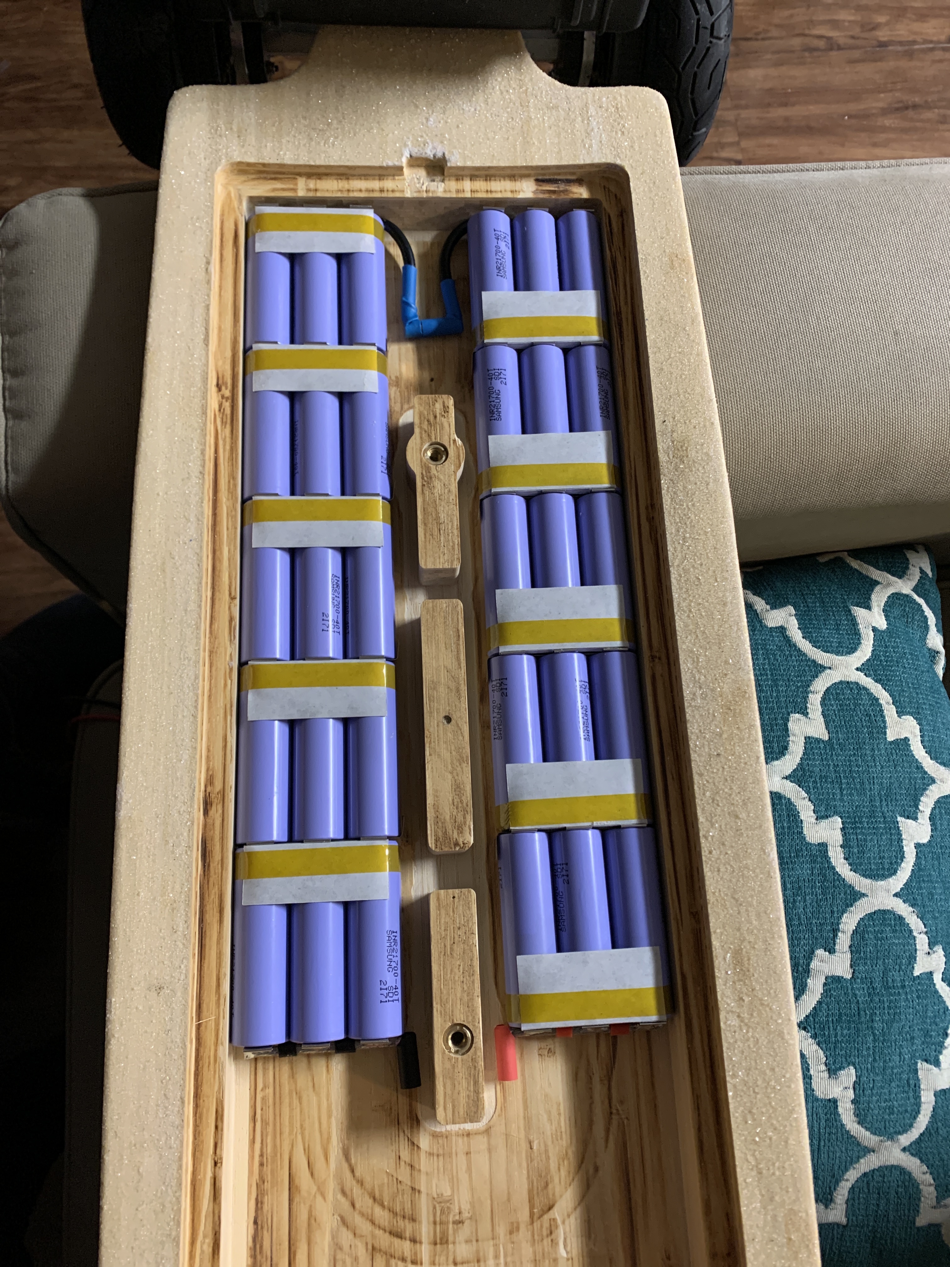

Is this setup sufficiently sexy?
haha, nice work, that pack is sexy enough for me😂

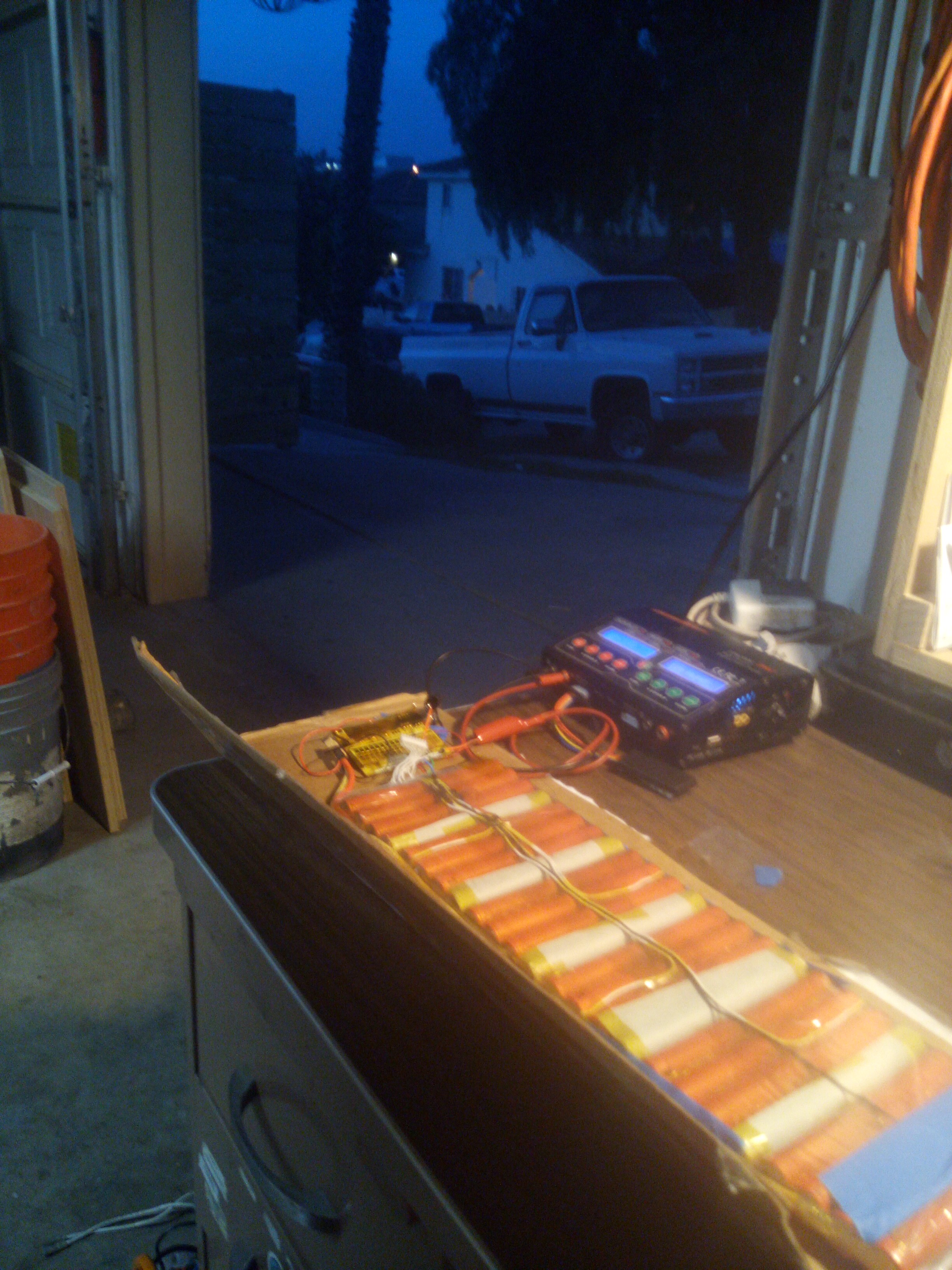

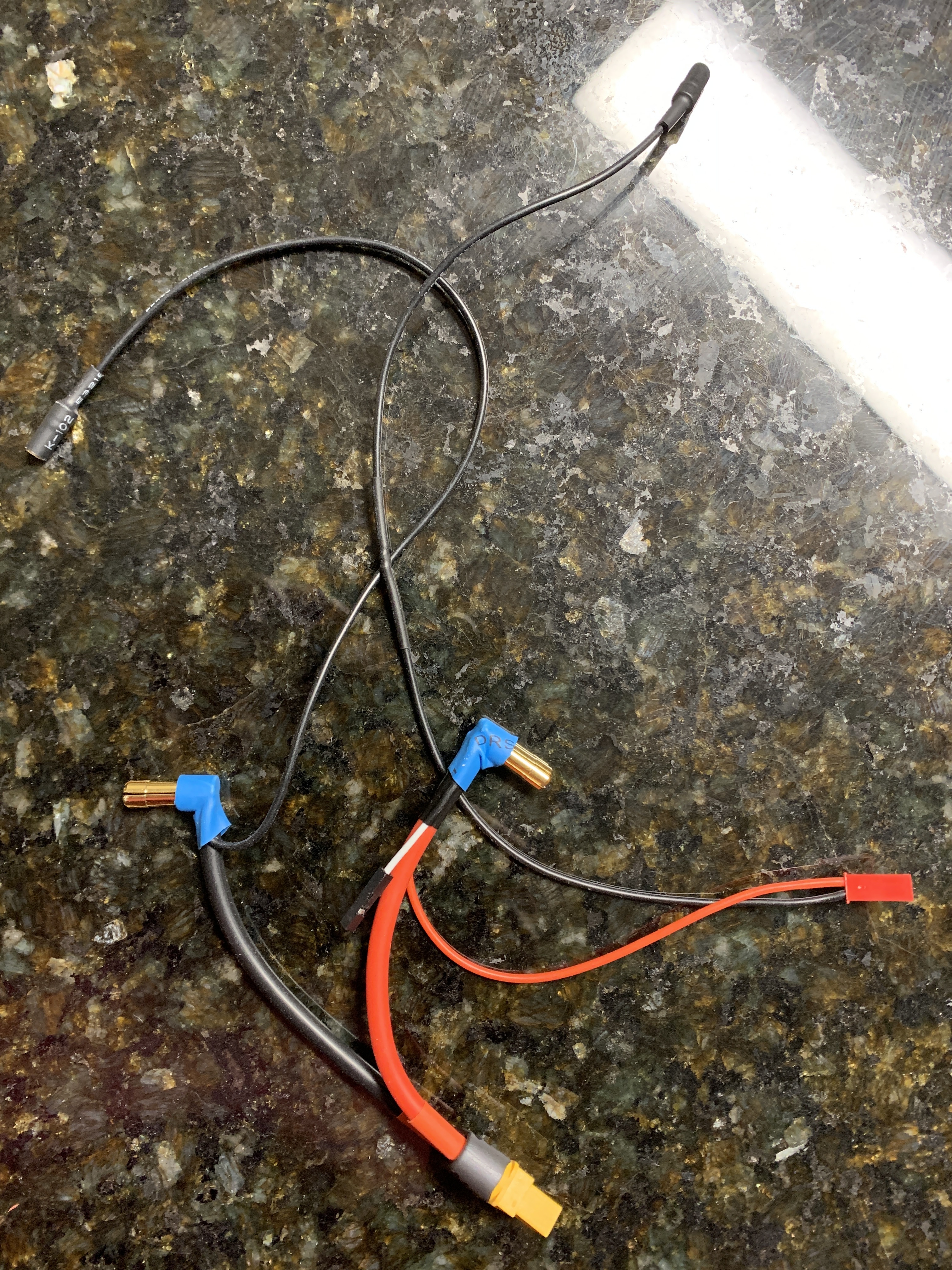

meanwhile, I’m here ready to chuck this pack out into the street, cautiously charging a low p-group on this pack. had some broken charge leads, patched it up and crossing my fingers ![]()
Yikes man, what happened to it?
It came in here broken, I think 1 or 2 of the charge leads just broke loose from vibration and took the pack out of commission. It’s all wired right now, so I just have to get that low p group back up to where the others are and it should be good. Been diagnosing and repairing packs for local boyz @KaramQ @Bobby (hood)

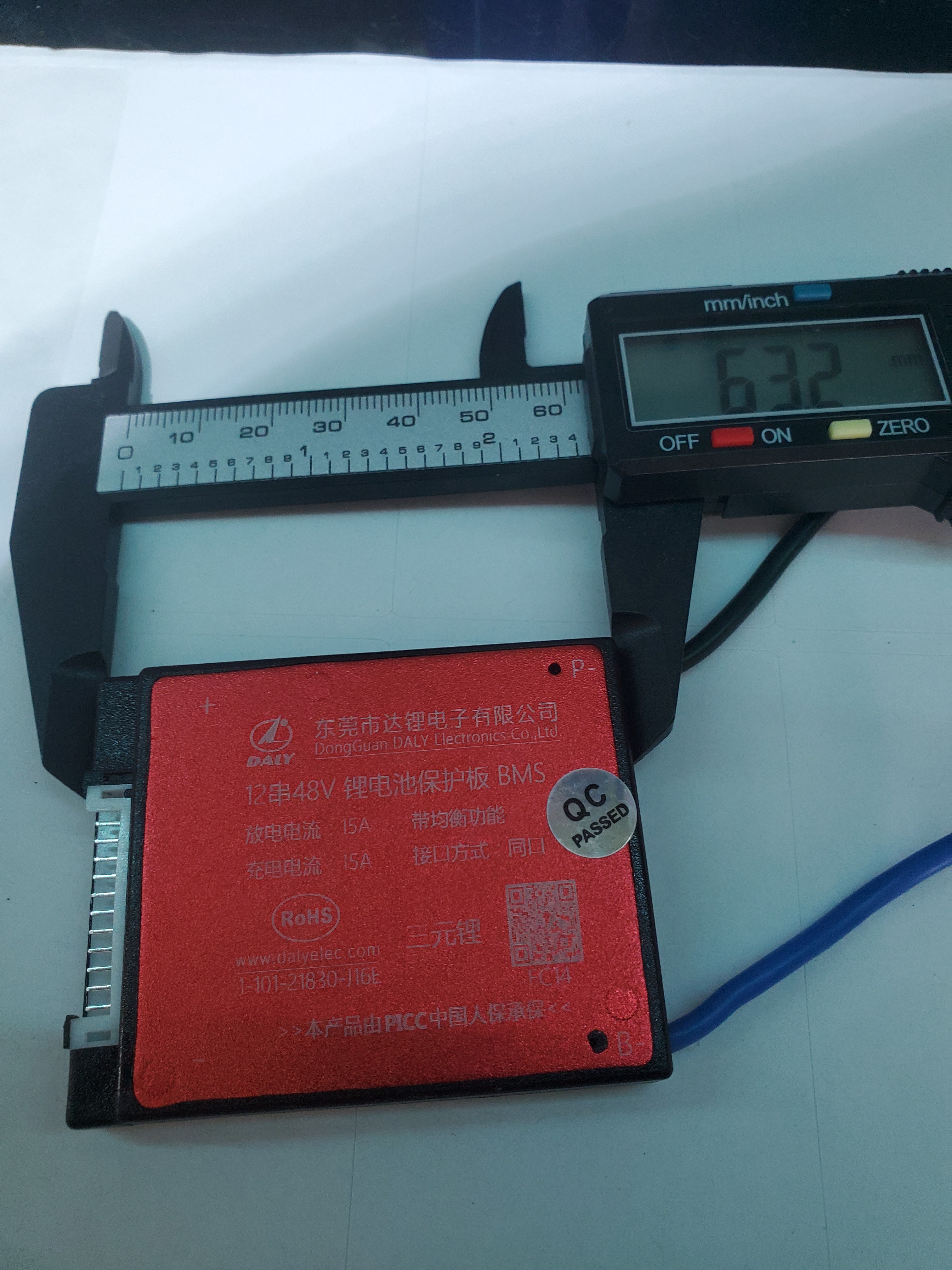

Hi, I am currently riding 2 6s 5000mah lipo batteries in series, and having to charge them everytime with a balance charger, which is quiet annoying.
I will like to charge them using this DALY red waterproof BMS
They offer a separate/common version, but I am assuming for BYPASS it doesnt matter which version I get?
Also, since the 12s version is not appearing in the store, I am assuming the best advise is to buy this 13s version, and ask them that I would like the 12s version ?
Thanks in advance:)
Doesn’t matter if you take common or separate port, both will work. But take common, so you won’t get unnecessary wire ![]()
Yes, we are all doing it like that. Order 13s and write to the seller that you want 12s. They will deliver.
there is a 12s version

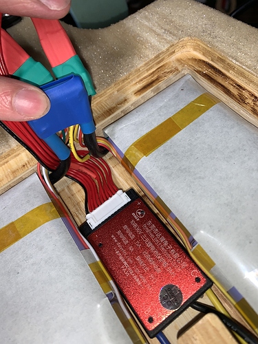

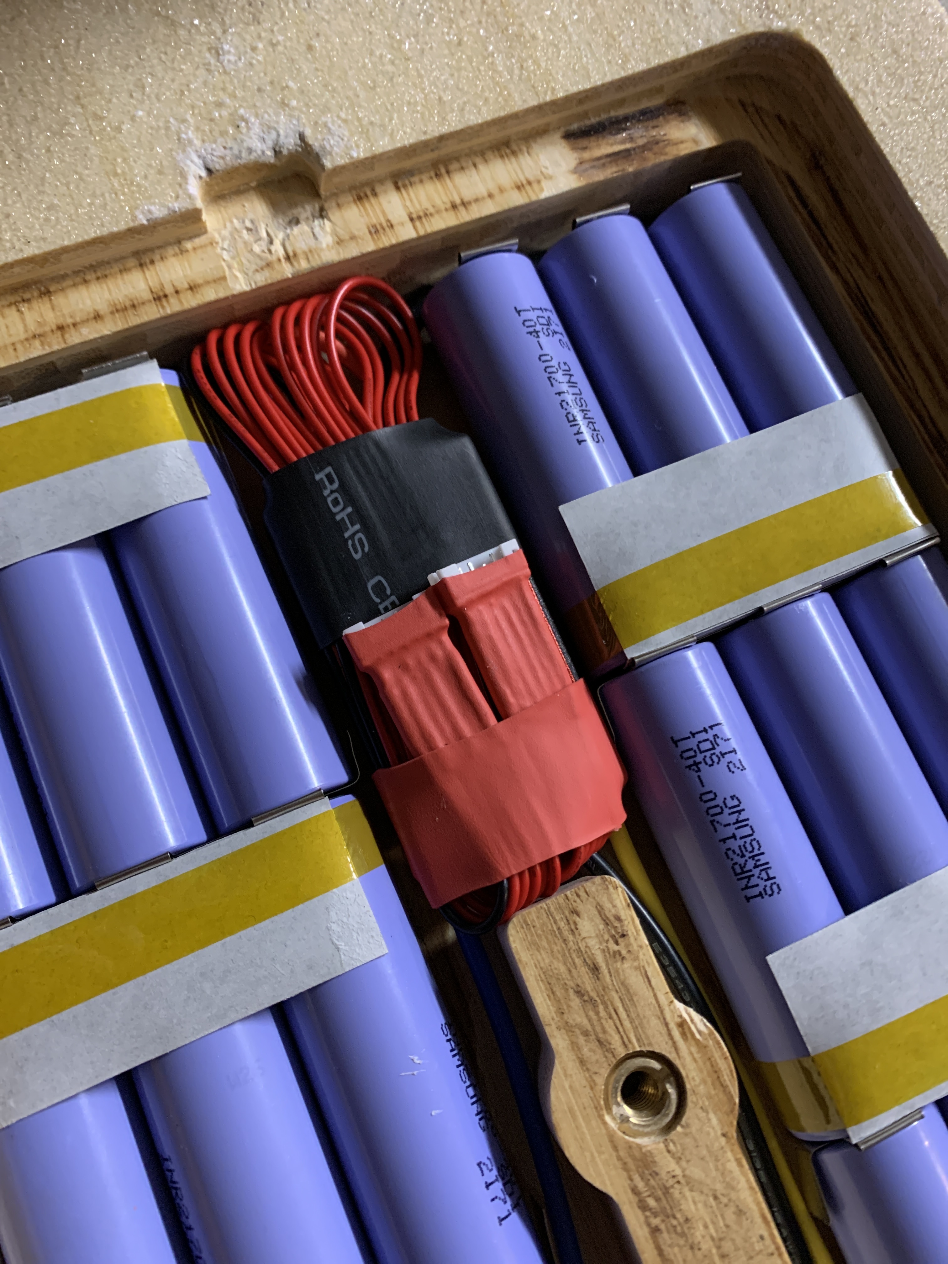

Yes, and good work with that pack… clean as hell.
Dip it in liquid electrical tape? or just glue all over it I guess is cheaper.
How easy is liquid electrical tape to apply cleanly? I never heard about it until I saw someone else here use it, looked like it would be a bit of a mess
They have a little brush in the cap usually. I would just tape off the bullet connector then go ape shit.
I think epoxy would do the job just as good and you prob already have some.
EZPZ. Masking tape, apply liberally, remove tape while still wet.
