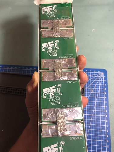

I doubt it’s worth the hundred dollars to try and save these cells, unless you are just trying to make a battery building lesson of it.
you’ll spend all day on it and in the end, you’ll have crusty old cells to work with. THEN you’ll spend the same time building the battery as you would with new cells…
it depends on the cells, but generally with a pack that crusty, usually better to start over :+1:
Exactly like you showed on the pictures.
Note taken, and agreed. At the end of the day I would not even save much by keeping the cells. Because it is only 10s2p, and Samsung 30Q are not that expensive. I will still be saving a lot by salvaging the case, BMS and connectors. I can scrap all the old cells and get everything I need for under $150.
@iamasalmon & @Andy87
I have made up my mind and will be responsibly recycling the old batteries. As for re-building the pack with new cells, I am confident that I can rewire and desolder the connections without trouble.
In terms of keeping the new battery pack from breaking… I see a lot of people here raving about fish paper and also tons and tons of kapton tape. My old pack only has thin strips of broken (probably cheap chinese) kapton tape.
I would like to do it the right way and ideally improve upon what I got from the factory, any tips there to make it last?

Fishpaper on the positive terminal and between the p groups is always good. Also between bms and cells I would add a layer of fishpaper.
You could conformal coat the bms for some extra water protection or seat everything covered with neutral silicone in the battery case. Might want as min check the sealing of the battery box. Maybe you can improve that somehow or replace old sealing if the rubber is damaged etc.

The pack you showed used kapton tape incorrectly. It is broken because it was worn through, probably by pressure in those spots and constant vibrations.
Kapton tape is good for high temp, high voltage electrical isolation. It doesnt have a very robust adhesive (compared to a lot of other heavy duty tape) because its not really meant to hold stuff together. Most importantly, its not abrasion resistant at all, because its not meant to be subjected to abrasion.
I actually saw someone make the case in this thread a while back about how there really isnt an application in esk8 for which kapton tape is perfectly suited. Nothing that we are isolating should be getting hot enough to need the heat resistance of kapton, and we are not using high enough voltages that the high-volt isolation is needed either.
Pretty much all of our electrical isolation needs are better suited by fishpaper. It is highly abrasion resistant, and if you got the good stuff, it is more that heat resistant enough for esk8 use. (If anything in your esk8 is getting hot enough to hurt your fishpaper, you have much bigger problems).
Thats not to say that Kapton is useless in esk8. It works well as a thin, lightweight barrier over electrical terminals that you also separately isolate from abrasion.
In the dirt surfer’s picture here, you can see that he used Kapton over all the exposed terminals of his battery, but covered those with a sheet of acrylic that is both abrasion resistant and electrically insulating. Really the kapton is only there for peace of mind and in the very rare unlucky instance where something conductive slips between the acrylic and the battery. The rest of his battery (all the parts with a chance to be in contact with anything else in his enclosure) are isolated with abrasion resistant tape (he could instead have used fishpaper here).
