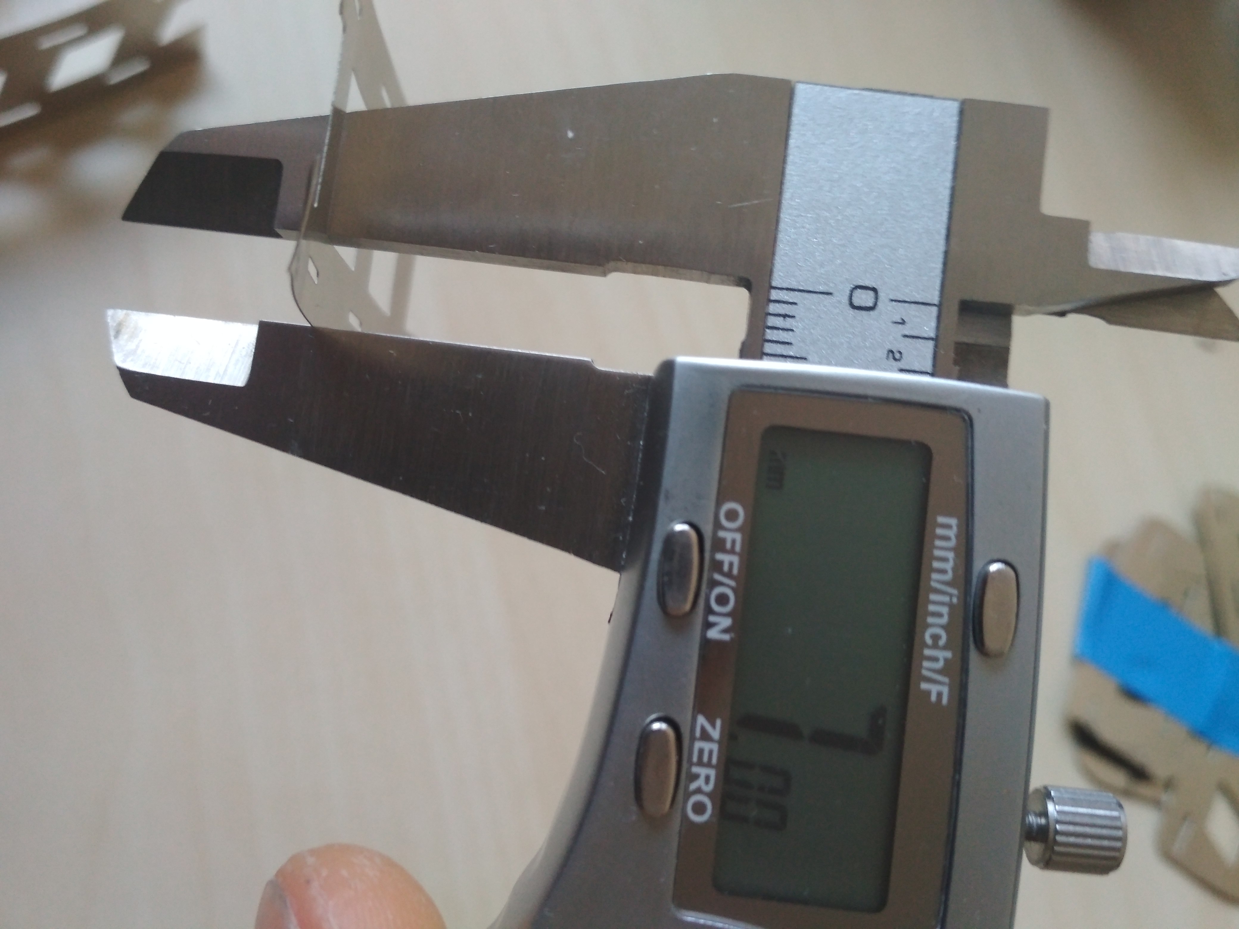

I need your help please. I would like to do a battery 10s3p with samsung 30Q.
I’m bloqued becouse i’m not sure witch nickel (pure) strip i can/should use.
At this moment I have:
  1. H 7mm 0.15 but it has 20mm from center to center (normaly use with the holders)
    I could make configurations:
    a)
    b)
    c) but here i’m not convinced due only 2 transitions
  2. H 8.8mm 0.15mm
    and i could do:
    a)
    but i’m not sure if it’s a problem but one transition will be smaller
    b)
    like 1c) only 2 transitions, but the strip is wider
  3. 10mm 0.15mm strip and i could use it
    a)
    cons are much more solder points
    b)
    sincerly I prefer do the series conections on the other side of the pack
  4. Your sugestions please :slight_smile:.

I made one 12a3p pack with the 1c style layout. 2x strips from the positive terminal and 3 strips on the negative. So far i did not have any issues. Everything works how it should.
2b looks good too. Either should do the job.
