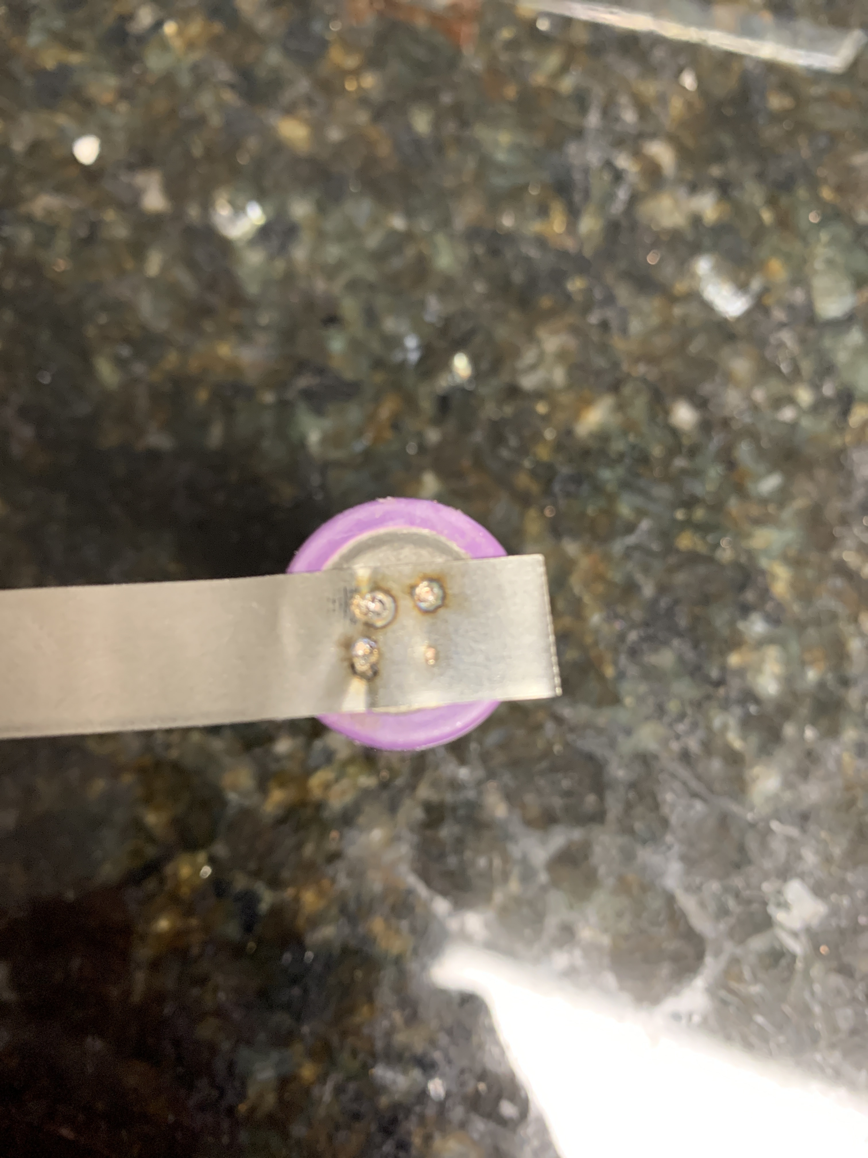

When your welders prongs are too short for your needs…this should be safe right?
I would throw some tape around those or some sort of heat shrink and just leave the tips exposed :sweat_smile: just in case of accidental contact
It’s melting holes in the nickel at the same settings… shouldn’t it need more pulse time/current?
The one side wants to explode
Because the probes are now a larger conductor they are able to carry more current. Maybe dial back the settings a bit
Wait I figured it out, the long probes have way more leverage so they don’t actually have enough pressure and just spark rather than weld…works just fine with a painter stick pushing on it
Is it possible to open it and tighten the springs?
not sure what you mean by open it
Open the welder and get at the springs inside, the knob at the top is broken
Edit: nvm, just stuck some foam in the front and I’m getting these welds, definitely passes the pull test
looks good to me
