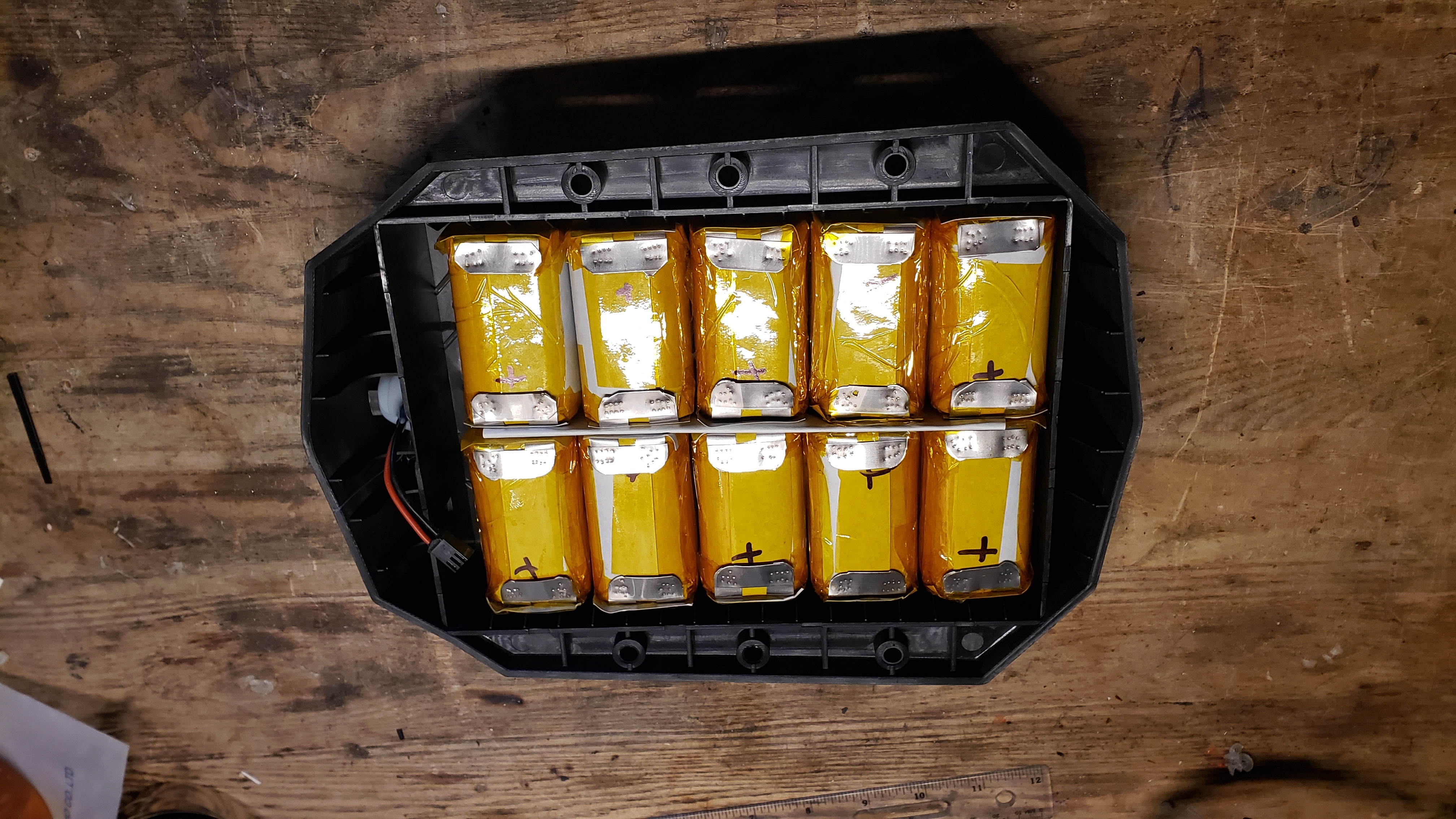

Just note that it makes the balance leads much more complex, where ever the BMS is has to have a wire to every single parallel group plus the main current carriers. You might want to look into either laying down a ribbon cable in the deck to keep it neat. This will negate the splitter as it would be a single battery, just stretched
Alternative you could try using 2 BMSs (8s in the front and 4s in the rear). Note that you can NOT plug both chargers into the same power circuit or it will short out on the ground line in the wall and blow something up. You’ll need the splitter for this, make sure it’s in series not parallel or it will be a bad day

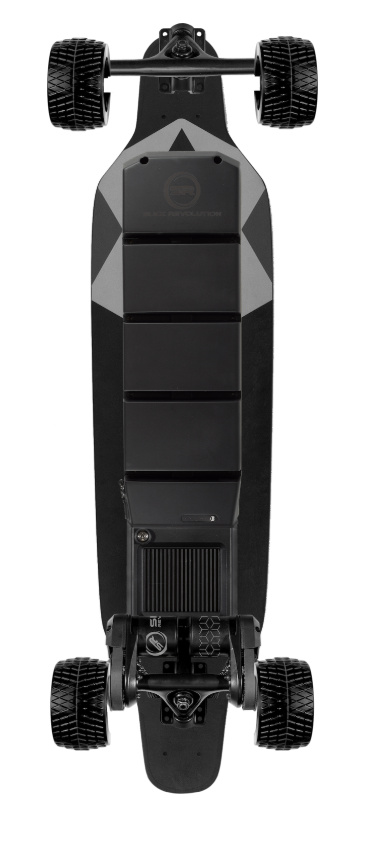

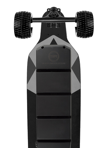

has nobody tried making a full length undertray on a vanguard. I figured someone would have tried that considering the amount of vanguard chinese clones…
I guess the closest thing to that is a slick rev board.
poor execution tho
You can make 2 separate packs, each with their own charger and BMS associated with them, each shrink wrapped and made pretty. Only catch is you must charge them separate. Make sure you use a series connector for the 2 packs and the ESC (or the parallel splitter that goes to both ESCs if it’s a dual motor)
If you charge on the same power grid they will short out over the negative wires of your house and that’s very bad, other than that it’s fine.
You may want to put a removable extender from one enclosure to the other in the deck so the battery does not have exposed leads but can be removed (as shown above)
You’re not making any sense here. If you want 12S and you have an 8S and a 4S pack they would be wired in series to get 12S. You cannot wire two differing voltages in parallel.
If you were to have two separate BMS’s that could potentially work.
