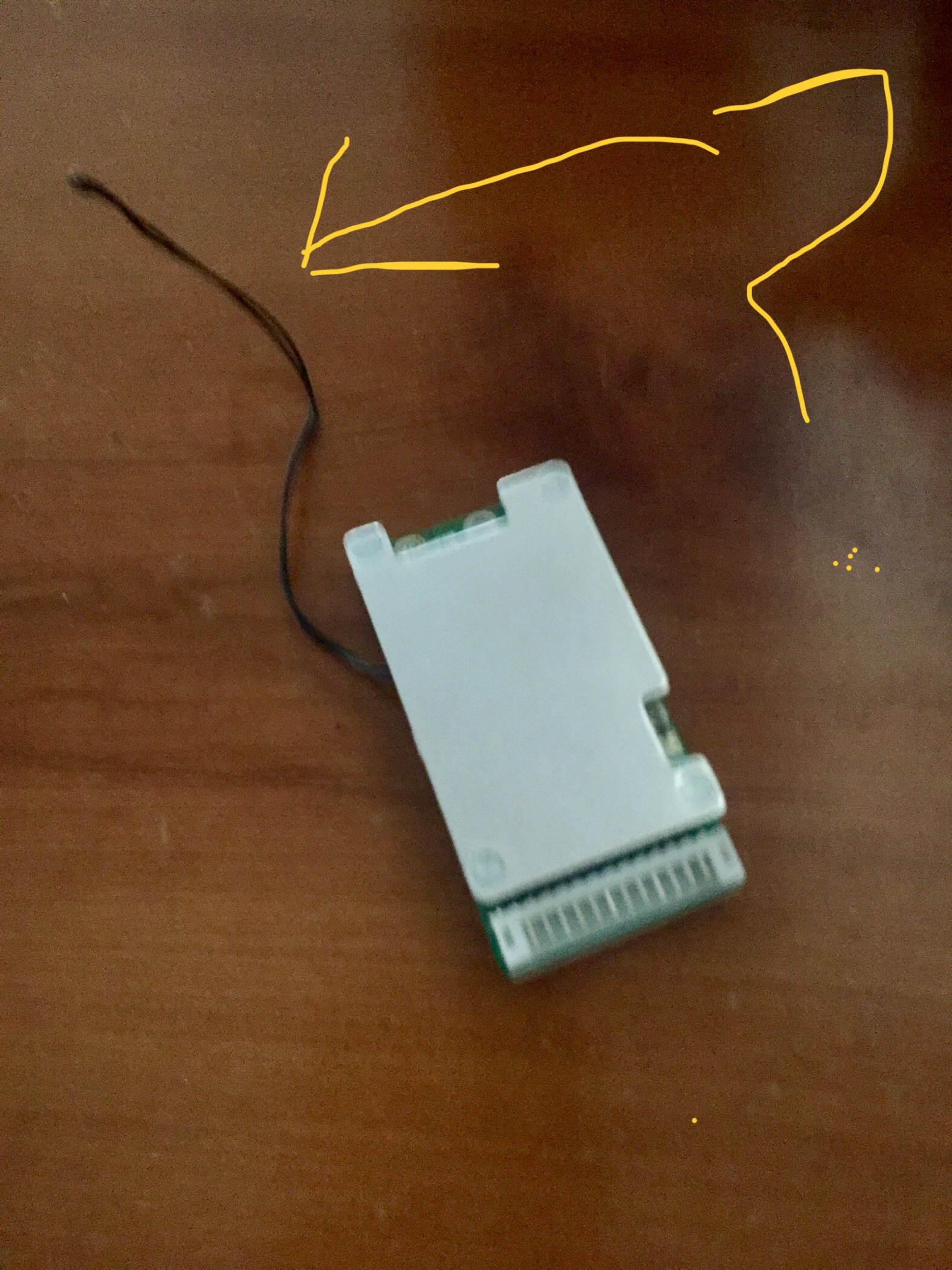

I’m looking for help with some bms questions. The specific unit is this one - https://www.litechpower.com/product-detail/HCX-D503V1LI12S15A_01.html#
In the picture below I’m guessing that’s an antenna of some sort. Can someone confirm? If so that would imply Bluetooth or other connectivity which implies an app or other software interface. But I don’t see any mention of this on the product page. I don’t need or want an app for what I’m doing. Can anyone confirm if I can use this for charge only without any software or app based configuration?
Thanks!
I believe that is a temperature probe, however not certain
Didn’t even consider that but it makes total sense. I’ll investigate that further. Thanks!
It’s a temperature probe.
