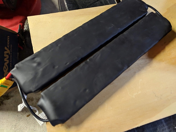

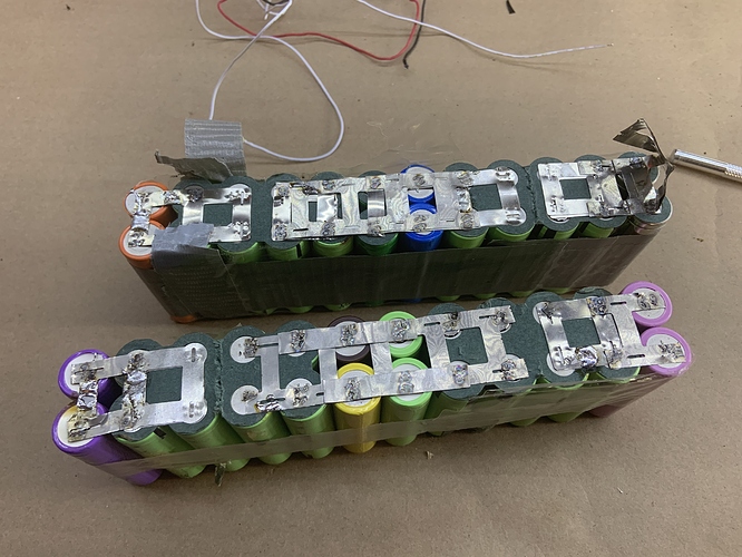

I recently built a 12s3p flexible pack. I am hopping for some honest feed back. :worried: :worried: :worried:
Materials:
Samsung 30Q Cells
0.2mm x 8mm Nickel Strips
12awg wires
Bestech D-223 Balance Wires
3p 18650 PCBs
1/4" Tinned Copper Braid
Looks perfect, except…
You forgot the fispaper between the p-gropus! A little bit of vibrations back and fort and the negatively charged outside cell casings of the adjacent p-groups will short and could cause a thermal runaway.
If you have some more heat-shrink left, you just have to remove the one you put on, wrap the bottoms and sides of the groups with fish paper, and then reseal. Other than that, you’re Gucci! :slight_smile:
As well as @rusins suggestion I would also suggest insulation on the cell terminals. Shrink wrap doesn’t provide much abrasion resistance, neither does kapton tape.
Doh! Forgot about that. I guess I assumed it was for a Haya or something :laughing:
When you are talking about insulation on the cell terminals do you mean the insulation between the two halves of the pack?
Yeah bro
The heat shrink I used is polyoelfin not PVC and it is fairly thick so I thought it would be enough.
I wouldn’t rely on it, especially in a flex pack
