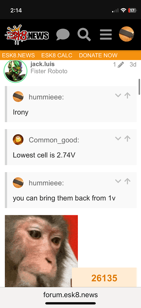

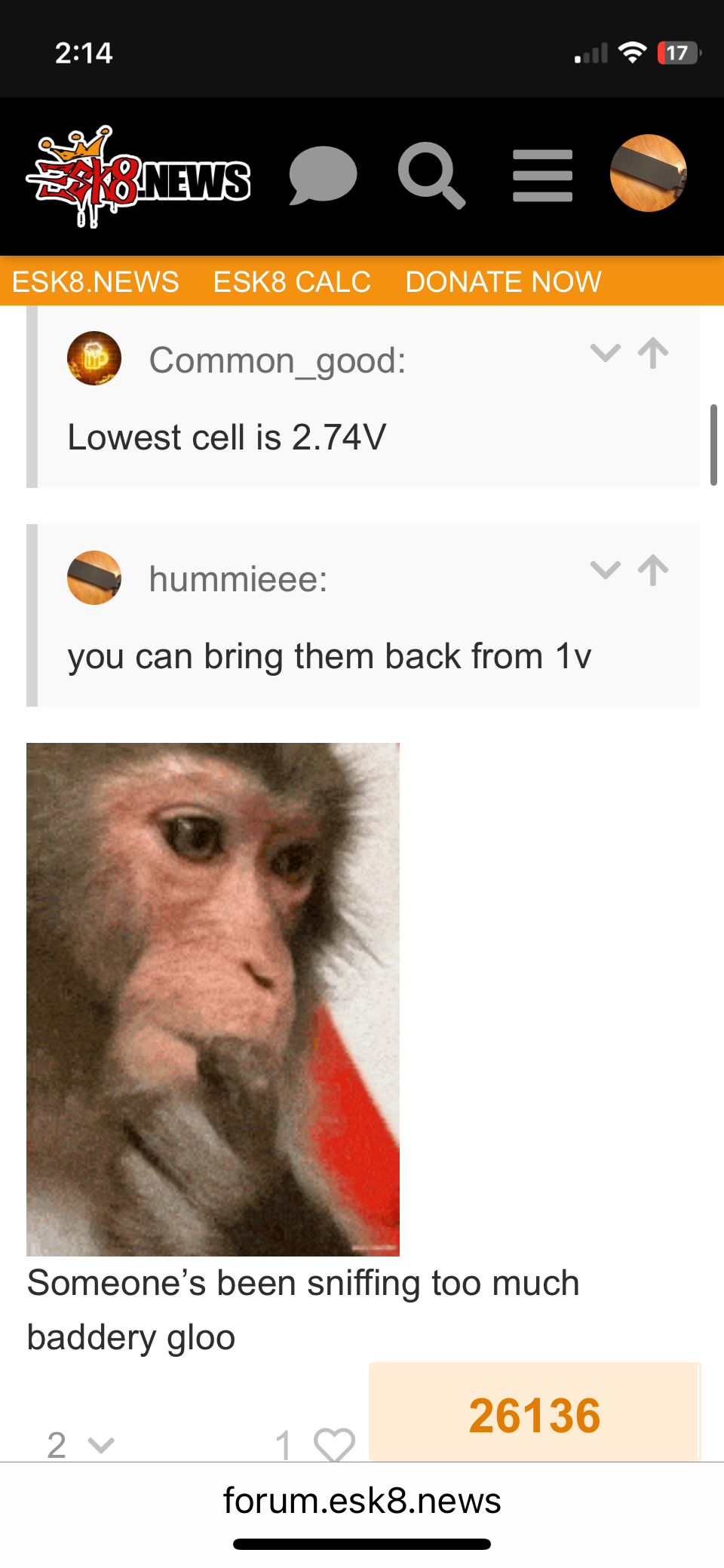

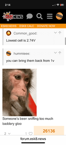

Again for you. Here’s the only mention of bringing cells from 1v. It’s a quote you posted of mine from years ago
Lmao this is showing you saying “irony” or whatever passive aggressive comment before anything else
The irony as u all rage again that I said you can bring cells back from 1v. You can! It’s in many data sheets. I think every Samsung I’ve seen. Also Sony and Sanyo and Panasonic all have cells with data sheets saying so
Watch u folks rage that somehow I’m wrong or dangerous again anyway. And I didn’t even bring it up am an responding to insults and others starting
So you are admitting you’re the one who brought it up again first? 3 days of extra blood pressure and you getting all mad and you don’t want to admit that you started it and did this to yourself :rofl:
Again for u for the third time:
It’s ironic someone is asking about charging low voltage cells who before was one of those raging it’s too dangerous. That’s irony. That’s not me being insulting. YOU posted the CORRECT statement actually that u can while trying to insult me. If u can’t see the irony… oo well
Funny indeed. Me saying the word irony did it. Sure. And u quoting me stating u can recharge from 1v from literally years ago while mocking… you were just responding to the word irony. Got it.

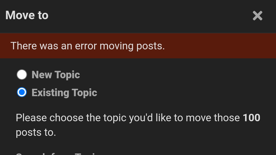

@xsynatic are you able to move posts still? Like everything from this post down gets moved to the bin?
Ay you finally admitted it. Yeah @xsynatic bin this please it’s covered in pigeon shit
Fix your shit Damon!!!

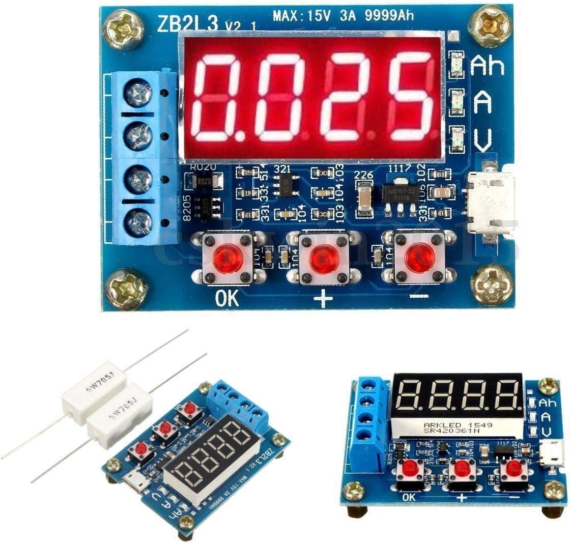

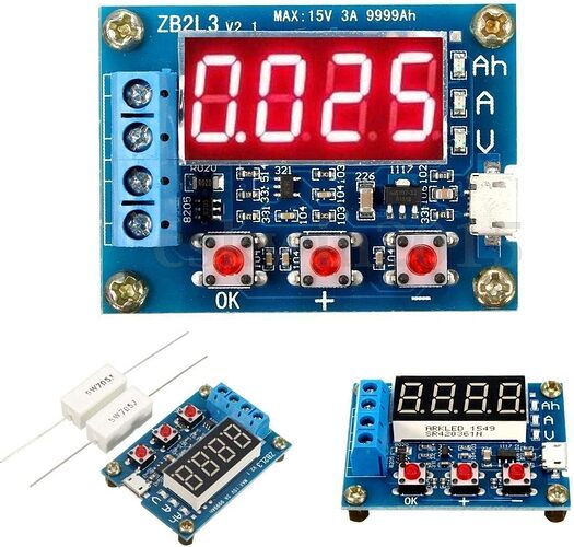

do a capacity test.
That thing looks like fun but no way will it handle the voltage. No reference discharge to compare it to either as it going to introduce its own variables. Might be fun to just take a cell and keep it on a smart charger for a couple years and compare it to a properly stored one but i haven’t got time for that :laughing: still need to follow through on spec sheet wiki

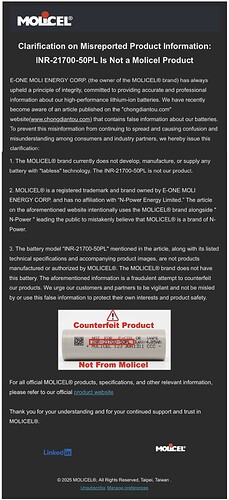

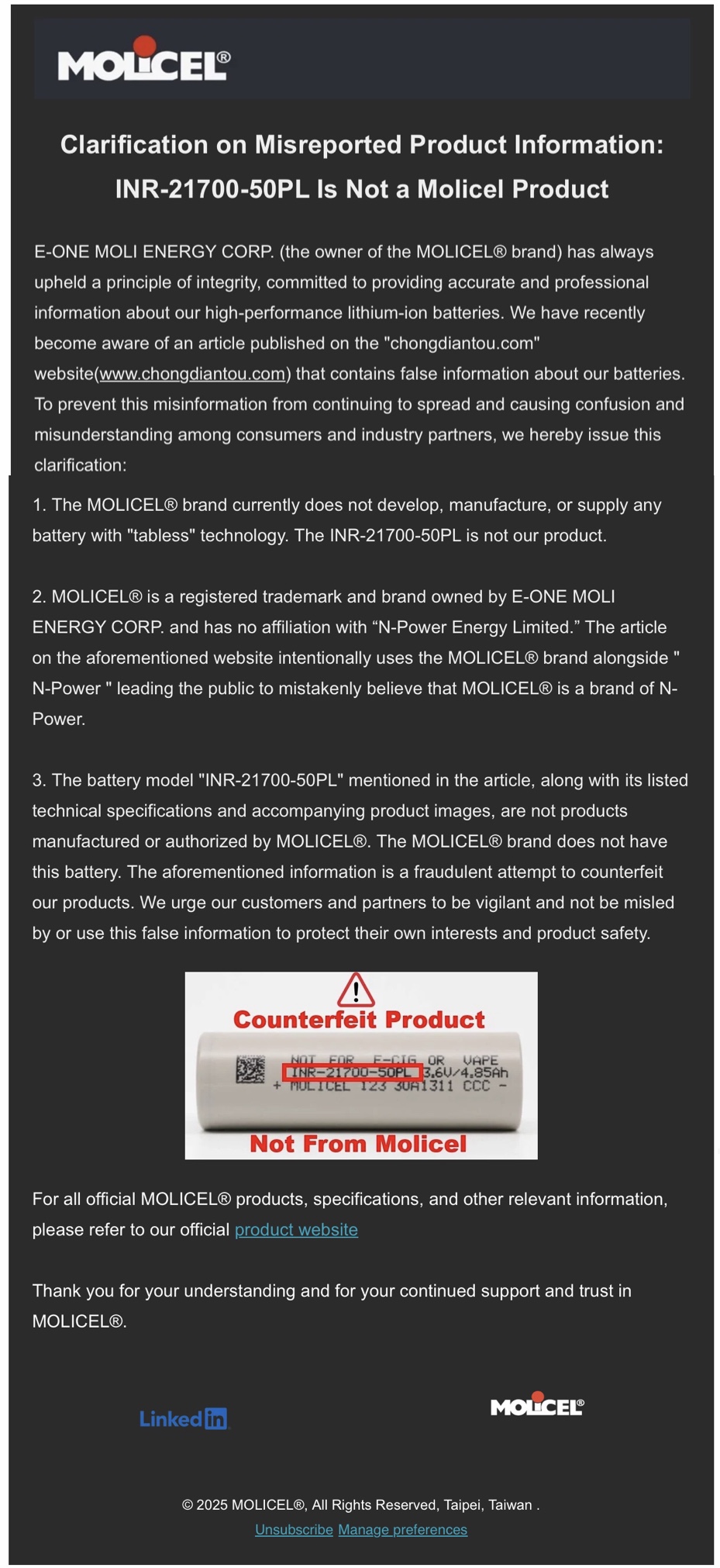

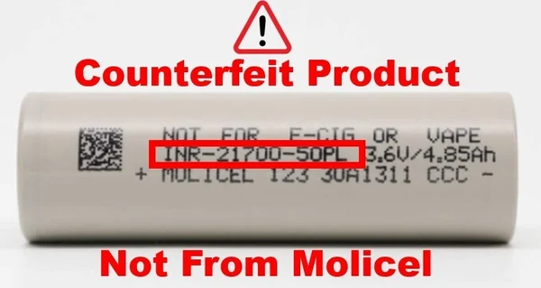

I hope y’all would instantly realize this if you saw this cell for sale but just in case, this is a fake. Moli does not make an “INR-21700-50PL. Check www.molicel.com for more info.
