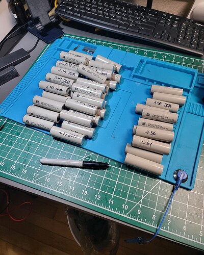

I would, yeah. Some may tell you that it’s possible to recharge them. But personally I would never feel comfortable with those cells again after they have spent such a long time at such a low charge.
Thx. I guess it is time to call the time of death on January 27th, 2025, 2200 hours
Is it safe to use these cells for nickle weld pull testing?
Absolutely, this is how i got my test cells. Try not to pop the cans as that electrolyte is nasty still. I hit them a few times testing and then scrap em. I started a little notebook with settings so i need fewer and fewer test cells but always have a couple around
Excellent idea. Thx
They were probably okay but it’s usually just not worth taking the risk. The datasheet doesn’t mention any voltage below 2.5V, even for over-discharge recovery.
Half of those groups are still at or very near to 2.5 V, so they should be fine, right? Maybe I’m just overly lax, but three groups (3, 9, 11) are perfectly fine, three (4, 7, 10) are so close to 2.5 V that I’d have absolutely no issues using them again, four (5, 6, 8, 12) are in the category of questionable where I wouldn’t tell someone else to use them, but I probably would, and only two (1, 2) really concern me.
Am I wrong that there is absolutely no issue with a cell resting at its minimum voltage for an extended period? I’ve seen several papers that show that is actually where batteries degrade the least when stored, as long as they don’t go under. Also, I have a hard time imagining that sitting at 2.5 V for 2 years is fine, but being at 4.475 (EDIT: this was a typo as clarified below, but I don’t want anyone to think 4.475 V may be a reasonable cell voltage. I meant 2.475 V) a for a few months trashes the cell, but I could be wrong on that one. I’d imagine that, given these probably saw a constant draw, they haven’t been below 2.5 V for long.
Edit: Also, I’d argue, since the specs sheet says “2.5 V” for the minimum, that 2.45 V is still in spec. If they meant it shouldn’t hit 2.49 V, then they should have written 2.50 V minimum, and that is a first year of college mistake.
I think I’ll use the ones that are at 2.5V and above for small projects, I’m not feeling lucky with the rest. I’ll take the L for this one :disappointed_relieved:
You’d have to bring the cell back up to 2.50V frequently though.
4.475V is incredibly abusive and the cell could be ruined by that. Higher voltages speed up the parasitic reactions that damage the cell. Going over 4.250V really starts speeding things up.
Technically you’re correct. But the trailing zero, or zeros, are often omitted for clarity and are just assumed.
Whoops, that was a typo on my part. I meant 2.475 V.
Also, as far as
I wouldn’t get pedantic about this in more casual communications, but to me, if you’re writing a technical document, as the datasheets for these cells are, you should absolutely not be shortening things like that. If you mean it should not reach 2.49 V, your datasheet should unambiguously make that clear. If your datasheet is written in a way that can reasonably be interpreted to mean 2.45 V is okay, and someone has an issue because of that, that is on the author of the datasheet in my book.
I’m not actually sure what the right interpretation is, which is concerning to me, TBH. As I intended to say, I wouldn’t think 2.475 V for a bit would be a huge issue, but I haven’t read a lot about what happens when cells are slightly over-discharged. If they do mean it shouldn’t ever drop below 2.500 V, it is quite an issue in my opinion to write 2.5 V with no trailing zeros in a technical document.
2.475V resting voltage is technically more abusive and causes more damage than 2.500V. But it’s probably not so in any meaningful way that would be noticed or perhaps even reliably detected.
IMO it would be chemistry dependent. Even cell dependent.
It’s a cycle life issue so there’s no real hard limit. Some datasheets discuss recovery from even “1V” over-discharge and others mention to never let the cell drop below “2.0V” or otherwise performance cannot be guaranteed.
So the low voltage spec, to whatever precision it’s brought to, is really more of a spec to not go below if the spec’d cycle life is desired.
But to make things complicated, some cells have their anode current collectors start to dissolve as you drop below the low volt spec. The lower you go and the longer you are there the worse the damage is.

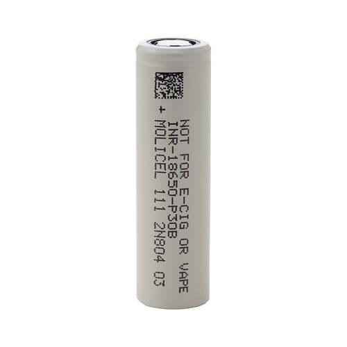

Hey guys, hope you dont mind me asking -
I’m trying to hot rod some batteries for my Milwaukee M12 2563 impact wrench, as it seems to like having more juice available, but fuck paying 80 bucks for the OEM milwaukee 5.0 HO batteries.
I’ve found some kits for the casing, PCB and nickel tabs, and I’m probably going to buy some Molicel P30B cells to use in them. However, i have no clue what spotwelder setup i should get. Given that this is a pretty simple project, im not looking to spend too much. Will probably just use the spotwelder for this and other small projects, I’ll leave the full esk8 batteries to my regular builder :sweat_smile:Any recommendations on that, or in general for the project and/or any other tools/materials i should buy? Also will gladly take input on if theres any other cells worth considering haha. Unfortunately, im stuck with 18650’s so no fancy 21700 fun stuff.
Battery case, pcb, tabs
https://a.aliexpress.com/_mKF2Pzt
P30B cells
I currently have the community spotwelder, it would be €35.5 to ship to the states.
But I have some more cells arriving next week though so if I could keep it 7-8 more days it would be great sorry.
