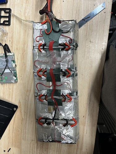

So one of my first boards was a meepo awd with the v3 hubs and first thing i did to it was make a new bigger battery. Was one of the first batteries i made that was half good enough to last but i quickly grew out of it and gave up on hubs being a daily driver in my area.
Bla bla bla was a loaner for a bit but then it’s been sitting half disassembled on a shelf for a couple years now. I check the battery every so often and it just sits at 3.6v a cell happy to retire in place but I’ve gotten bored, so let’s see what i can fuck up.
The battery i made back then was some kinda halfway between a chocolate bar and a flexible flat pack 10s6p and the first p42a battery i made. It was ok but i made it before i found this place and learned so much here that it’s got some flaws.
Also wanted to top box it and see if i can’t get a little life out of that board again and also im bored waiting on the weather to warm up so i can frit my other deck. @glyphiks had some good points about converting a flat pack to a brick so here is the horror show. My use of fish paper rings was spotty when i first made this and im not going to tear off to redo the welds - this is just a junky salvage operation. I did cram some isolation in where i could.
So i found some old photos of when i was making this guy, it was just strapped to the bottom of the board for so long it was no longer a temporary solution. At one point i covered it in diamond plate aluminum, at another i sealed it up in neoprene. Mistakes were made but my heart was in the right place.
So i cut the neoprene off it (not pictured) and here’s what i had, i had painted some liquid electrical tape on the solder joints. :face_vomiting:
Also found a lot of dirt had gotten into it from a trip to the desert and generally riding this like I stole it.
Spent a ton of time meticulously cleaning and inspecting everything and it all seemed good so I applied a generous supply of Al tech fold and solder techniques learned from a hobo who lives in a van down by the river and came up with this:
That’ll do pig, that’ll do
van-river
Many such cases

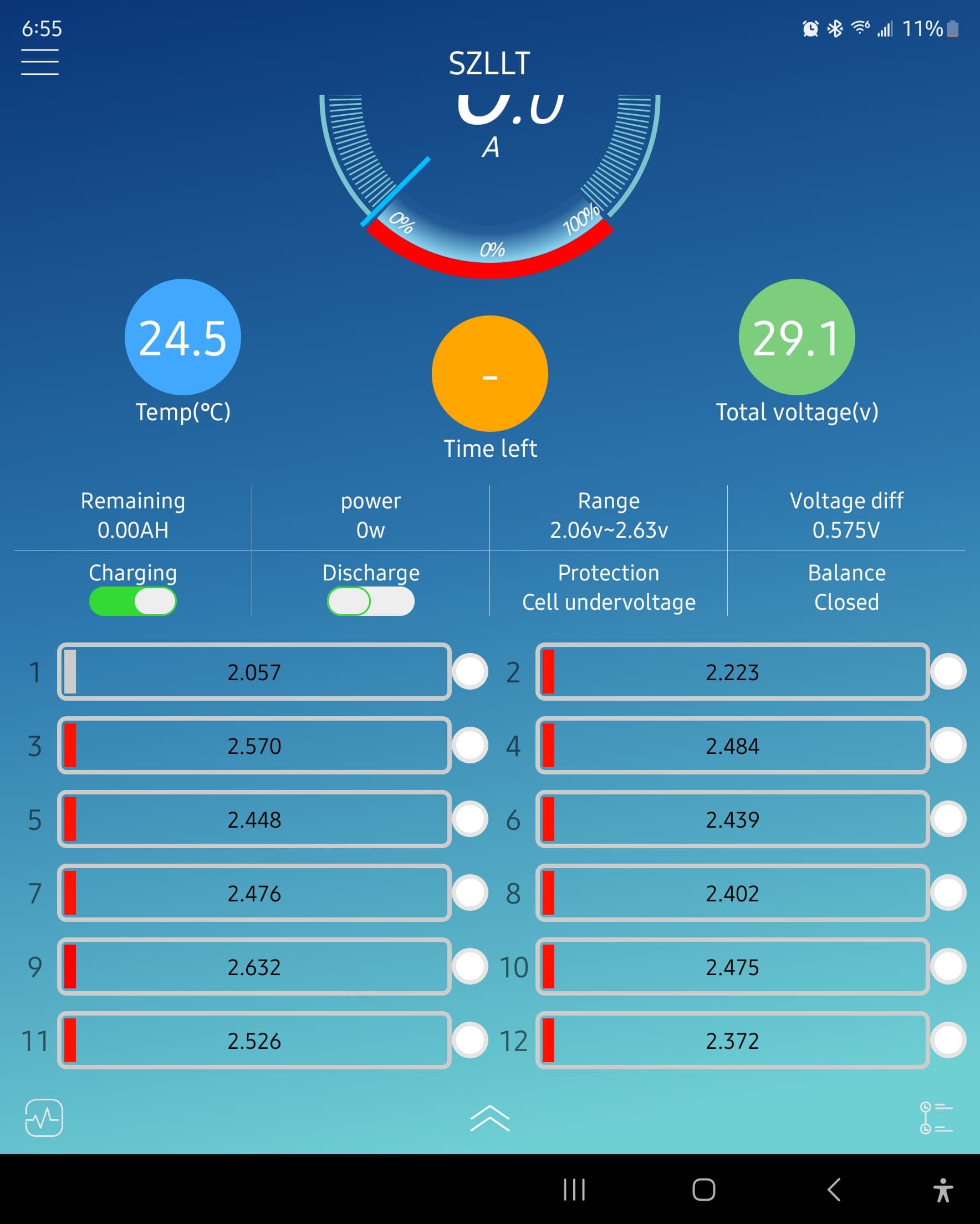

Damn!! These were new batteries I left in battery modules connected to a BMS for about 1.5 - 2.0 years. What a waste. Should I dismantle this pack and dispose of these cells?
What cells are they?
Molicel P42A they were stored at around 3.5V
