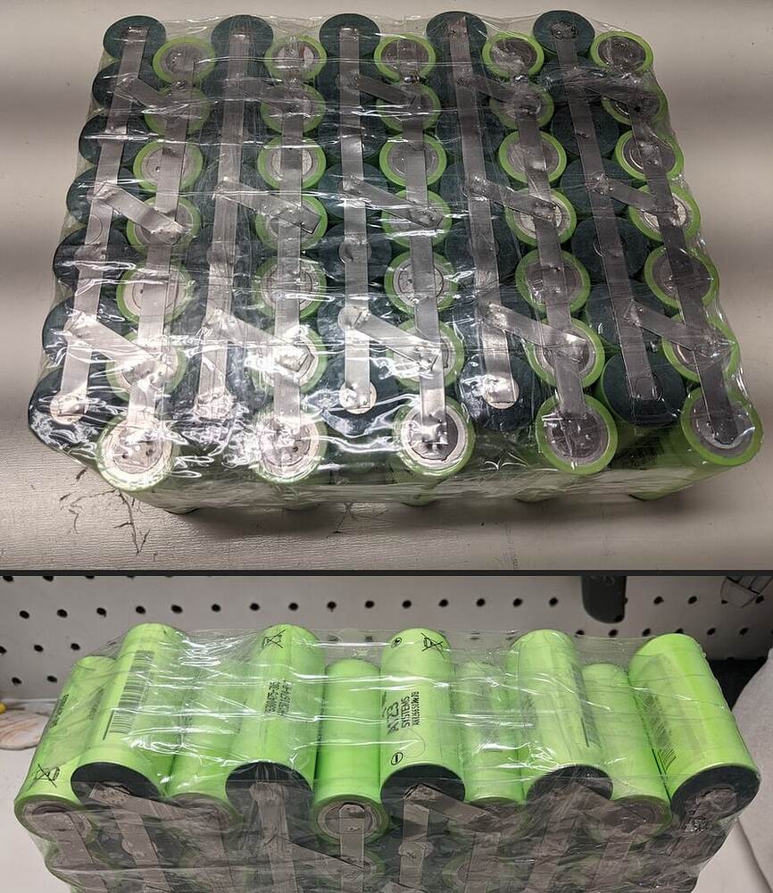

What’s wrong with the battery? @xsynatic
You can’t say? Why bother posting all those pics if u can’t explain what supposedly is wrong?
Can anyone say? There’s no fishpaper between groups. Yes. Anything else?

I wouldn’t use packing tape, you can still get a short thru it. Maybe if there was a case it was in then It wouldn’t throw red flags in my head.
You said it yourself no fish paper, There should be fish paper.

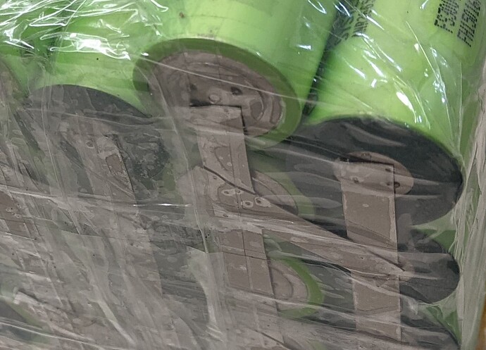

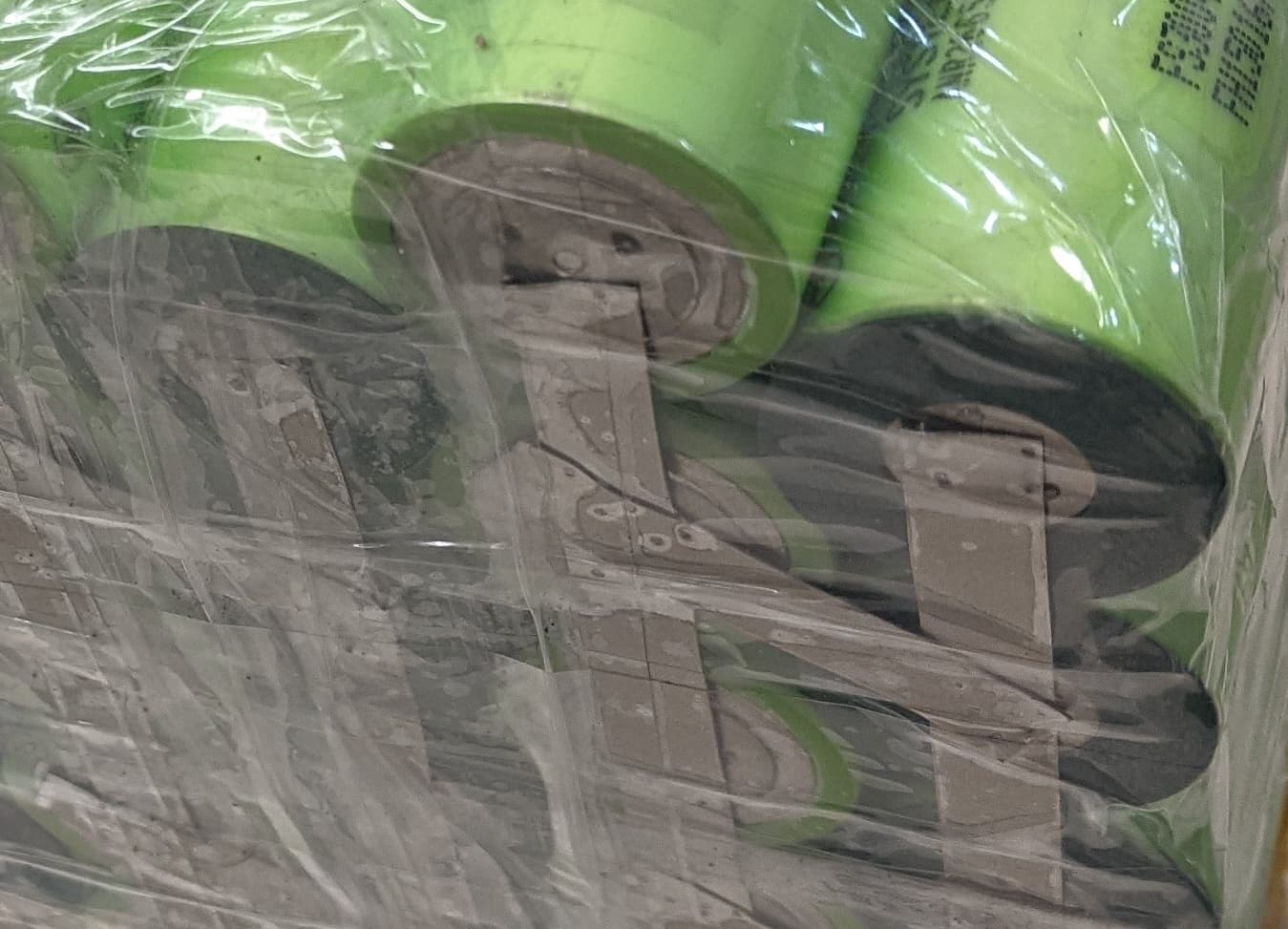

Some of the solder joints look to be not attached very well as in they aren’t using all of the surface area on the cell.
Uppermost cell in this photo
Like yeah I would agree its a battery and it will work, ive built worse looking batteries, but ive also had a couple catch fire (seems like youre the same there)
If it were me would pull that pack apart and redo it. But we are all different.
My head is screaming no, that is not a good idea,
But yours might not be which is fine everyone has differing opinions

You can cut through aramid tape pretty easily too though. I didn’t sell it with a case. It was sold as is and if had a problem with it they could’ve come to me.
Ive had the same people post this same battery for maybe years now. It needed fishpaper. The soldering looks fine and not being beautiful doesn’t make it dangerous. There’s nothing more they’ve said about it in the past and they’re not saying anything at all now. They bring it up out of nowhere whenever.
