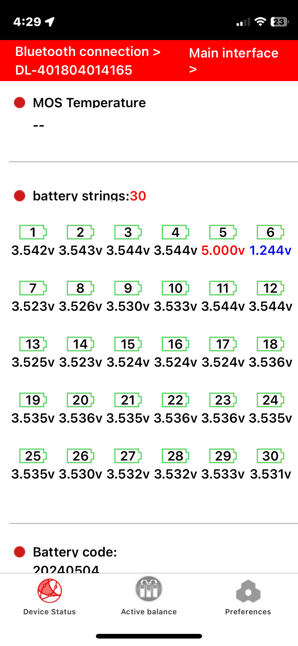

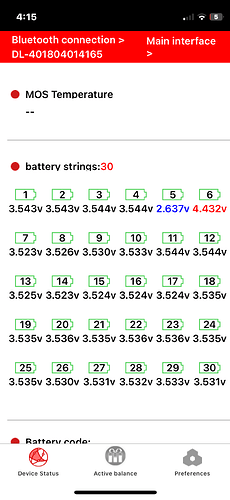

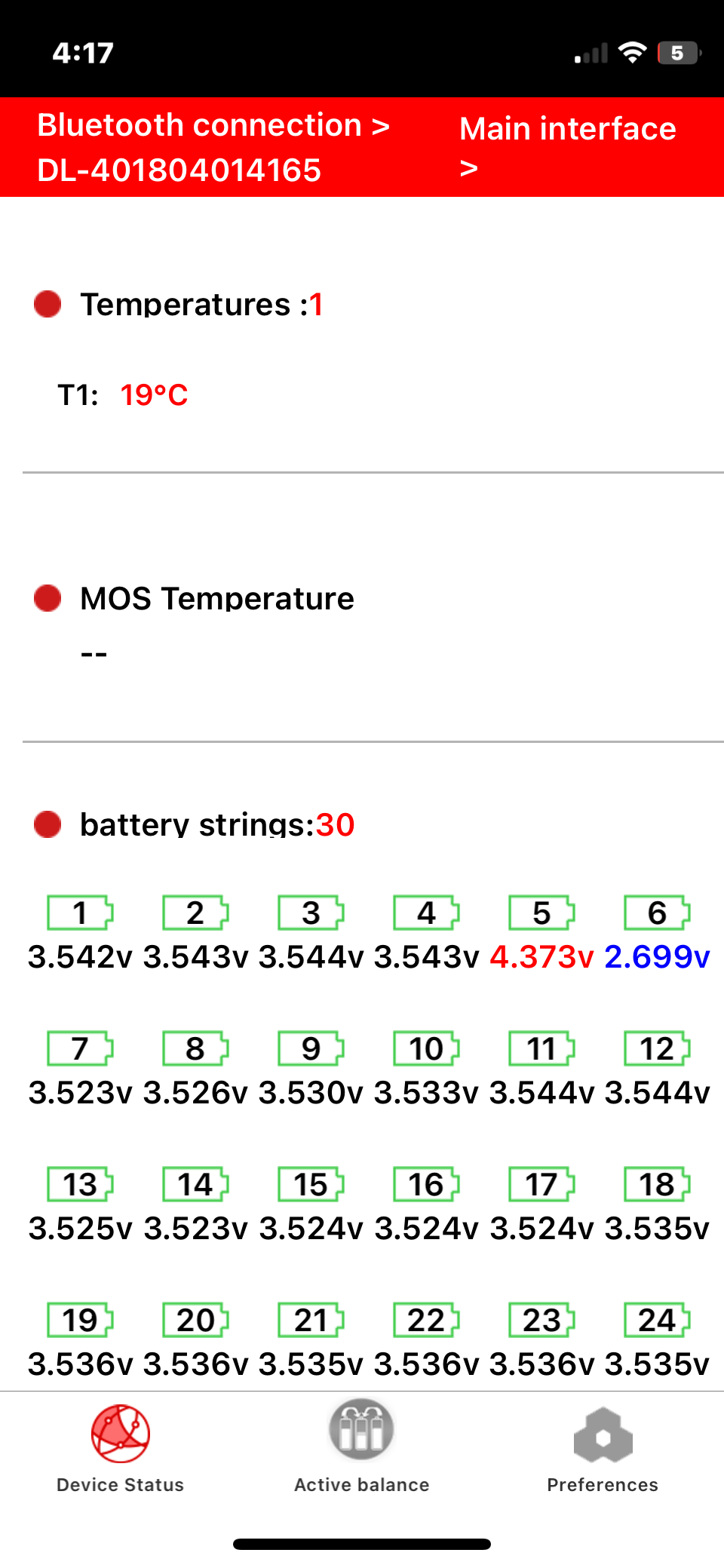

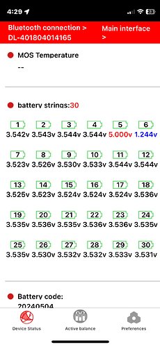

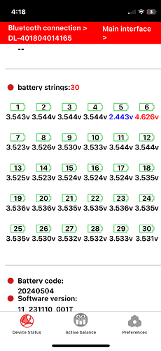

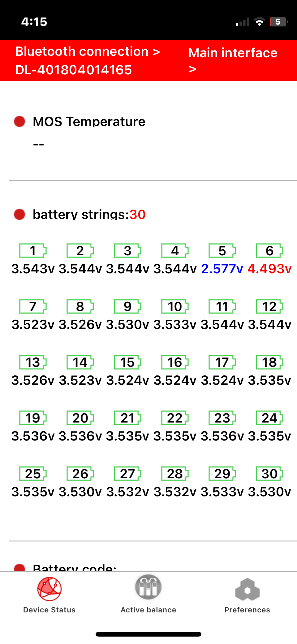

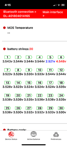

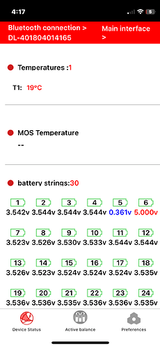

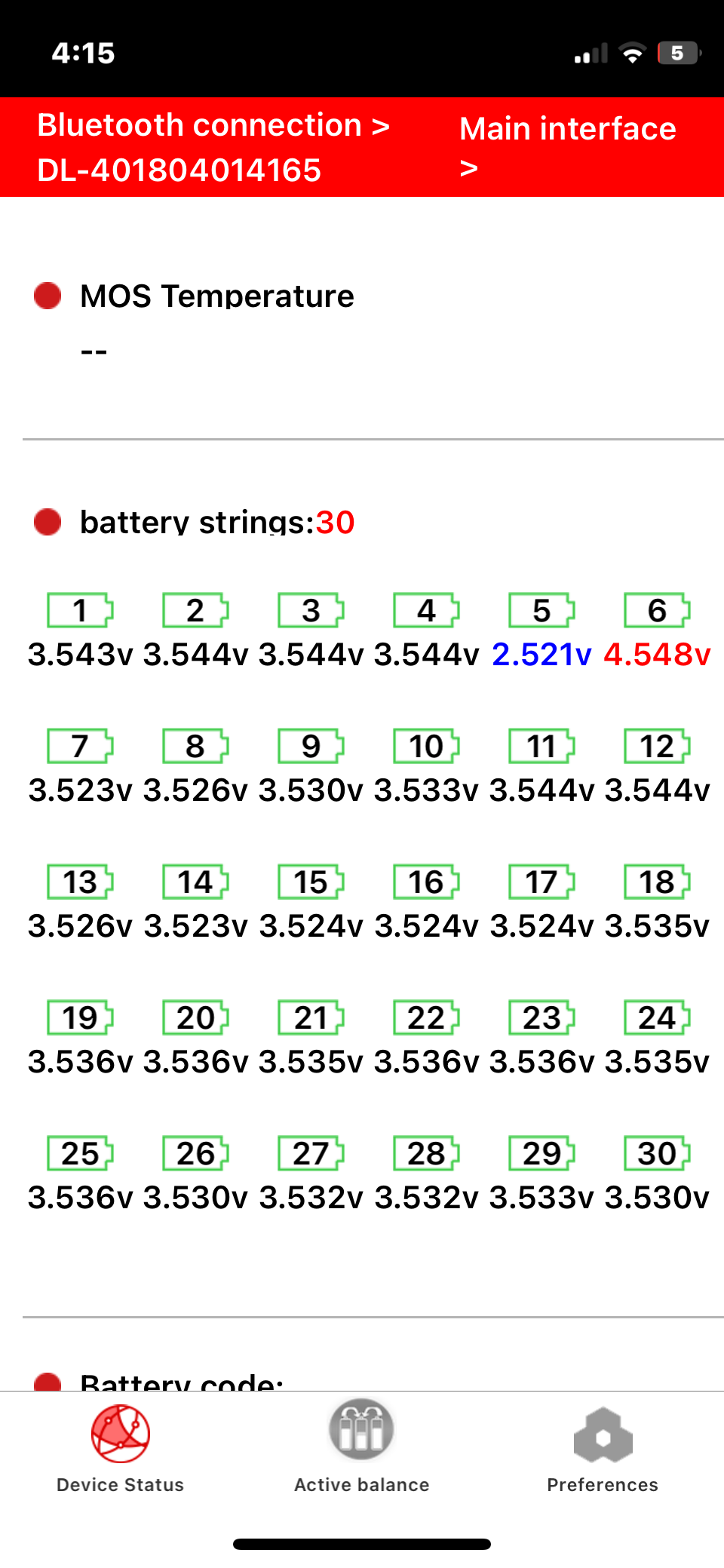

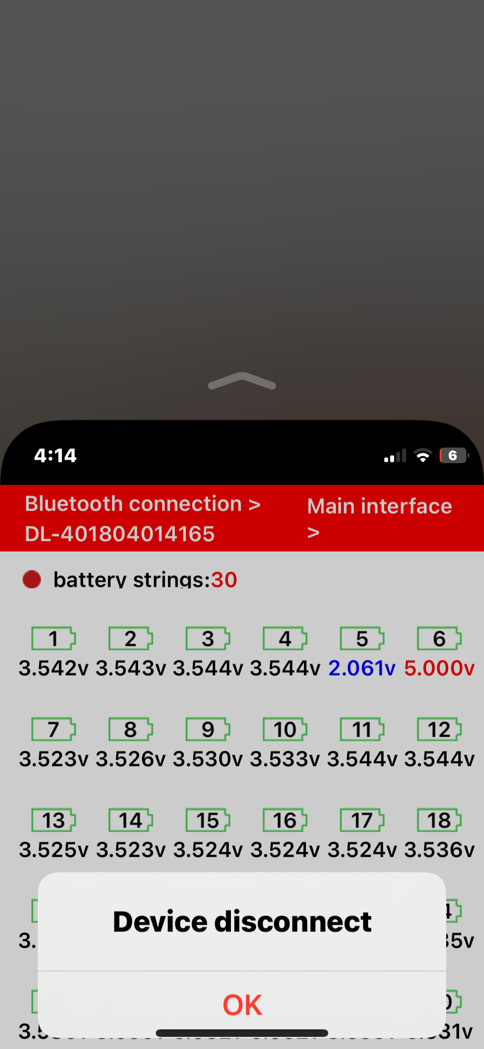

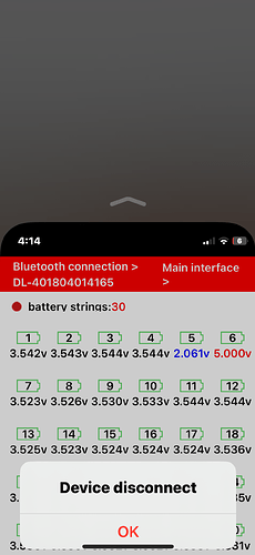

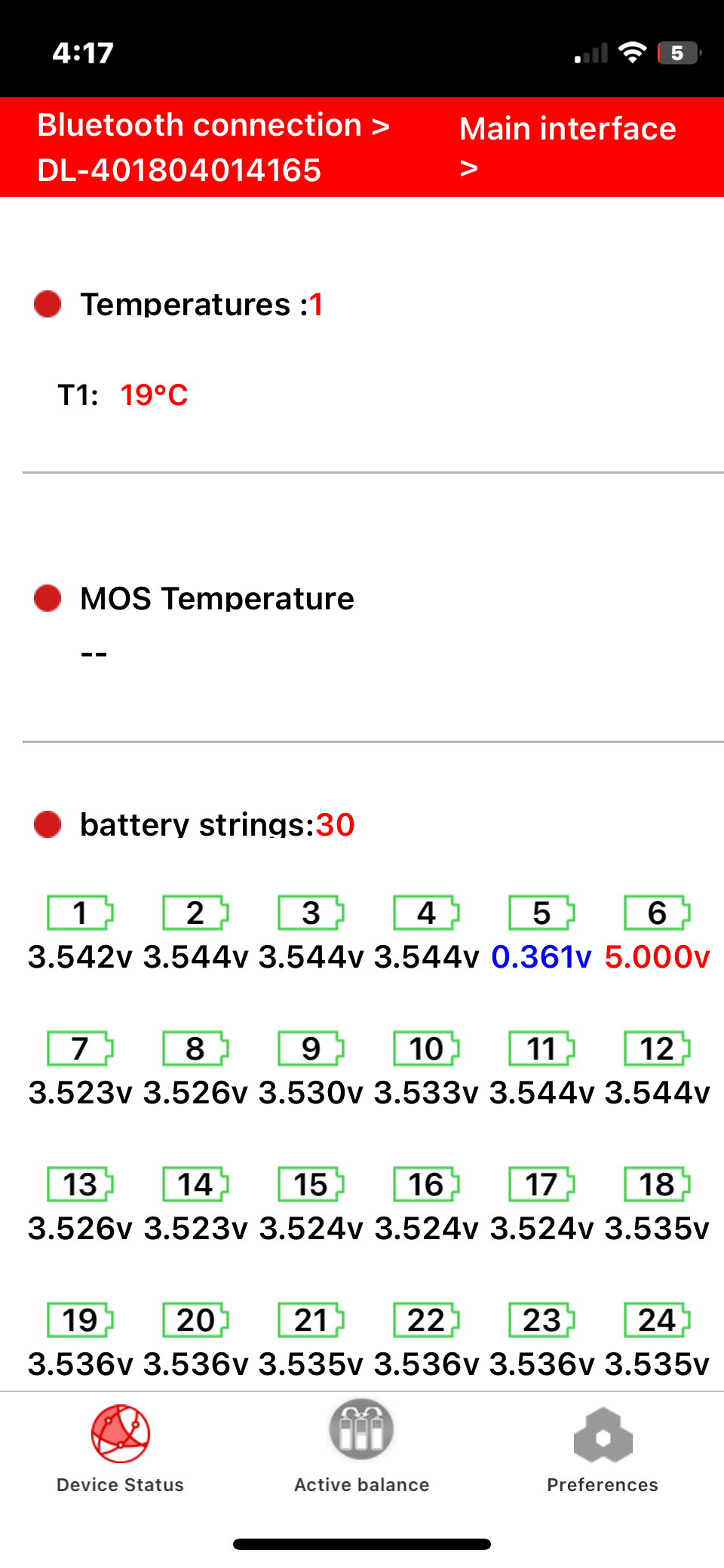

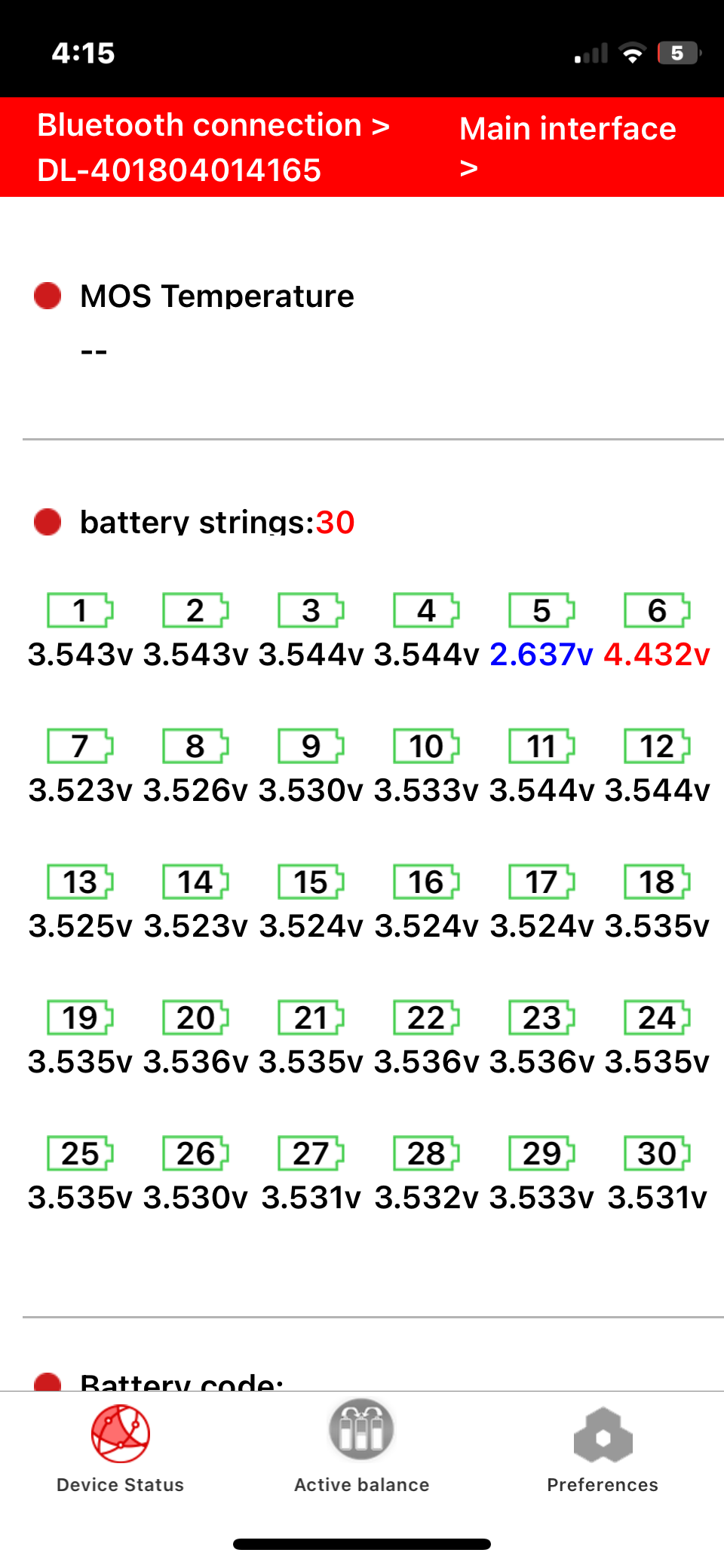

I’ve now got my own similar problem with crazy voltages too. All voltages read good with multimeter but when I look at them through the bms I get wild fluctuations with two groups. I’ve plugged and unplugged numerous times and out of ideas.

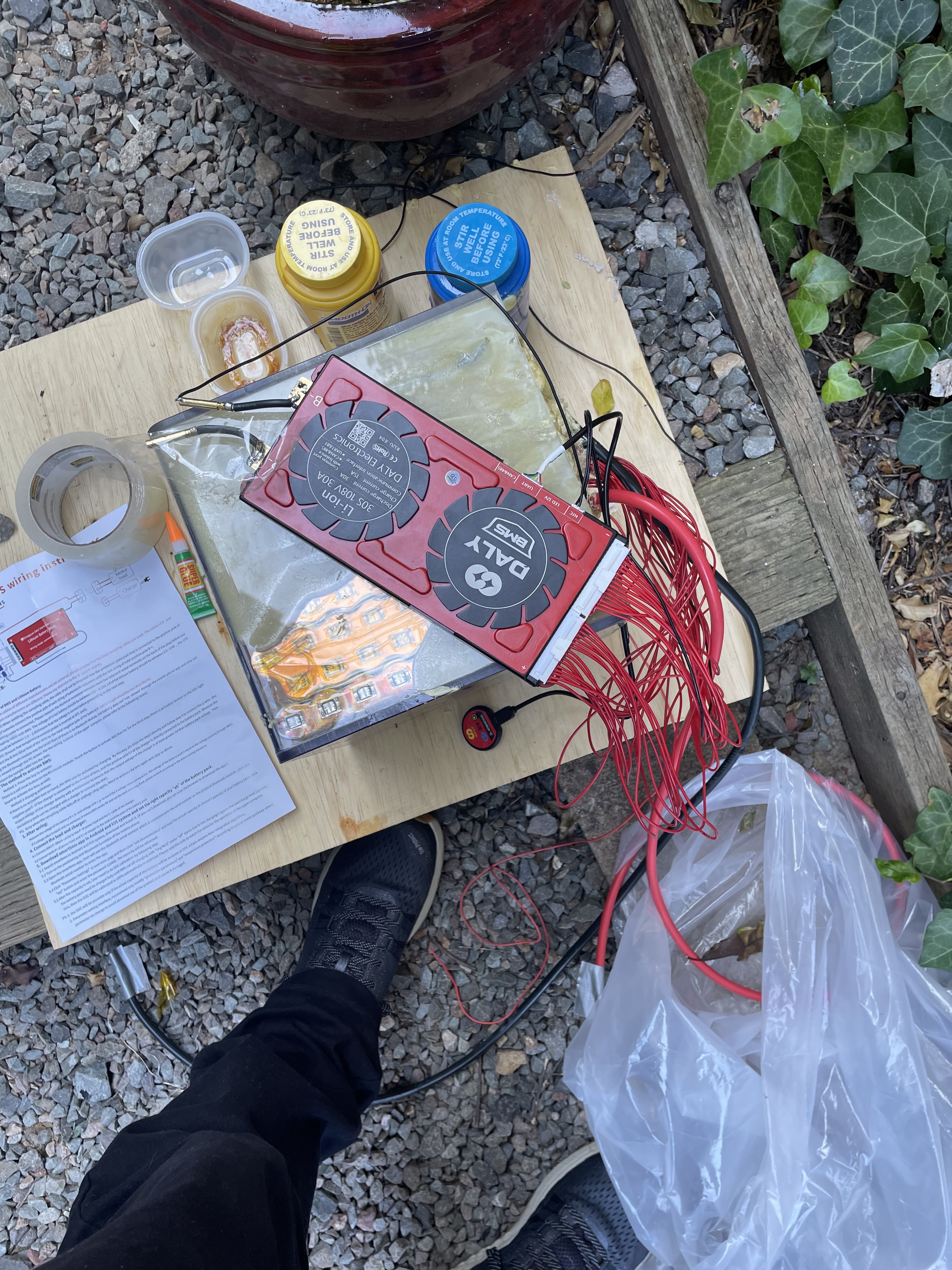

As it is now the bms is only connected by the balance wires and B- but that should be fine.
I’ve got a lot more pics of it doing the same:
I think the bms is faulty. I can imagine no other reason this would happen.
That looks exactly like a bad balance connection - probably at the cell. The bms is trying to read the cell voltage without the proper reference between those two groups - the total voltage of the two groups is still correct. Test at the header manually
spit-take-drink
My multimeter shows those two cell voltages fine when checking at the balance plug.

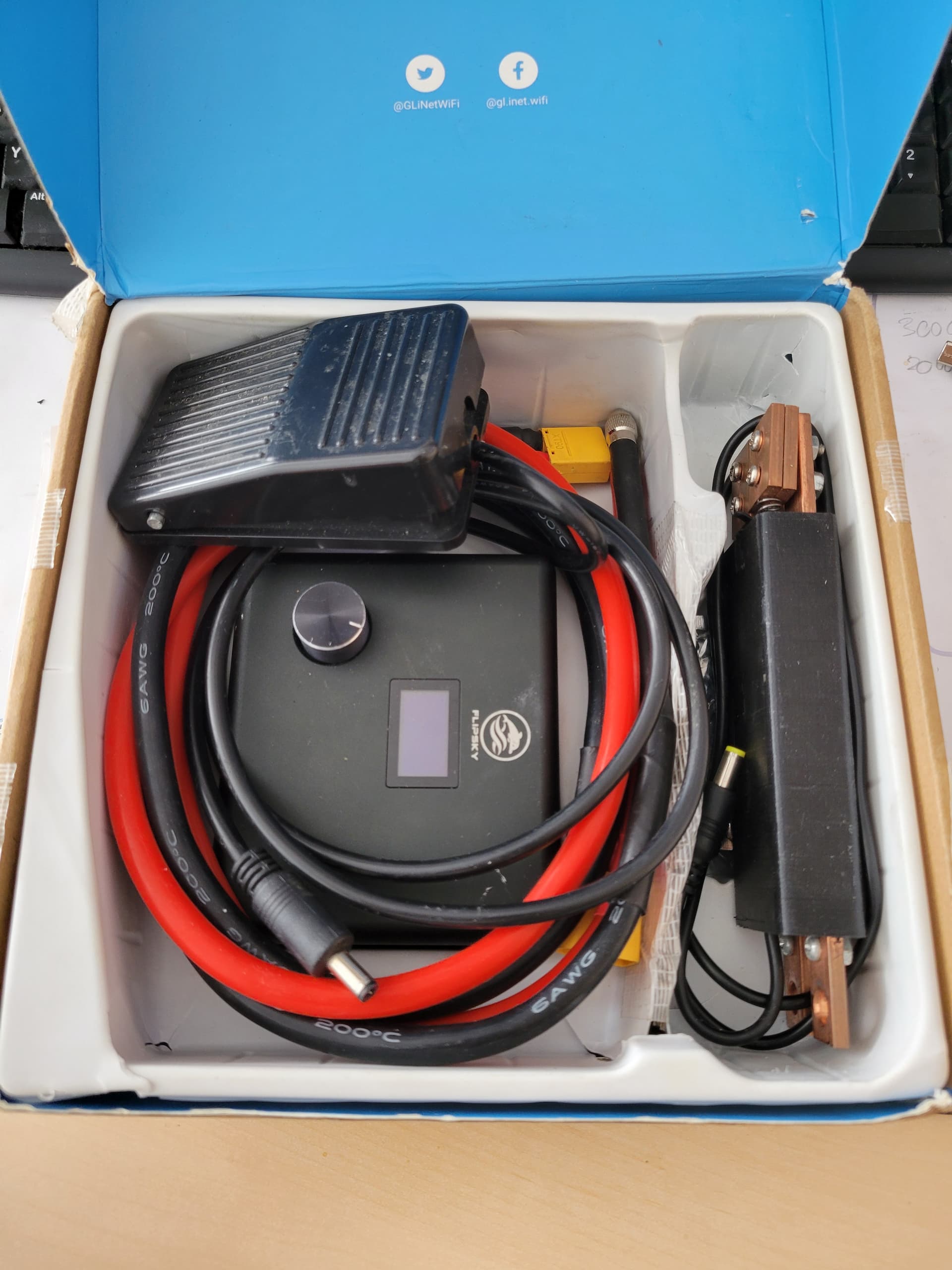

Hi, I have got my hands on a spot welder with some not so pristine electrodes.
What is the best way to get them in shape? And what is the best shape for spot welding? I’m imagining a cone shape whit a blunt tip. Like so:

. My critical thinking tells me that since the multimeter shows the voltages just fine, the bms must be faulty. What do ur great critical thinking skills tell u? What you consider “help” is nothing I haven’t obviously already tried. You really think checking the voltages at the header is something hard to figure? Nothing else u can think of? Any of the geniuses here?

Not possible easily.
Sand/grind them. Make them pointy.
Easy fix, chuck them up in a drill or lathe and use a file to rough out a pencil ish profile. Then smooth it out with some 120 then 220 then 400grit sandpaper. I don’t think anything finer will do any benefit.
As far as the tip i prefer a rounded tip diameter of about 2-3mm. Anything sharper or duller doesn’t work for me and my methods.

I agree with all this, except the progressive sanding. Copper is soft enough that I can just rough the shape out with a file or 80grit sandpaper, then jump immediately to 400grit to smooth it. Not that your way is bad though!

if you had a second bms unit to plug in maybe you could see if the values change? i dont know how affordable they are
I don’t have an extra $150 30s bms.
I do have lots of lesser voltage bms and wonder if I could skip a bunch of sense wires and use a 20s bms and also skip the B- wire.
Considering I can get stable voltages every time with the multimeter on the plug I still can’t imagine any other possibilities other than a bum bms. I repeatedly asked those who allude to other possibilities but they avoid answering.
I have a dumb 10s 20 amp Daly, and wanted to check balance on my battery.
I have 2 of these inexpensive ‘capacity controllers’, that accept 2.54mm JST plugs, and the daly uses 2.0mm, so I got the components to make an adapter.
I had noticed on some 3s batteries, that some cell voltage readings would jump up and down by 0.015, and wiggling the connector would influence the behavior.
I applied some Caig Deoxit d5 to the pins and that behavior was reduced to a 1mv flicker and wiggling connector no longer had any effect
When I plugged my two controllers into my 2.54 to 2.0 adapter, on my 10s battery balance connector, the same behavior occurred. Jumping voltage on some cells, influenced by connector wiggling.
Deoxit D5 pins and sockets resolved it, again.
Granted this cell disparity was far less than your wonky readings, but less than perfect connector conductive mating surfaces seem to cause all sorts of weird issues that seem to defy logic.
Caig has some products like gold and shield for maintaining good clean connections, while the D series is more about cleaning compromised ones.
They have some kits with multiple products within and different ways to apply them.
I think my initial response was very clear, but in case it wasn’t:
You build your batteries like shit. You have been doing this for a very long time. Many people have wasted hours of their life trying to educate you on why your batteries are built like shit. You steadfastly refuse to learn or change.
So it’s extremely funny to me when your shitty batteries start to fail, and you conclude “I think the bms is faulty. I can imagine no other reason this would happen.”
