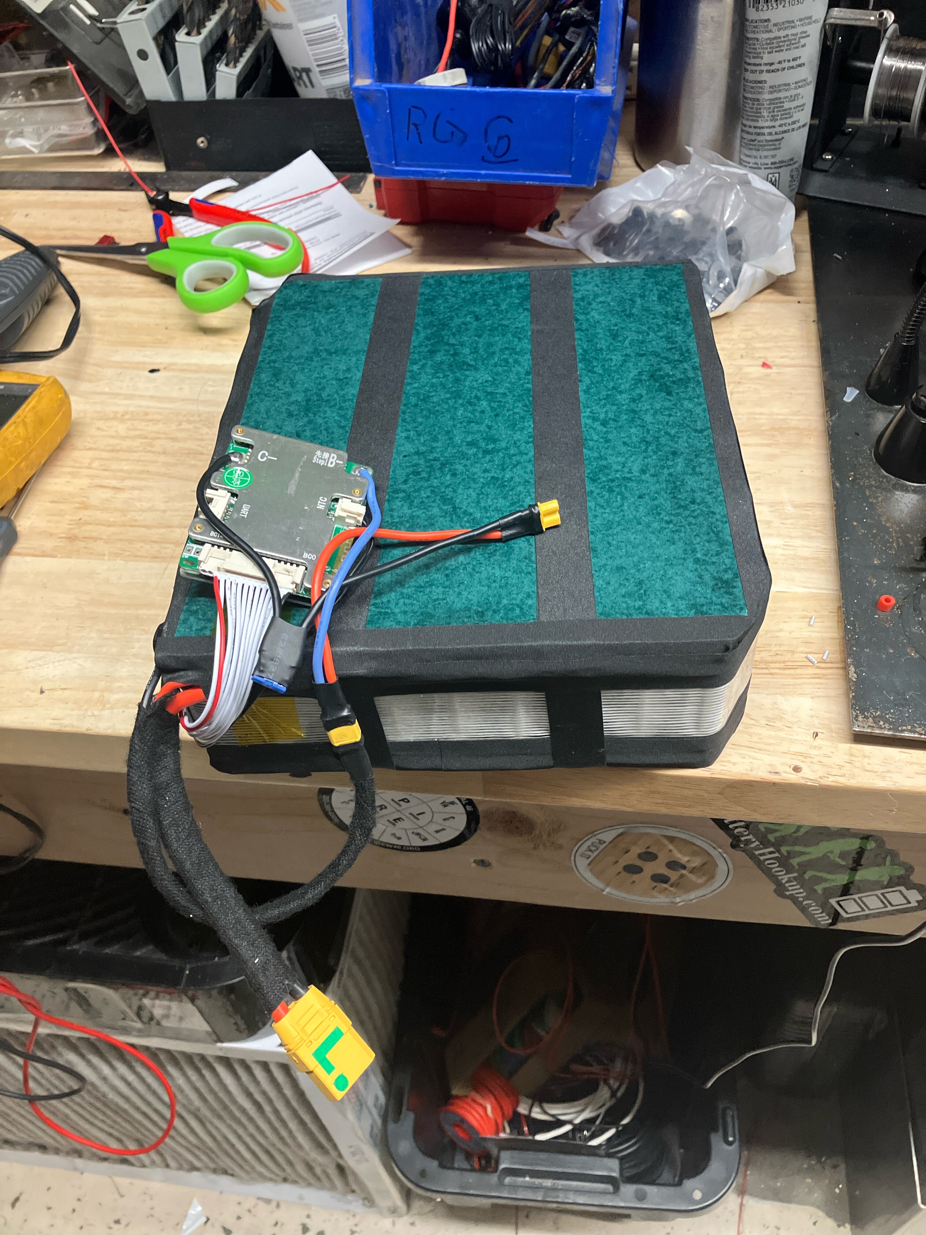

Looks good to me. Covers all the important parts. Do they hang out over the side or something? Imho they are plenty good - the spacing and insulation are all in the right spots

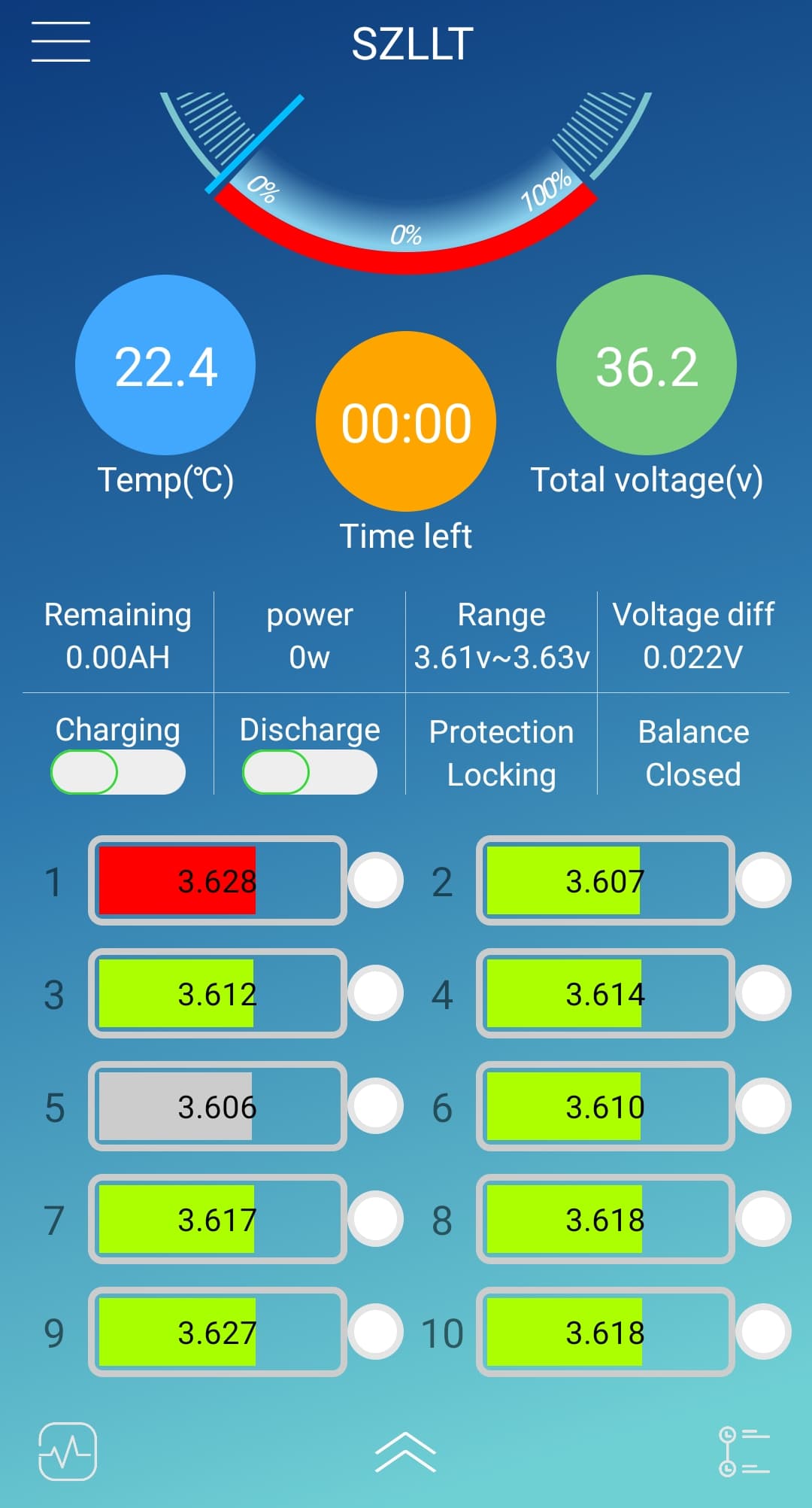

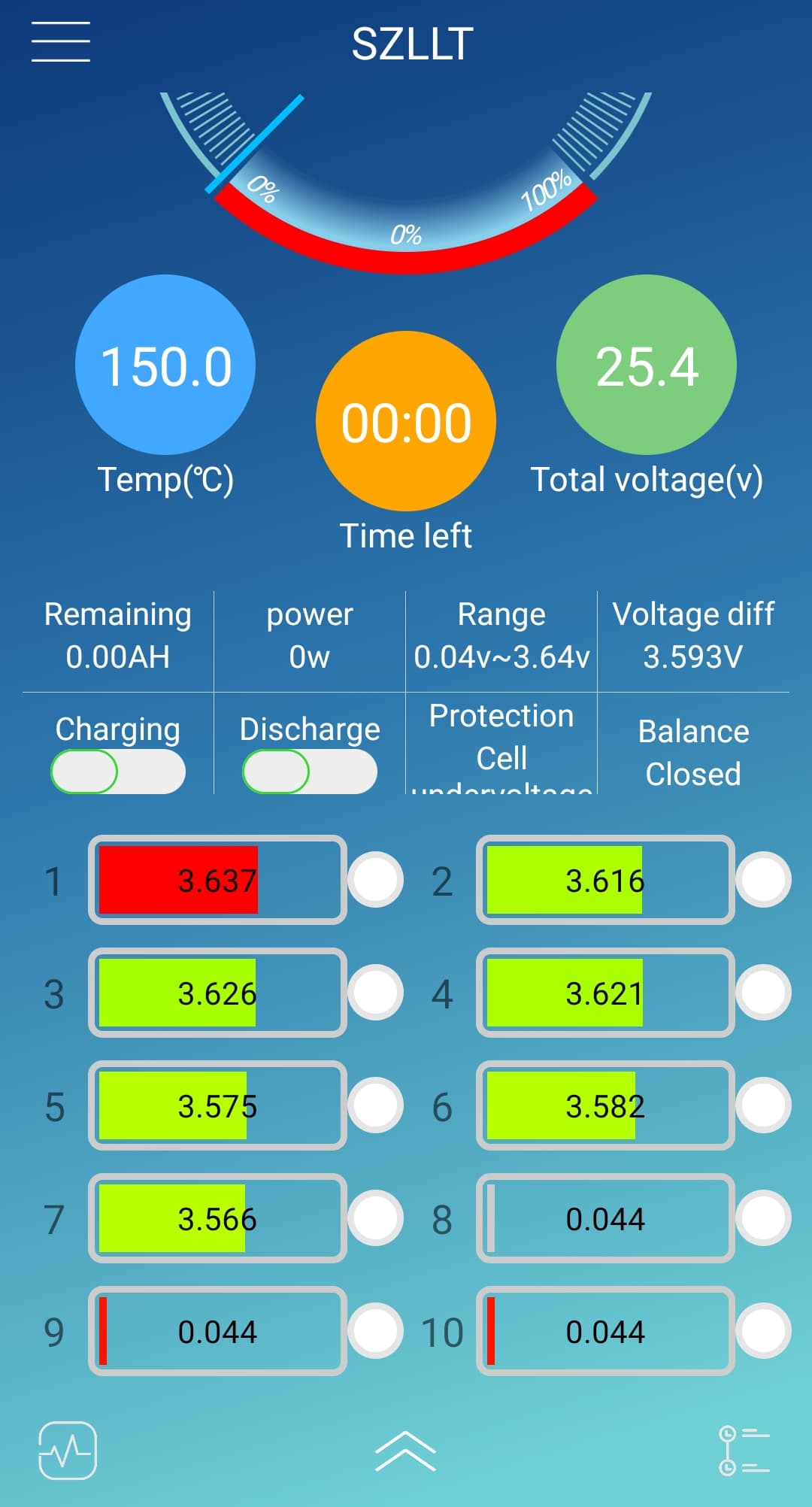

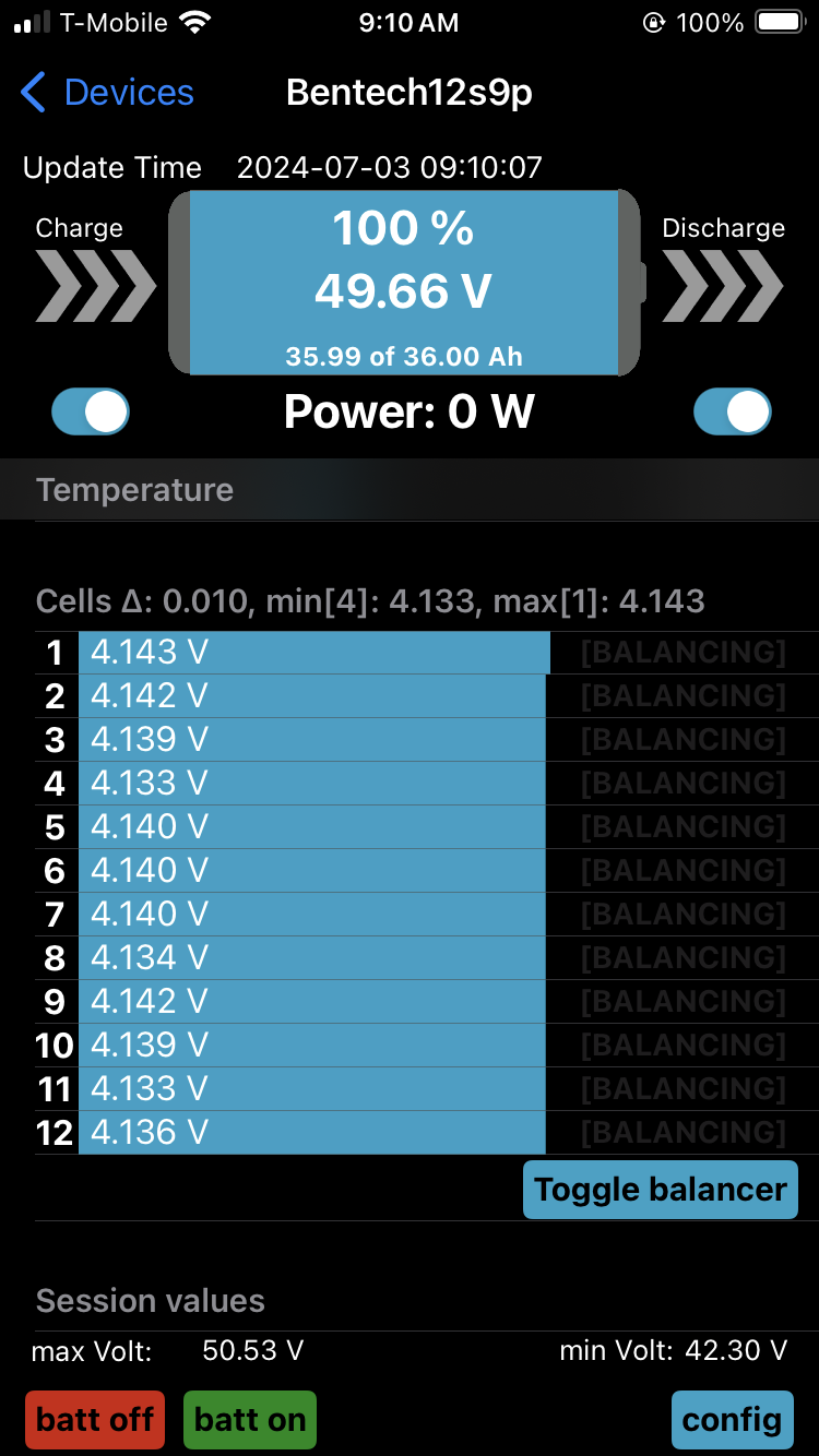

Took the enclosure apart, measured voltage with multi-meter after an hour or so any everything was normal. This is the battery this morning:

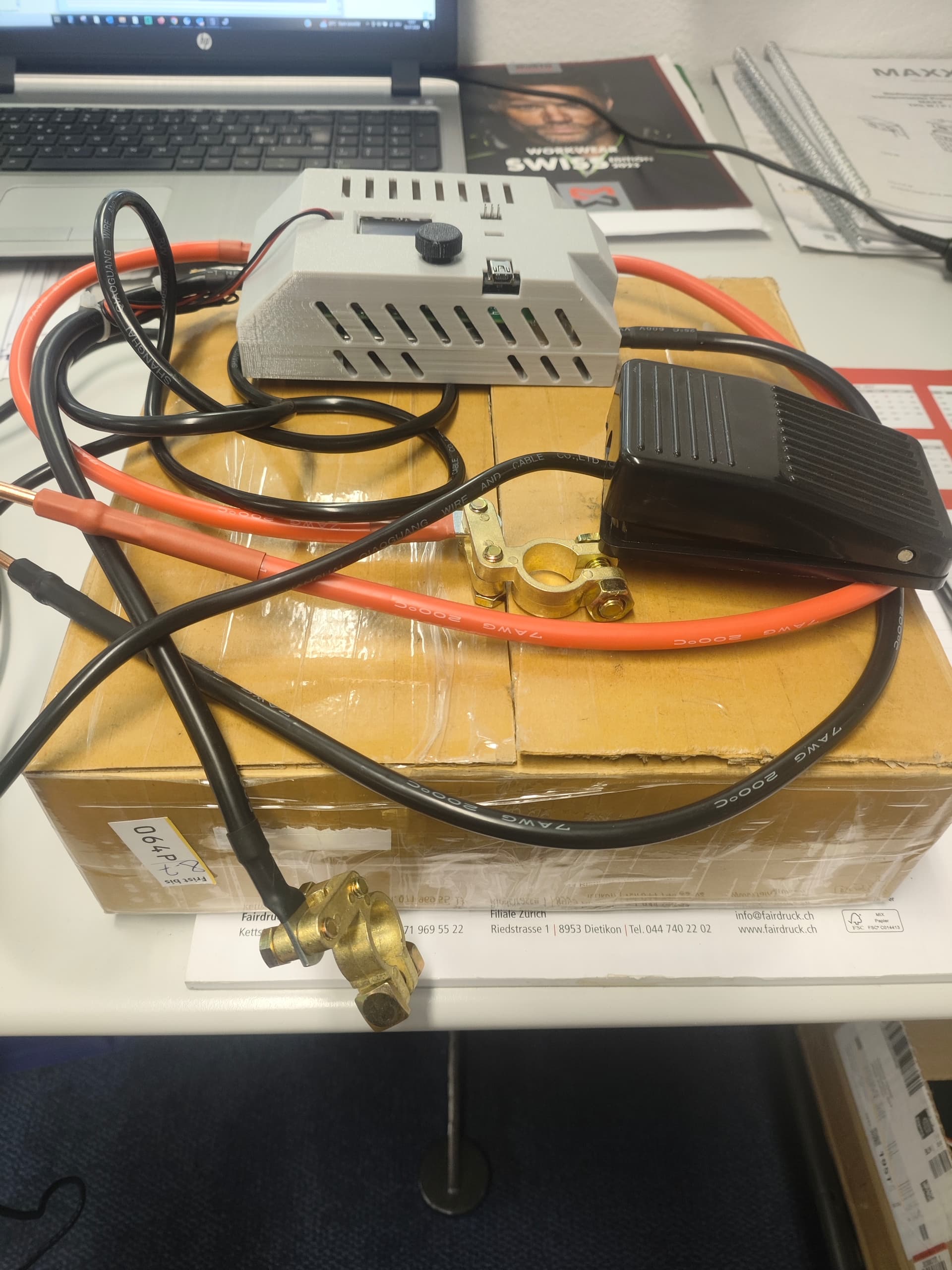

Does anyone have a Malectrics or Kweld they would be willing to sell at a decent price ?

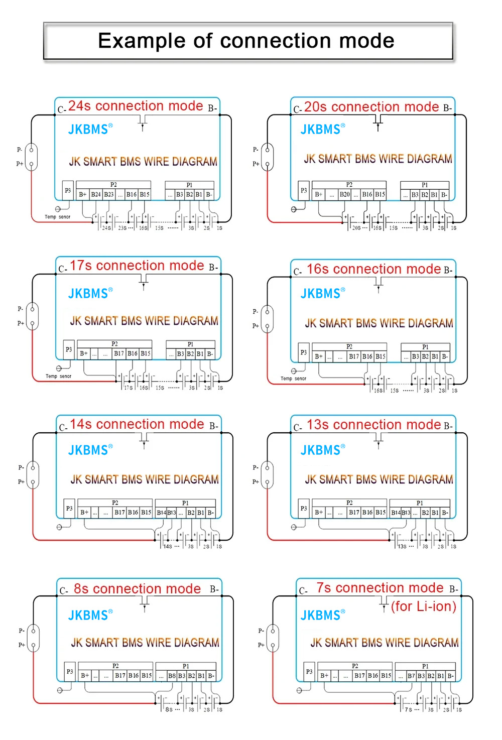

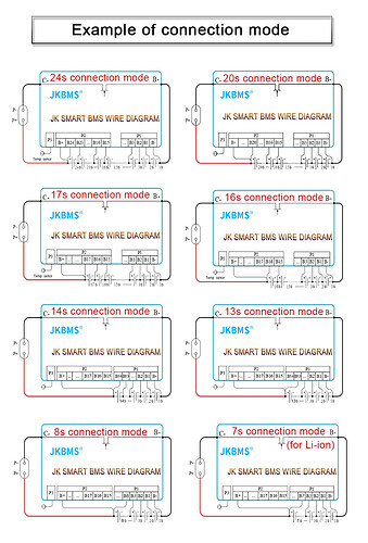

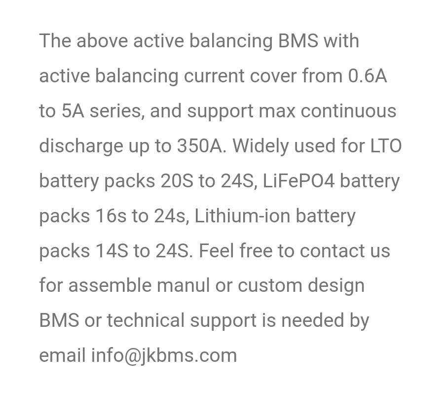

Is this bms ok fore 16s lithium ?
Esk8 pow pow
Yes, though im not familiar with this model or brand so make sure you get the wiring diagram and check that the app works with your devices. With the bms that have a range of cells - depending on your series configuration you will jumper different leads from the header/balance connector as well as set the series count in the app to configure it initially.
Agree with Pecos. I couldn’t find a wiring diagram for them, the instruction manual on the site isn’t super helpful in that regard. It only shows a fully populated wiring diagram which isn’t super helpful
Manual:
The manufacturer does say to ask them for clarification if needed
The aliexpress dealer say yes you can 20s bms 16s activate.

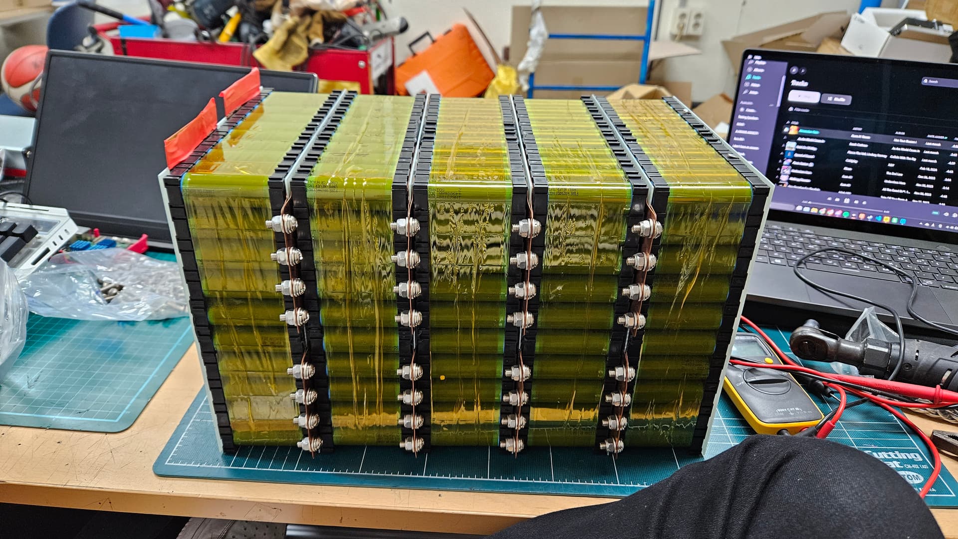

Chonk
Now THAT’S a brick :open_mouth:
Imagine the range with one of these boys as a supplementary battery :rofl::rofl:
