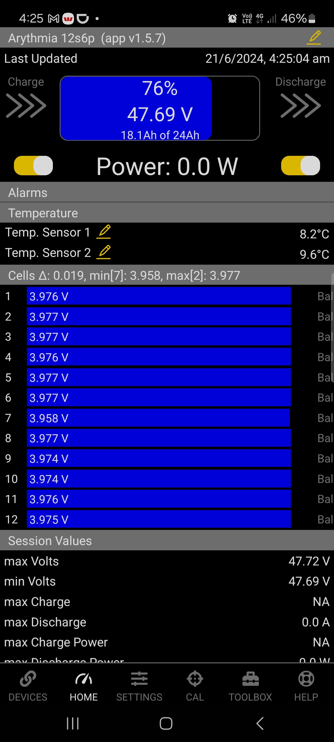

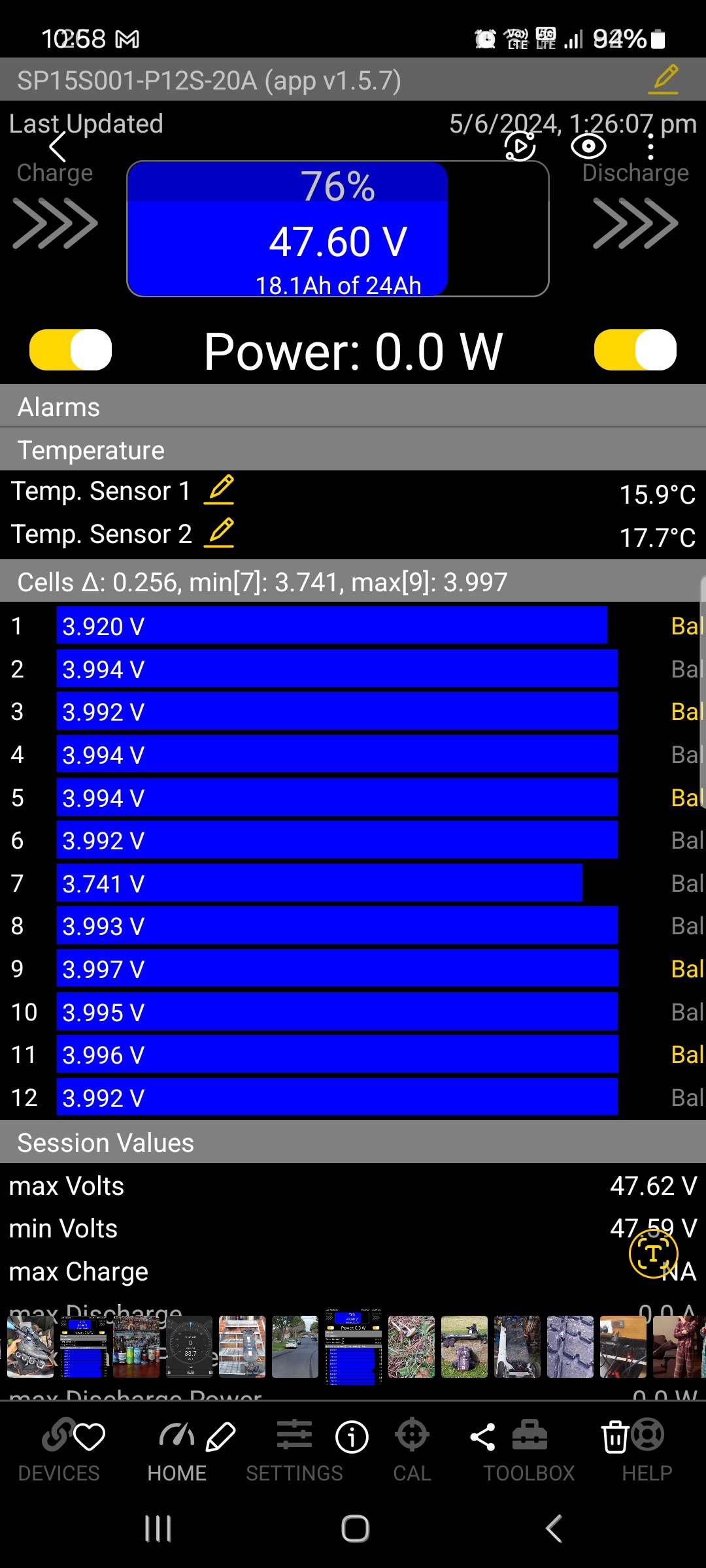

I’m wondering if all that heat fried some cells, reducing their capacity and forcing that p-group’s voltage up faster than the others? Hopefully not.
Ben/Duck is a solid builder so I would imagine he soldered the leads on before welding but I could be wrong. Just assuming because the nickel is folded over there. Pack is coming up on 4 years of age and has thousands of miles on it so I’m glad it lasted as long as it has, especially off roading. Really considering potting this battery in the new enclosure but the weight added is holding me back.

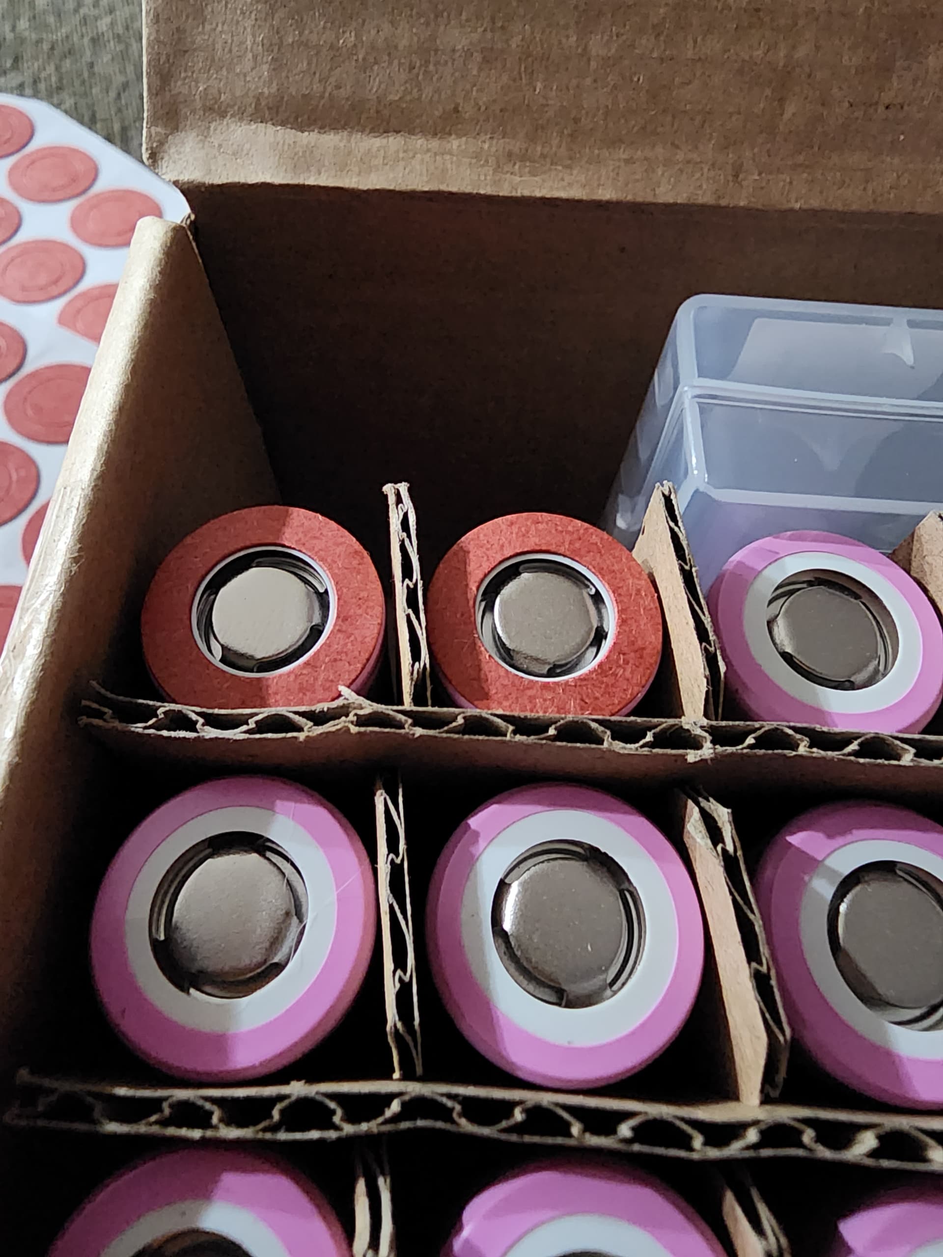

Do you guys think these rings are too big for my batteries?
No.

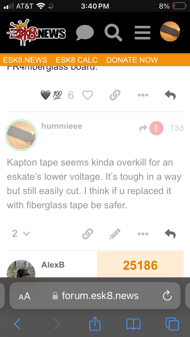

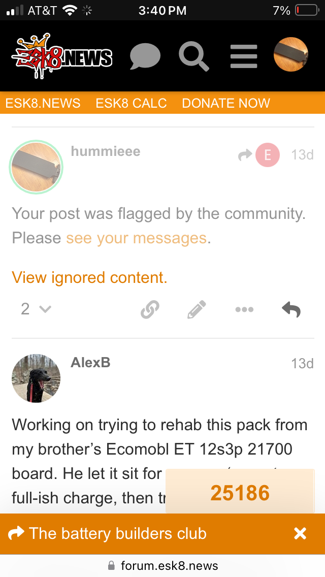

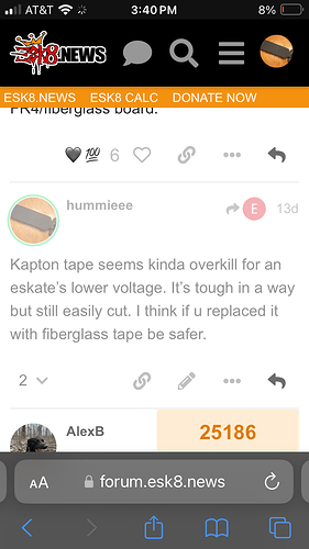

Why is this flagged as inappropriate?
Can anyone flag something as inappropriate? My opinion that kapton isn’t as durable as fiberglass tape and fiberglass is more suitable for physically abuse environments …is an opinion and don’t see how it’s inappropriate
