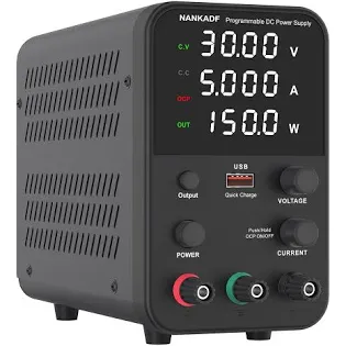

Ideally you’d want one of the following:
  1. An adjustable power supply (aka lab power supply), that lets you set voltage and current limits. Set it to 3.6V and 0.5A, it’ll use the full 0.5A for a while then reduce as it gets closer to 3.6V.

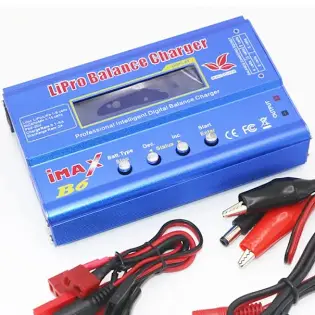

  2. A 1S lithium balancer/charger (or a bigger balance charger that can be set for 1S) would also work
download (1)
download
Generic lab PSU on top. Then IMAX B6 balance charger, those are cheap enough and (I think, please fact check me) pretty solid. It’s a configurable 1-6S charger
