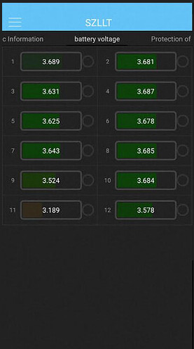

Ive got an old battery that ive not used in a while, the cells of which are unbalanced. Before i dispose of it out i’m going to try and revive it. Ive read that I should use a very weak charger and charge it very slowly. What strength charger would you lot recommend, 42V? another type? Should I charge for an hour then leave it for 24 hours then another hour, and so on?..what would people recommend?
Unbalanced or over discharged?
Don’t take advice from people on the web and instead read what the manufacturer states you should do if they get to a low voltage and if you can even revive them.
What cells?

40t
it’s a 12s4p pack
Is it unbalanced or low voltage or what ?

unbalanced I believe
@hummieee
What’s supposed to balance them? Why not working?
Charge cell 11 to 3.68v and do a cycle and retest.

I didint know that you can select specific cells to charge. May I ask how you do that, through the BMS im guessing?
Just do it manually. Why didn’t the bms do it?

Have a multimeter? Have an adjustable power supply?
I’m worried that because it’s not been charged in years that I need to treat it differently, i.e charging it slowly?

Maybe ur balancer does its balancing at the top of the charge. Probably.
If u can simply charge up that one group of cells it’s likely fine. Why it dropped so low isn’t good but likely ok.
