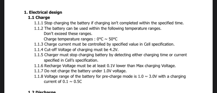

I said check the data sheet. What does the p42a sheet say?
It gives a chemistry:

Now that I know some ion cells CAN be discharged down to even as low as 1v and the manufacturer even says they’re good, makes me think those people telling me I’m a danger for JUST ASKING…and repeatedly insulting me… speaks for itself. Good thing I did question answers and didn’t just assume
Oooooor, testing was done on one cell, and one chemistry, for one application. And now that you know that the manufacturer has established a test to verify this you can then test various different manufacturers and chemistries to see if they will have the same results.
Or you can look long and hard to find the one confirmation in a sea of conflicting data and just play to your preconceptions. This seems like it was the plan all along though - you want data and proof? Take those low cells from the salvage and a few good ones and start cycling them. Take some to 1v every time, some to 2.5. Log everything and report back
50s spec sheet says do not exceed the discharge limits or it will lose performance characteristics but then 3 pages later it looks like a quote from the chart you showed: over 1v it can be changed at a very low rate but can be changed. This doesn’t mean to me that all cells can be blanketed by this but it does seem to indicate that the Samsung cells can be charged as long as the dont go below 1v.
Panasonic and Sanyo say similar related to recharging over-discharged cells.
It’s not one cell, or brand, or chemistry, or application. In fact it seems maybe even all ion cells that have been over discharged, possibly all the way down to 1v, can be recharged again. This is according to the manufacturers.
There are a number of issues with what you’re saying.
You’re currently using cell datasheets as some kind of “Ah ha!” to counter the feedback from people in this discussion who have what is most likely, much more experience, expertise, and nuanced understanding of the topic. These include people who haven’t insulted you, and have explained in great detail the answers to the questions that could be gleamed from what you’ve been writing.
As a result of that, you’re very much misinterpreting what the numbers on datasheets mean.
To start, those datasheets aren’t written for you. They’re written for engineers to use as design guidance for devices with integrated battery packs, around which BMS systems are designed and also integrated. Those engineers span from electrical engineers, mechanical engineers, and integrations engineers who look at a system/product from different angles, and then coordinate their understandings to arrive at a final system.
This is also how BMS IC chips are treated. Those chips have their own spec sheets, with voltage cutoffs, temp ranges, etc. And they also have reference schematics that show examples of how to implement the chip into a circuit. What they DO NOT show, is the ancillary circuits needed to properly power the IC, protect it from the battery circuits itself, or tailor specific functions of the end device alongside what the IC is designed to do. This encompasses the assembly of the device (since factory or end user assembly has to be accounted for) and failure modes that the IC doesn’t accommodate.
That’s all to say, that you simply cannot point at a datasheet and go “SEE? I WAS RIGHT!”
When you do that, like you just did, you display ignorance and a lack of understanding of the topic, and so the conclusion that you’ve dug, incorrectly, from these sheets, doesn’t end up serving you or anyone else. And it’s also wrong.
You’ve ignore other lines in the sheet, like the fact that 2.0v is the BMS shutdown voltage.
That means that in devices using those cells, the BMS doesn’t just disallow charging and discharging, it has to completely shut down. Those barriers are separate and distinct from operational cutoffs. Shut down means the end user is completely barred from using the device, period. No charging, no turning it on.
The manufacturer is saying that if the battery hits that point, the device is to be deactivated.
There’s also this, as a qualifier of the data in the sheet:
“This Specification shall not apply to special applications requiring a high degree of quality and reliability where the failure or malfunction of the products may directly jeopardize life or cause threat of personal injury.”

The data sheets say they can still be used if they’re discharged to 1v. It’s not complicated and doesn’t need an “expert” or “engineer” to figure it out. It is an “aha” moment where know-it-all’s tell me I’m not smart enough to understand…and they tell me the wrong thing. I don’t care how many batteries you sold and how much of an expert u think u or what customers u send here.
This forum is for learning. Anyone saying it’s not appropriate for me to write that u can still use at least some ion cells that hit 1v, because someone might not be familiar enough or they’re not knowledgeable enough and it’s too dangerous for them to hear… whatever.
The thread is a shit show because I was repeatedly insulted and condescend to just for asking a question … then told to just follow along without any evidence given. And then you want to continue with the charade that I’m not understanding. I understand fine.
it’s a fascinating revelation that manufactures state 1v cells can be still used, but sad because the discovery is an assault to some egos and it can’t be further discussed
They don’t state that, and if you ask them directly, they will tell you as much.

Yes manufacturers state specifically 1v cells can still be used. Read the data sheets. It’s like a brick wall.

It says pretty plainly that they will lose some of their performance characteristics when discharging below 2.5v. I don’t think that qualifies as good. It also says that the charge current needs to be especially low which most chargers are not going to do automatically. Instead of exploring what this means you just keep slapping the word win on it to do what you want man. Electrical systems are not cut and dry, they are a balance of many many complicated factors.
If it was the intention of the writer of the data sheet to have 1v as the limit wouldn’t they have put that somewhere more prominently and explicitly, like on the first page with all the limits? Instead it is edge case limit with qualifiers and everyone with engineering experience says it’s a bad idea.
