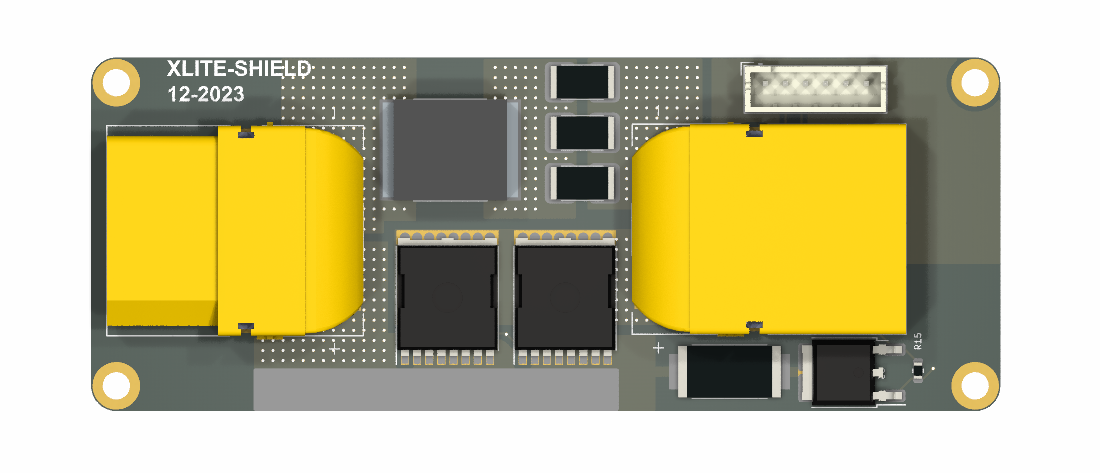

Instances like these, would benefit from a VESC connected BMS, as well as the newer stuff @ENNOID is working on. The shield item looks promising for that kind of thing.
For VESC one wheels, the devs who maintain the Float Package rolled in BMS related triggers for tilt back, rather than using the motor throttling warnings. But for eskates, having the VESC BMS data to throttle acceleration back, is useful. It can be used to signal a battery problem during discharge, either from under voltage conditions or overtemp.
This can be done without the above linked item though, since it’ll work over CAN.

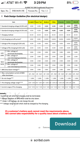

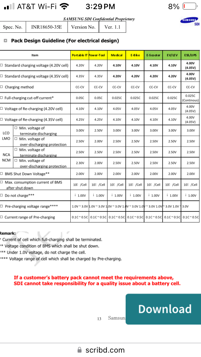

Samsung data sheet says can charge a cell if it goes to 1v!
It’s the 35e 18650
The Samsung 30t data sheet shows the same
I asked if it was possible. I got insults and told I was a dumb fuck and too dangerous to be here and that I was starting a toxic discussion. I was told I needed to trust the data sheets. Here it is.
