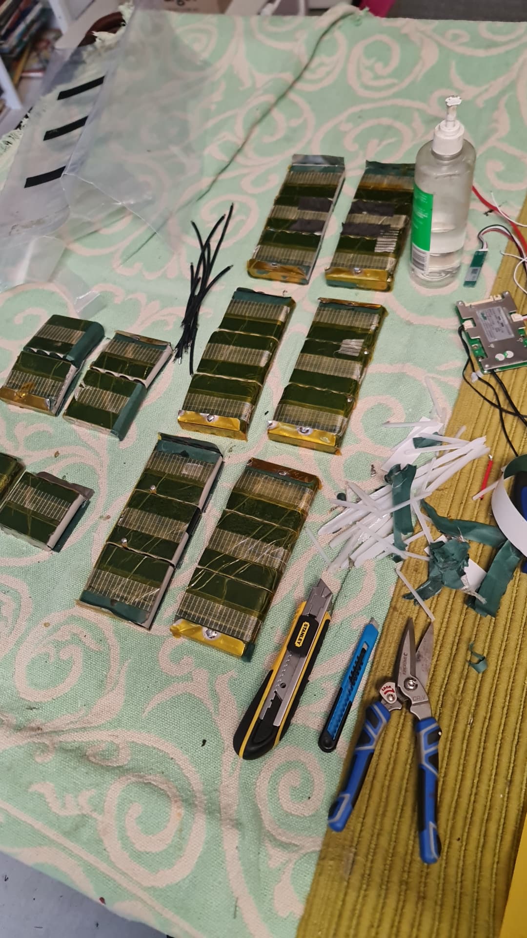

Couldn’t sell my old 12s8p p42a so breaking it down into two 12s4p packs. One for the famous Frankendick by @glyphiks and hopefully i can sell the other pack :crossed_fingers:
Not quite as simple as I thought it would be to break down. A stanley knife ended up being my tool of choice to split the 8p groups in half but I still shaved the edges of a few cells causing a few little sparks :sweat_smile:. They’re still all testing same voltage so hopefully all ok. Ill build my pack with the cells i sparked just in case.

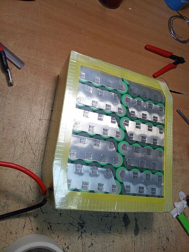

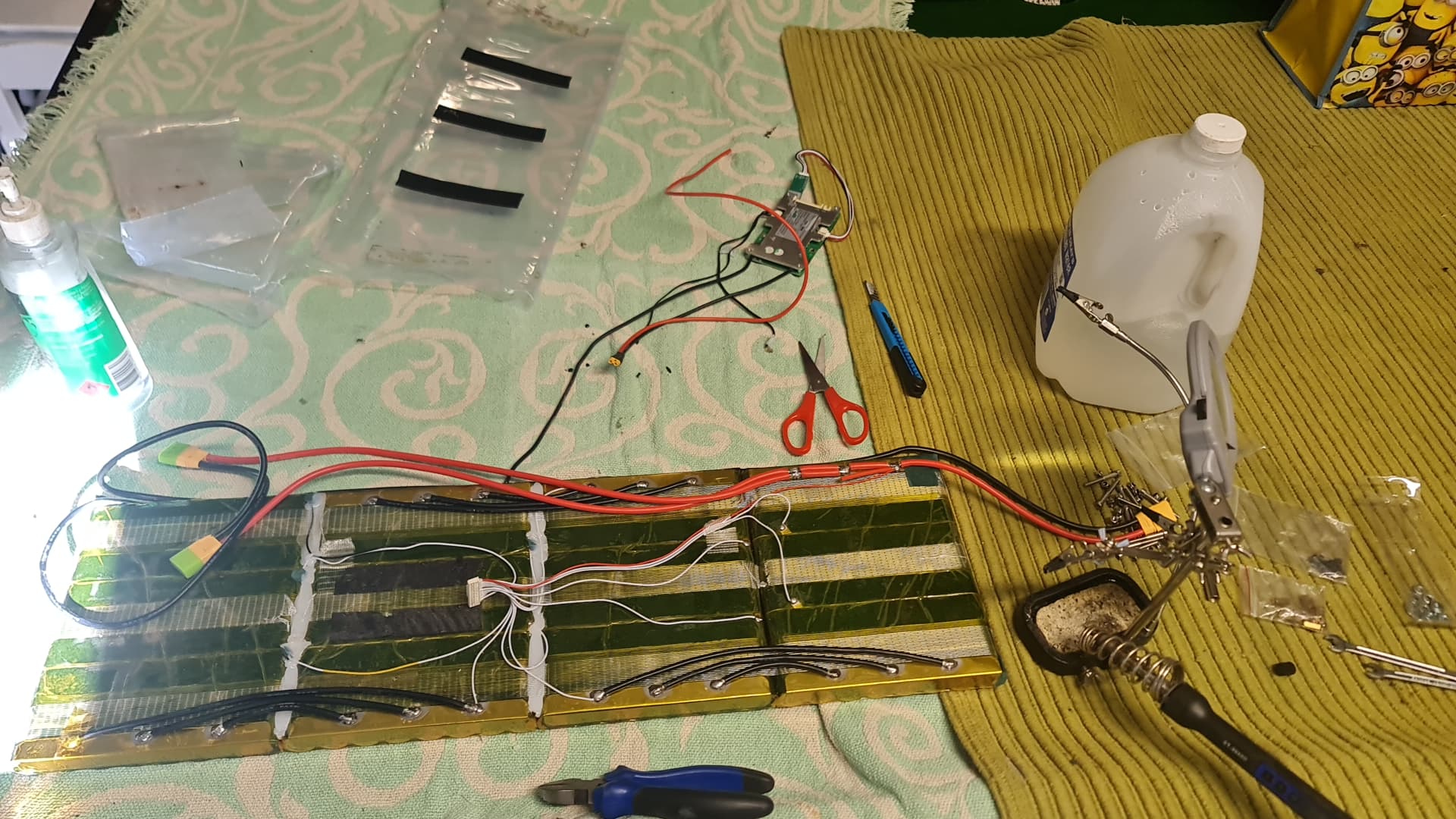

My new battery for the case with a transparent cover

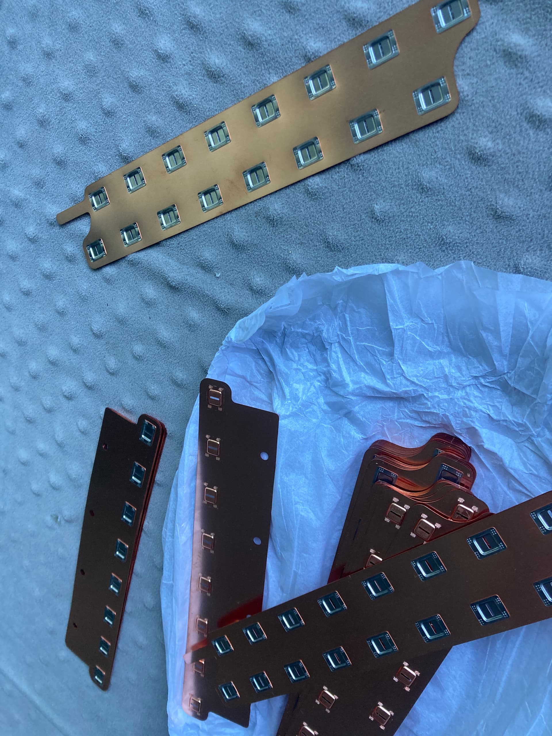

What’s the purpose of the additional nickel squares on top of each cell terminal?
I thought they were indents? But ya, they look clean but whats the purpose here?

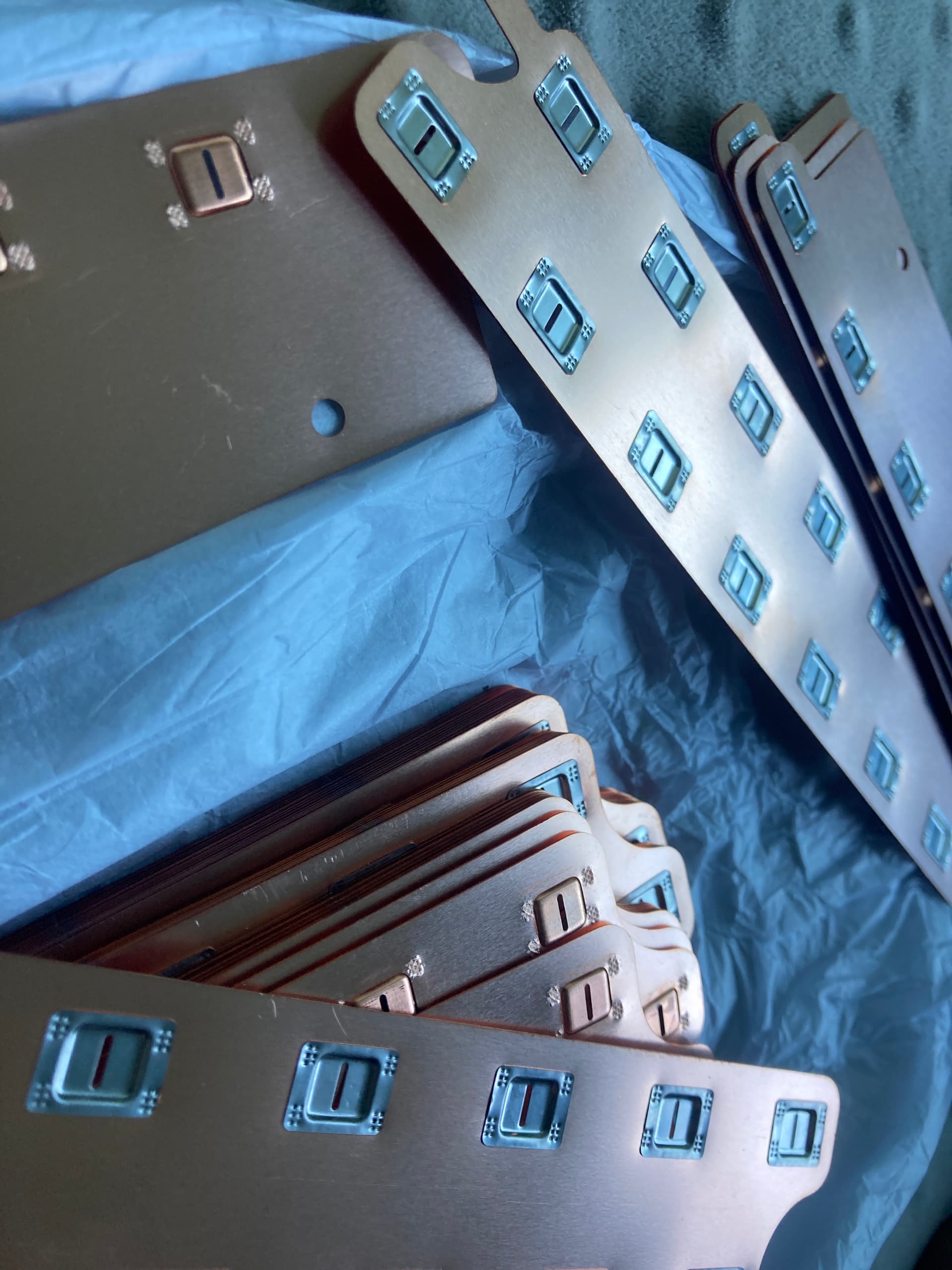

The main plates are made of nickel-plated copper, by itself it is very poorly welded and holds, welding in 2 layers of iron + copper gives very good strength, copper itself does not hold well and is very soft
@iliamaslennikov9 It depends, most spotwelders like the kWeld even, are stock/out of the box indeed not strong enough to spotweld copper directly, nickel will help it to generate enough heat for it to actually stick
there are only a few that can really do it reliably like the sunstone pa250i but thats a very expensive spotwelder and only okay priced for companies that might be building packs regularly
There’s a lot of development of the nickel (or steel) and copper sandwich on endless-sphere. There’s also been companies in China that make custom copper/nickel hybrid strips that are ready to go and easier to work with
I found my cheapo welder/lipo combo did not have the power to weld 0.15mm copper with 0.15 pure nickel atop, nor 0.15 copper with 0.10 nickel plated steel atop, but it does have enough power to weld 0.1mm nickel plated steel atop 0.1mm copper.
Using the infinite slot method, on recovered cells whose nickel plating was mostly sanded off, I did achieve success with 0.15mm copper and 0.1 nickel plated steel, but when I tried that combo on new cells with fresh nickel plating, about 50% of the welds were inadequate, and peeled off way too easily.
I doubt my low power requirements really benefit from the lower resistance series and parallel connections, but warm and fuzzies can be priceless.
That’s a clean looking battery, but it appears the very center of the cans was not deliberately avoided.
I didn’t have good results with my attempts to do the sandwich either and ended up getting the pre-done custom stuff from China. It’s super easy to weld.

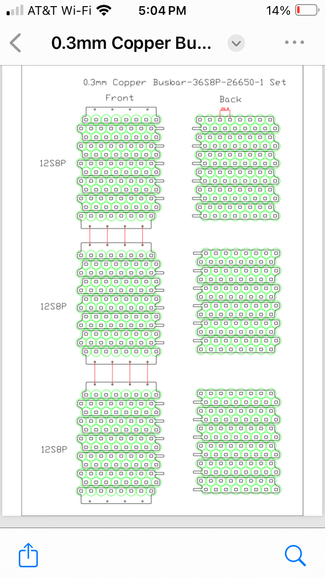

I’ve got these extra strips for a 36s8p 26650 battery I ended up not making I’d sell for 50$ including shipping. You could cut them.
.3mm copper
They’re super cool. Does anyone make similar for 21700 cells?

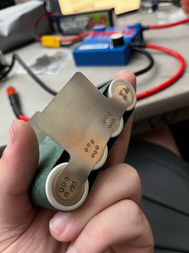

A Friend is welding some packs. do these welds look good? (i’m wondering if they look a bit hot. )
Little hot, turn the welder down a few joules.
thanks. feedback transmitted.
Hi, Friend here. Message received :smile:

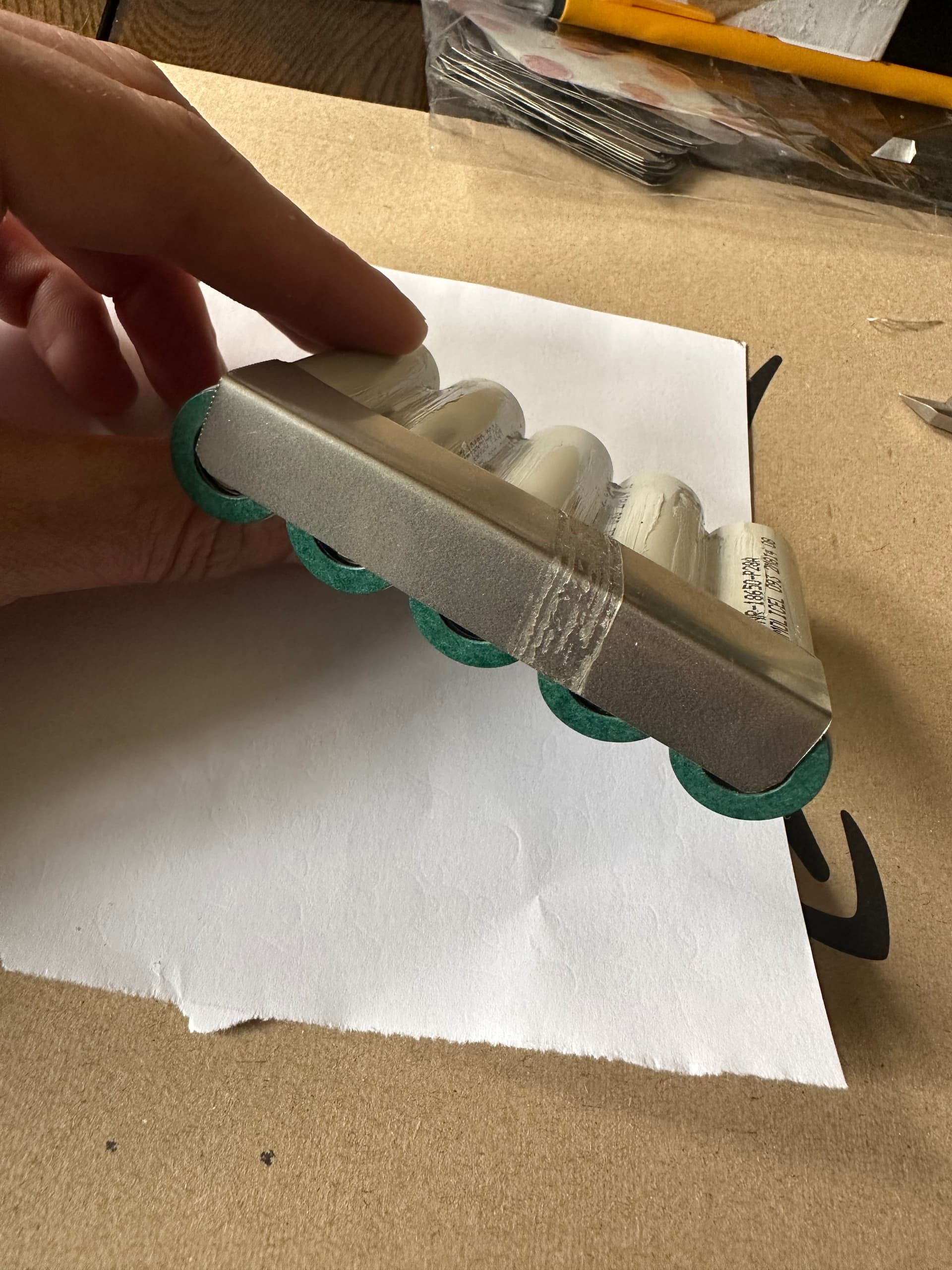

Anybody got a link for 18650 5p nickel plate so I preferably don’t have to cut my own? Thx

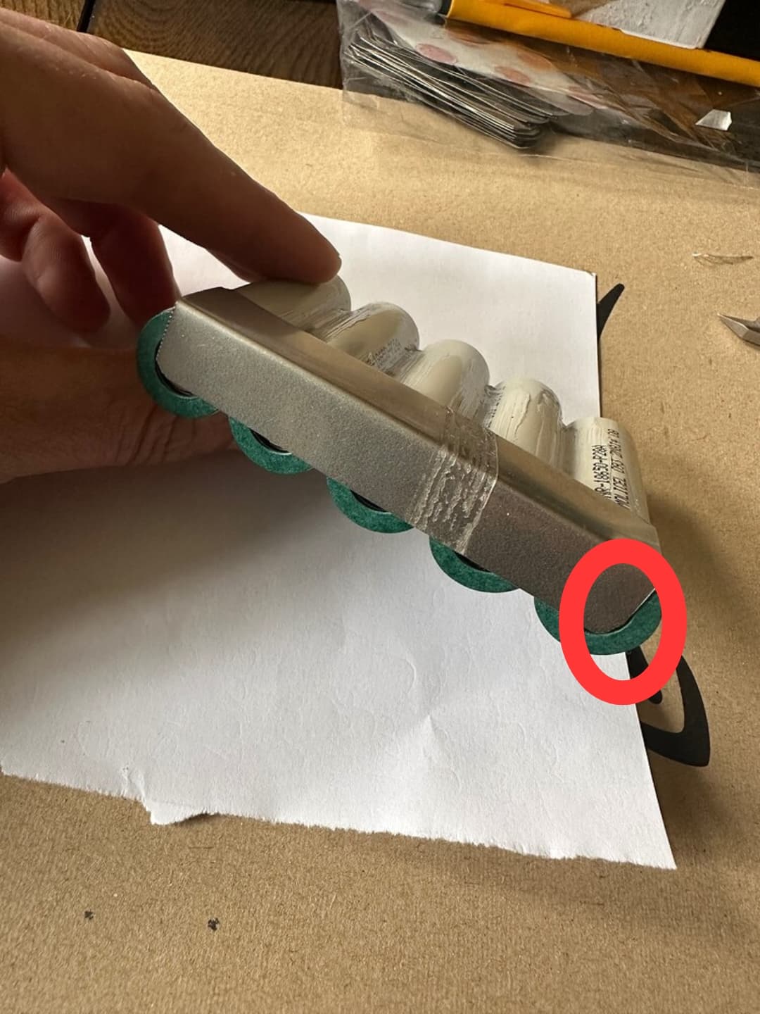

Guessing this is acceptable for positive terminals ?
You’re a bit close to the shoulder here. Trim the nickel to go no further than the edge of the pos terminal. Where your nickel is currently sitting is the danger zone and a prime spot for a short.
