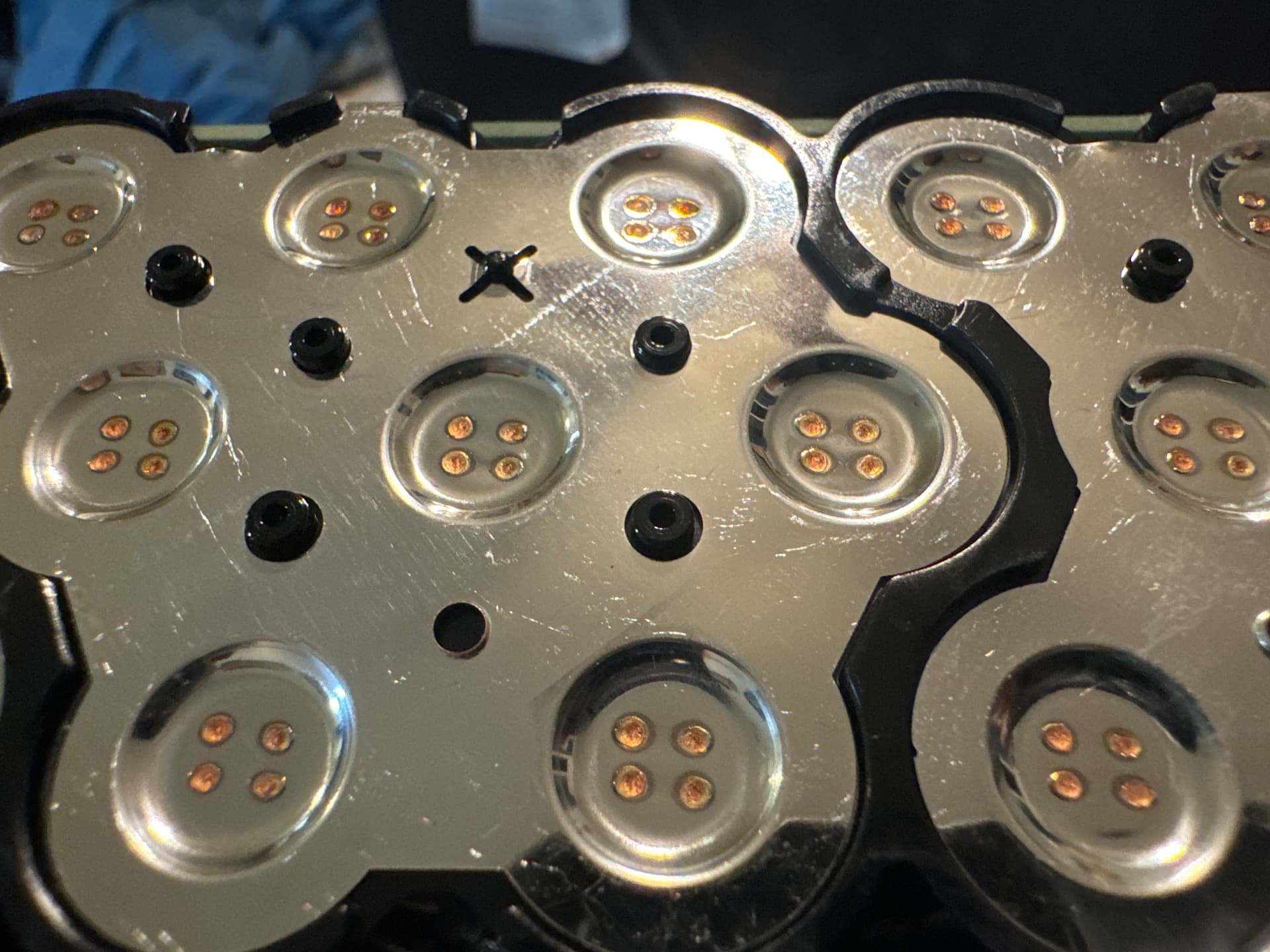

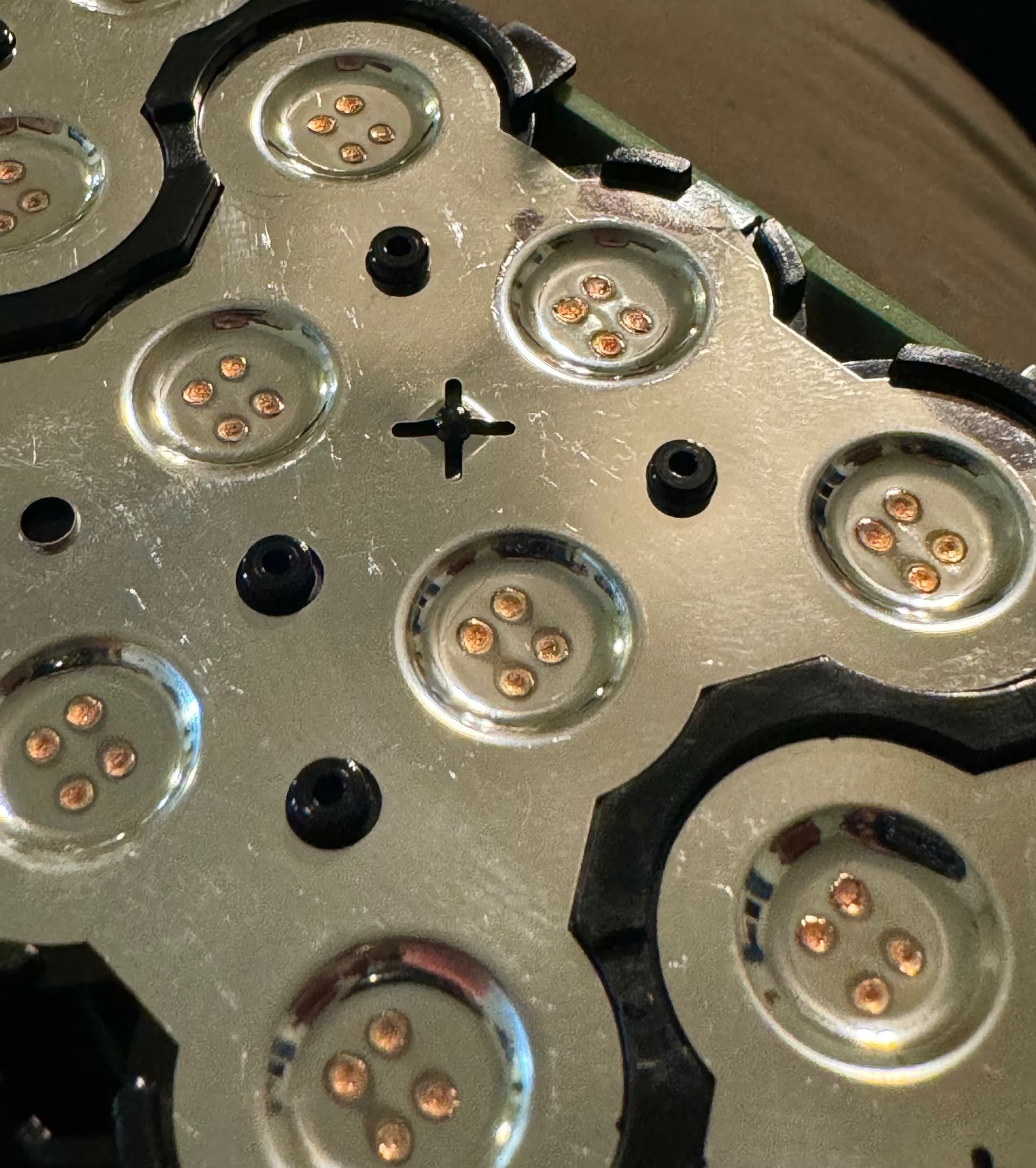

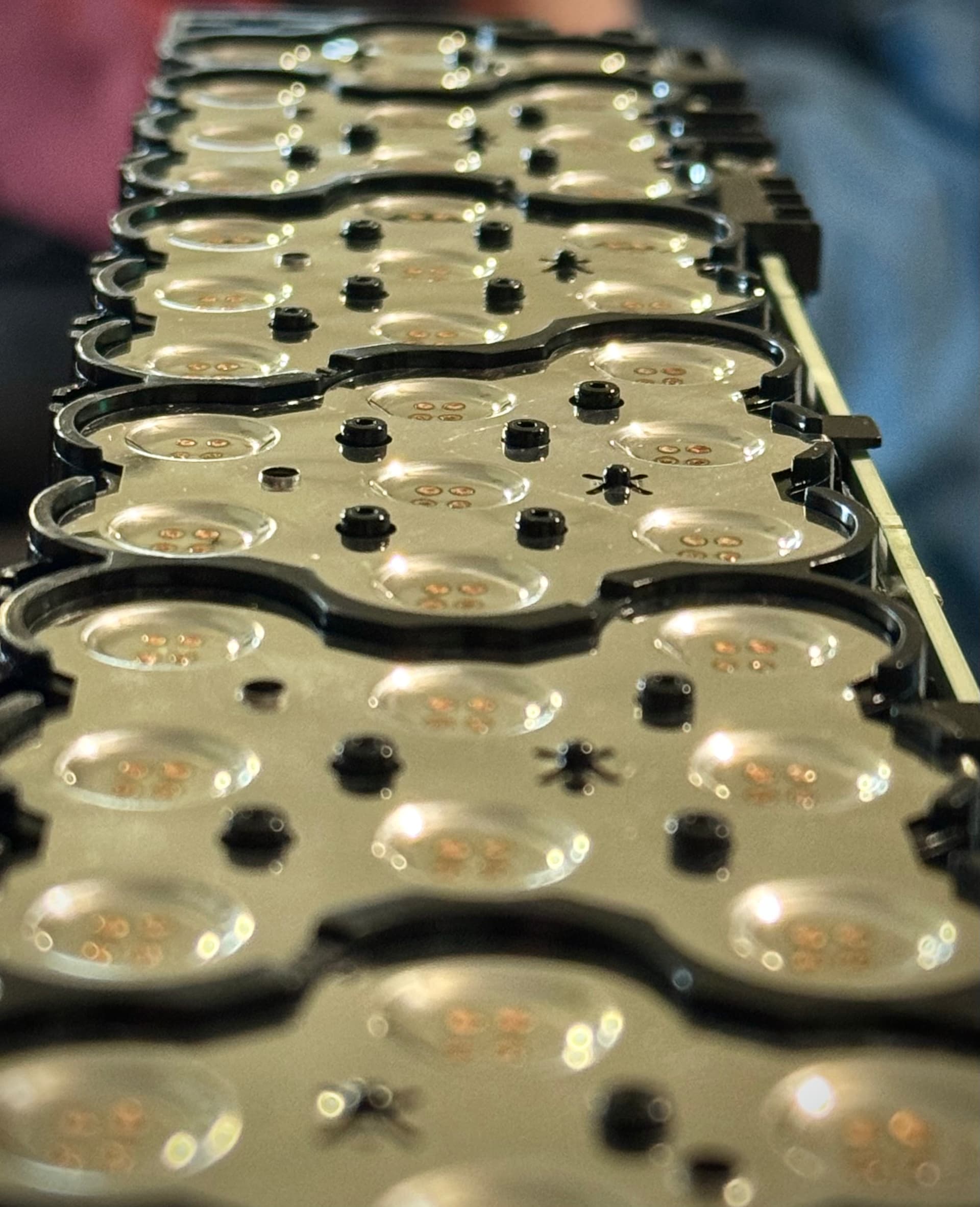

Shimano e-bike pack of murata vtc6 (10s4p) with nickel plated copper. Local e-bike mechanic didn’t want orphan packs in shop after warranty work.
40$ for 2 packs. Cool dude. All p’s balanced to the mV, bt-e8020 model. Bypassing bms to discharge and discover
Where else have y’all seen disassembled packs with nickel plated copper? That’s what’s going on here, right?

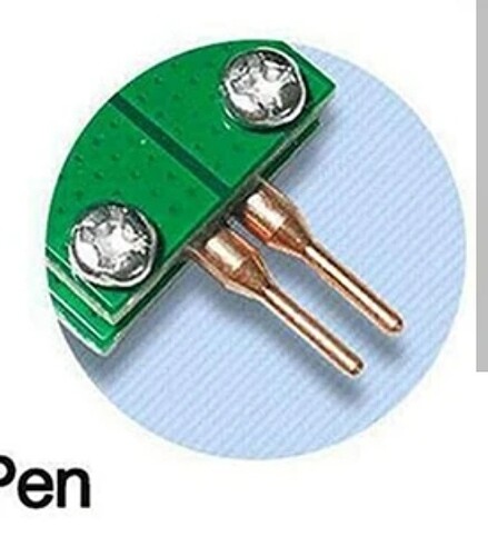

If you’re asking about the copper color at the weld points, that could just be copper that was deposited by the welding probes. Not necessarily nickel plated copper tabs.
I’d be embarrassed if I left that much probe on the pack. Contact area would get progressively wider.
I’ll cut on it and report.
Most BMS’ alternate between the even and odd numbered cells when balancing in order to prevent overheating of the balancing components for adjacent channels.
A side note…this results in the balancing current being a bit less (or a lot less) than 1/2 of the current that flows when balancing. For example, some BMS’ that say they have 50mA of balancing current but they’re actually balancing with about 20mA (average) of current because of this alternating of odd/even channels. It’s not exactly 1/2 because of the bit of time needed to sample the cell voltage between balancing current pulses.
Industrial welders (which that pack was probably made with) use straight cylindrical probes, not tapered probes like our hobby welders use. They can deposit copper on every weld, and never change the contact area or shape.
However I do agree with you, that would he an unusually large amount of copper to deposit on each weld. I’ve never seen that amount, or that regularity. I also dont know what it looks like to weld nickel plated copper, so that could very well be the case.

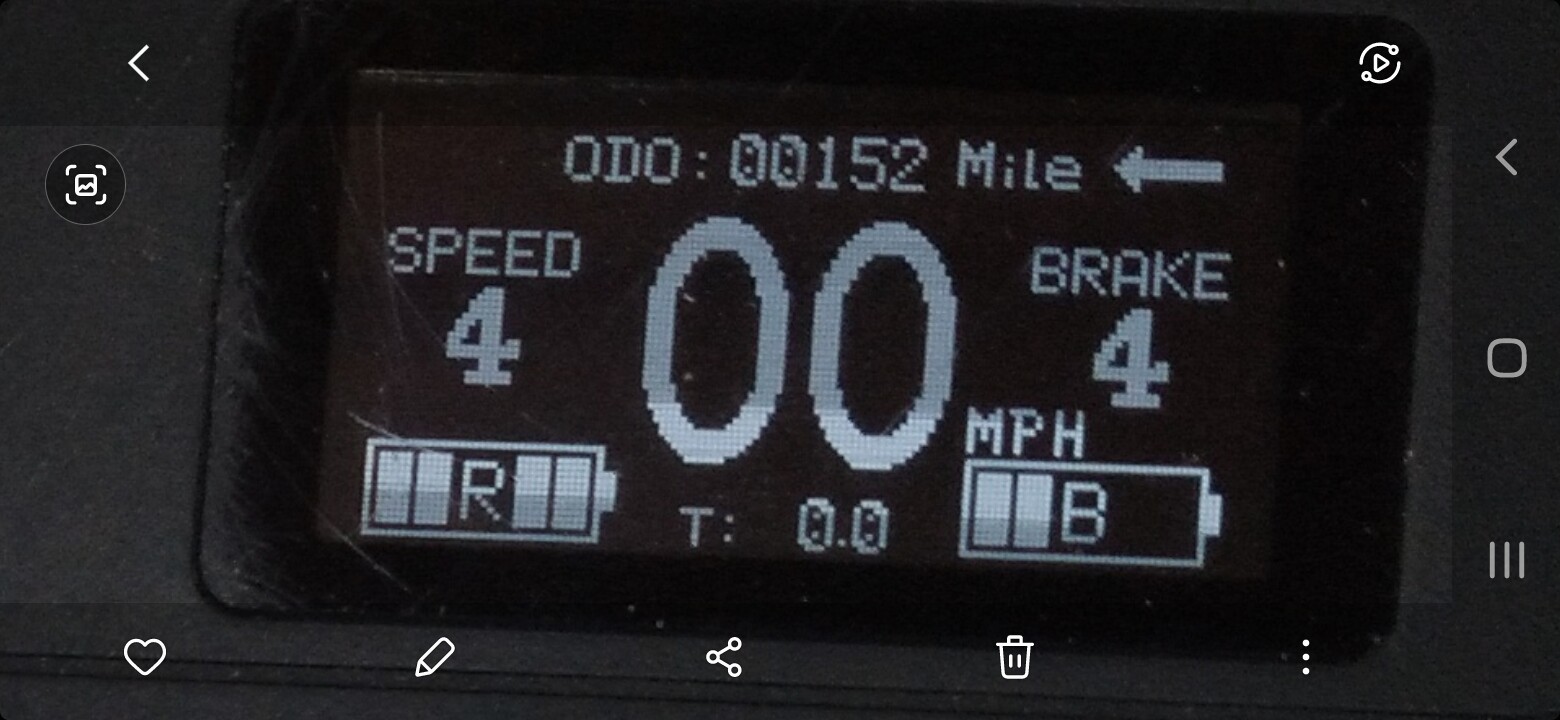

According to my remote, my first Esk8 battery, a 10s2p of Dmegc 2600mah 15 amp cdr cells, now has 152 miles on it.
Only once did I ride to the point the remote buzzed or beeped I cant remember which.

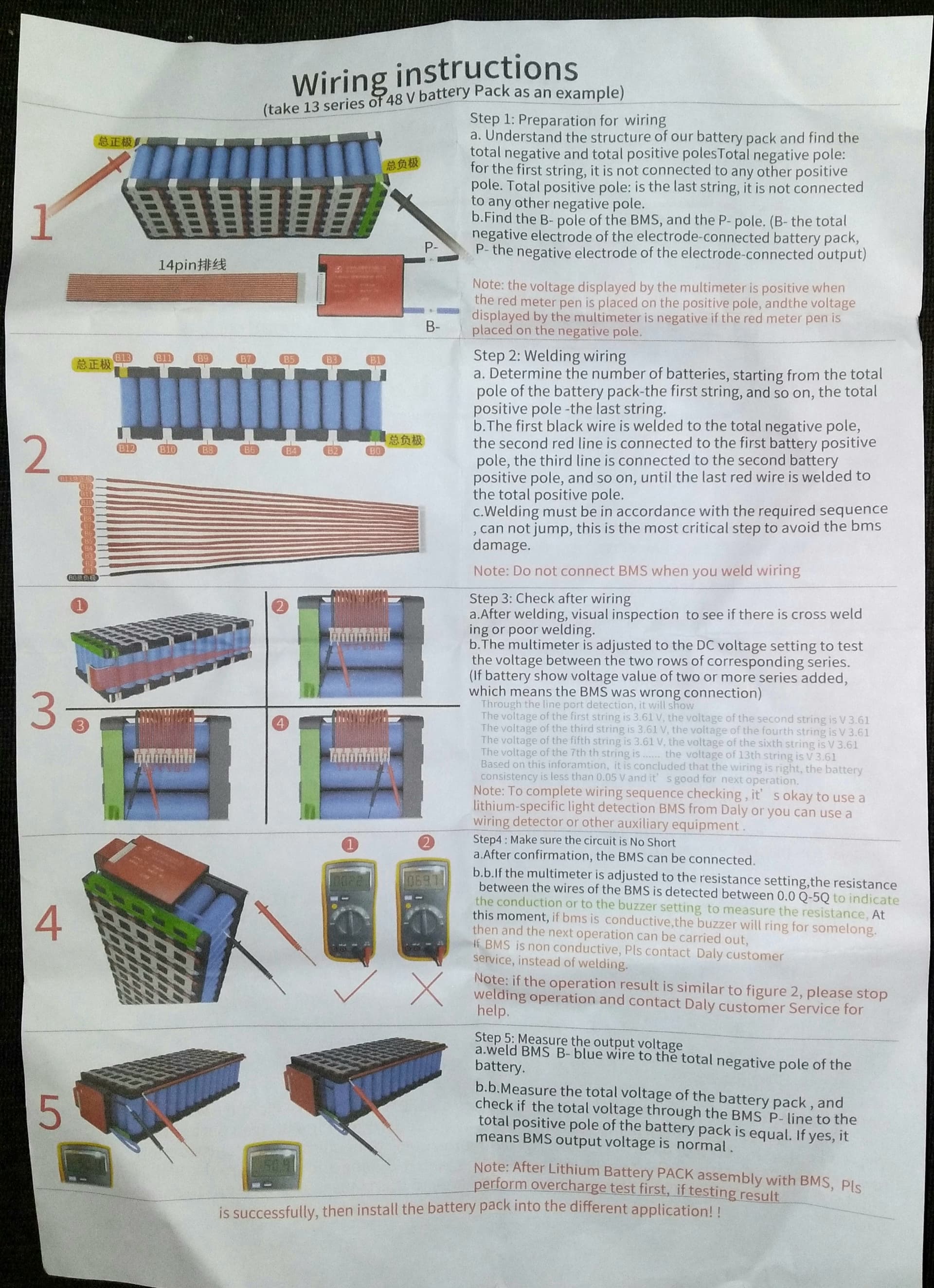

I worried that I damaged it, as I had attached it to total battery negative, before plugging in the balance cable, and later saw directions on a a different ebay seller’s website, to only hook it to total battery negative After seating the multi wire balance plug.

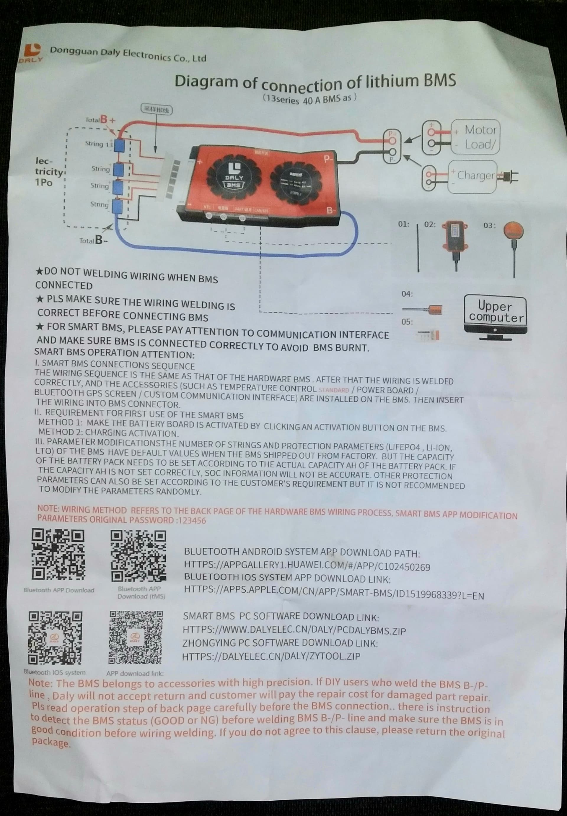

So, in what will likely be another regretted decision, I recently received another 20amp common port Daly BMS in the mail, in 10 days from China.
This time, there was paper instructions included in the baggie.
The usual poor translation.
Notice steps 5, where it says the B- blue wire can now be connected to total negative pole.of battery, where step 4 says the bms can be connected.
Here is the other side of the paper with directions for a smart Daly BMS.
I am really curious about my P group balance, but it ‘seems’ my reversal of steps 4 and 5, did not damage the BMS. But I have no proof.
Checking the voltages on the balance connector, without disconnecting the blue wire from battery - first, ‘might’ damage, or damage further, the BMS.
I dont know.
Opinions?
I don’t want to dig out my blue wire to snip it and then remove the balance connector in order to probe it, then have to try and add connector in a space not originally designed for it. I can, of course, but would prefer to not have to.
So I wonder how important the order of steps 4 and 5 are?
Opinions?
I will make the next battery, with a likely XT 30 connector on blue wire, so I can adhere to Daly’s order, if i decide to use the newly arrived BMS, or instead, employ the comparatively huge Smart JBD which is on a truck a few hundred miles somewhere north of me at the moment.
I could also remove the potentially partially damaged Daly on my Dmegc pack, and replace it with the newly arrived daly, adding a XT 30 inline beforehand.
Fitting the larger Smart JBD adds some complexity to the small enclosure for a mini kicktail, but I am at that enclosure layout stage, and trying to weigh my options to arrive at the best possible result.
It matters on some bms, but a lot of them can do both ways no dramas.
Having connectors is always a good idea. This way you can do whatever you need to with minimum hassle :+1:
Personally i think the Daly you have is probably fine, but i do understand the peace of mind that comes from replacing a questionable part. Once that doubt is created it can be hard to shake.
