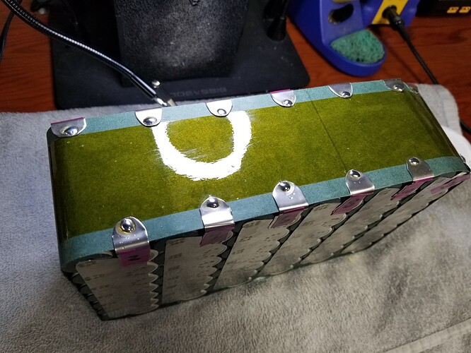

I’ve been building batteries for the last few years, but just completed my first MTB battery. This is a 12s7p P42A pack for my Haero Bro deck. Thanks @ShutterShock for the nickel source! Will be buying more in the future.
First, I did some layout work to make sure the battery would fit in the enclosure box:
Then completed the spot welding phase:
Balance tabs pre-tinned:
Pre-sorted the balance wires to avoid overlap:
Balance wires soldered in place:
Power leads soldered in place:
Shrink wrapped:
It’s tight, but fits just right!
Nice! That was a pretty quick build haha
