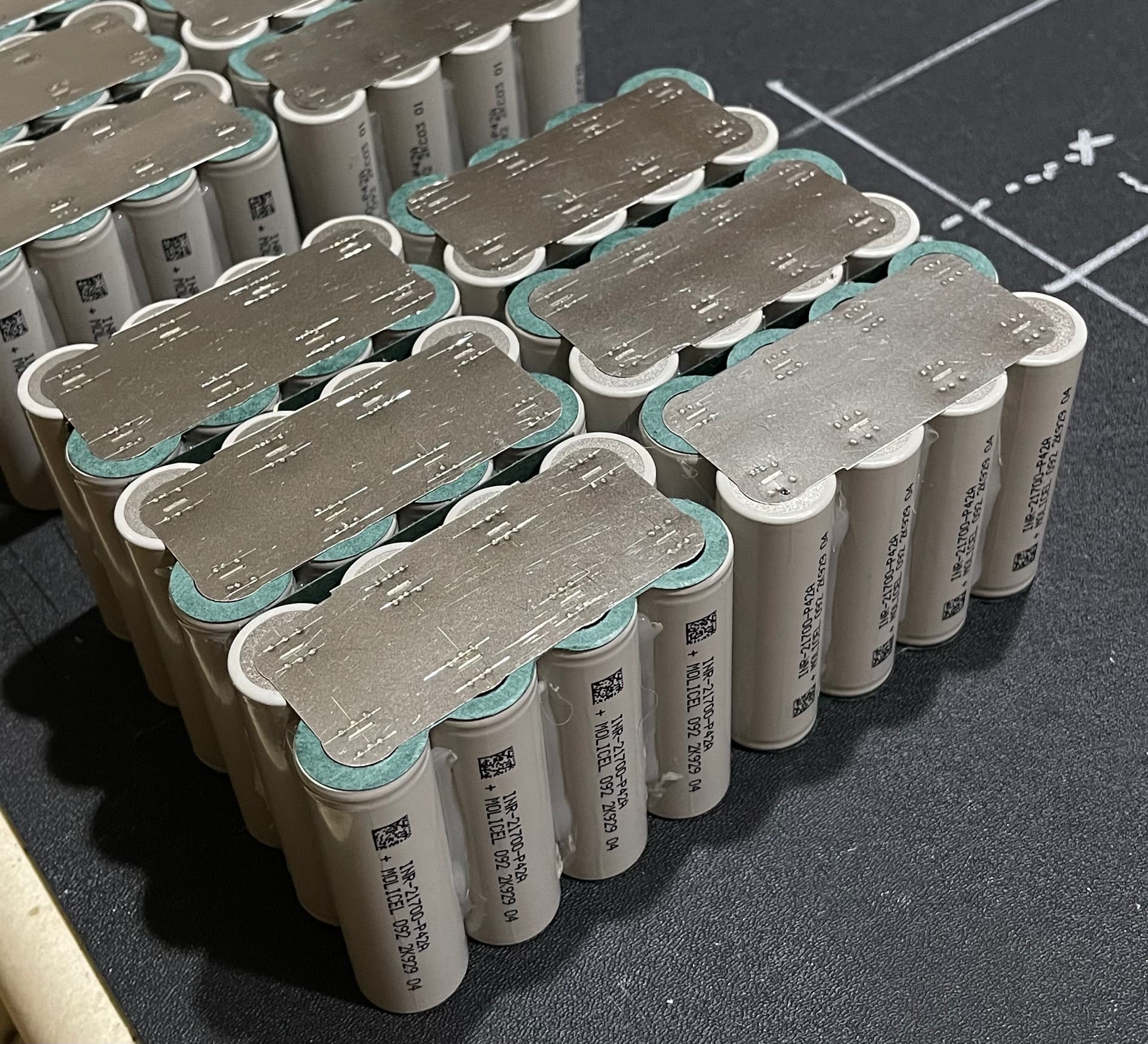

I was experimenting with marking nickel to help make consistently spaced welds.
I used a scribe and straight edge to mark the nickel. Didn’t expect this:
It’s not just a visual guide, it’s a tactile stop and prevents probes from slipping off.
It helps with parallax error if you use probes at 45 deg from vertical. Helps if you have crusty probes that dont have a conical tips. The business end that’s going to do the work will catch the scribe mark and stop.
I’m not saying you should, but you could close your eyes and hit your mark better than I can trying to livestream and weld at the same time.
The machinists who do layout work are rolling their eyes right now.
A pack with and without scribed marks. I used a price of G10 with sticky on it that let me mark two vertical lines at once.
