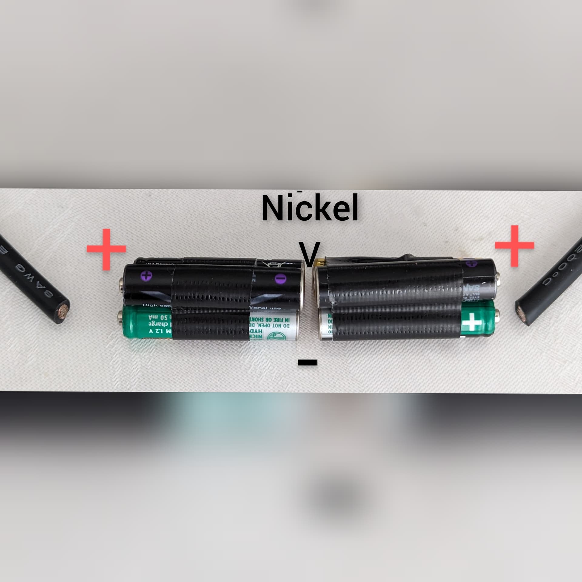

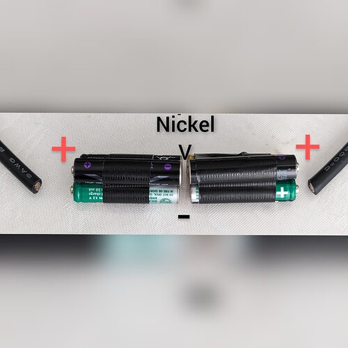

Hi, is it safe to weld a group of six 21700 batteries this way: anodes soldered with nickel, and cathodes soldered with nickel and connected with 1 or 2 8awg wire. Without going into details, this is a configuration I am considering due to space constraints. Thanks

You should NEVER solder directly to a cell. There is no safe way to do it. The heat from the soldering iron will damage the internals of the cell, and potentially cause thermal runaway or an internal short-circuit. It can also cause damage that might not appear immediately, but can increase the risk of your cells exploding sometime down the line, even if your pack ā€œseems to work fineā€ in the meantime.
If you search this thread, you can find tons of discussion about just how bad of an idea soldering to cells is. Please dont do it. The proper way to make connections to cells is spot welding.
Thank you for your advice. I never said I am going to solder directly to the cells. The pic is to illustrate the orientation of the cells.

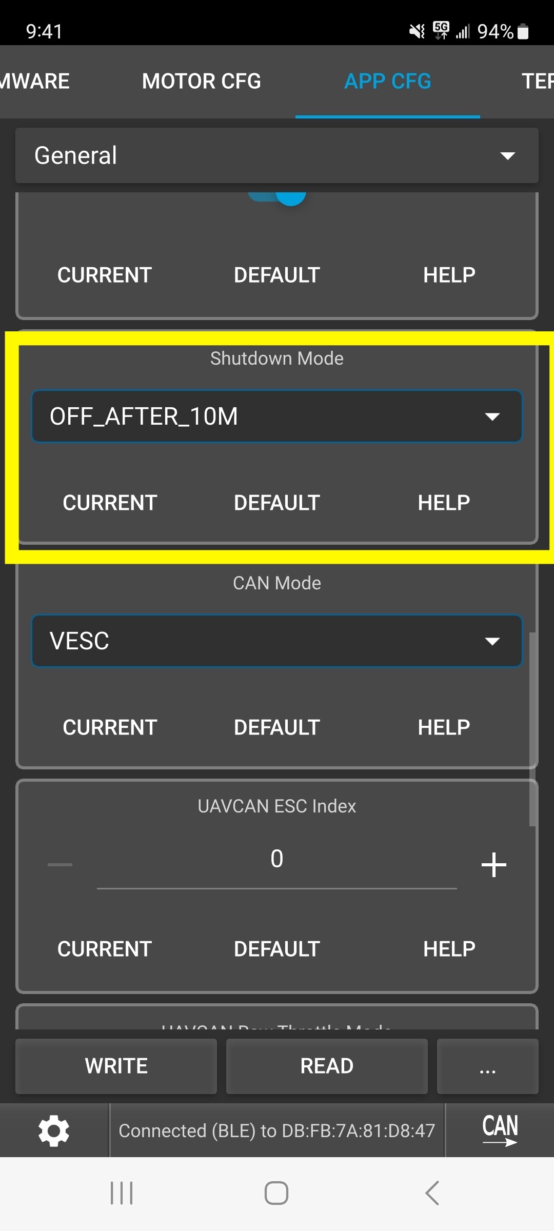

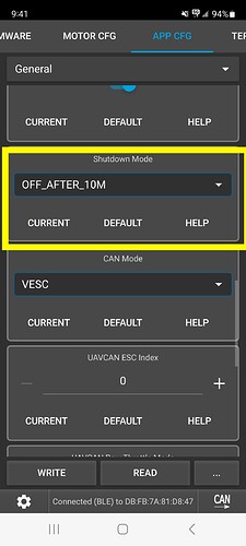

If you don’t have your ā€œShutdown Modeā€ set as below, it’s easy to forget to not shut down your controller which would lead to what happened to your battery.
In any case, I’m not convinced this issue was caused by your pack. I’d start a thread to troubleshoot including whatever logs you have. Would also be useful to post all of your VESC tool settings as well.

I had that setting at 30 mins, I guessing it might didn’t work.
