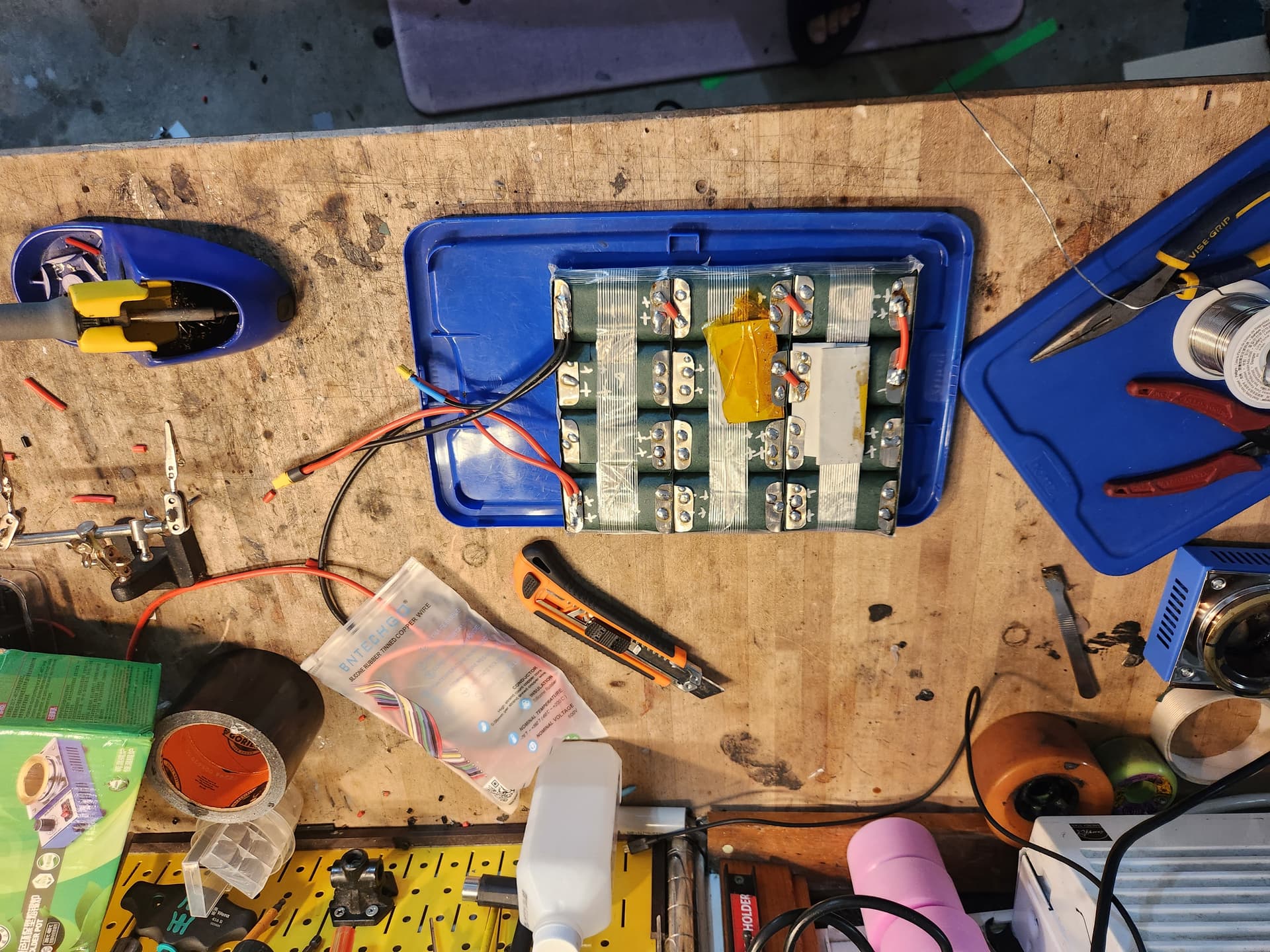

Back to working on my little 12s2p
Doing a single 12awg for the series.

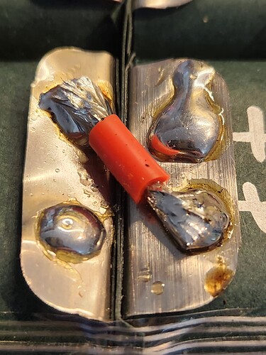

How is the soldering looking?
It looks like some of them aren’t getting hot enough for the solder on the tab to mix with the solder in the wire fully. Flow issues can be caused by one side of a joint being colder than the other.
You can also add more slack to your wires for strain relief.
He looks like he has enough heat to me. You can tell by how shiny the joints are. He’s just not adding enough solder for it to wick into the wire, which wouldn’t serve much of a purpose, though his bridge connection could use a dab more or could be pressed down with something while hot- I use cedar wood blocks. I think they look perfect, especially if he cleaned that flux off :slight_smile:. I do agree about the strain relief.
edit: the bridge connection is the only one that looks a bit cold.

What is this going inside of? You should think about doing the little folded C’s in your series connections for strain relief. The shorter the wires, the greater the likelihood of breakage, even if it’s not going in a flexible deck. This is even more relevant if solder seeps into the wires under the insulation.
I was talking about how this one looks like the wire was smooshed through the solder without really joining it. I’d reflow that one, and a couple others that look similar

Shiny mostly means there was enough flux used, which is good, but not everything
Oh, my mistake, then. Yes, the left side is only shiny because of his presolder, and the wire itself is ‘cold-rolled’ on the left side of the joint, and the right side is dull-grey either because it didn’t get enough heat or because it moved while cooling.
It’s going inside of my Omakase.
It won’t be subjected to any flex.
Just the extreme vibration of a thane build with tiny wheels.
I kept on and put on the little wires
Lots of tape everywhere…
And she is alive.
