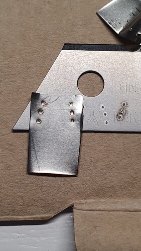

First time using a maletrics spotwelder, how are these welds looking? Using 0.2mm pure nickel with 30ms weld pulse, battery fully charged.
Never used malectrics but the welds look good. How do they tear off? Testing on the blade is good for a baseline, but you’ll likely want to tweak once working on cells
Thanks! Im still playing around a bit on the blade, tested on an old cell and seems I need a tiny bit more energy on that surface. Not all the welds tear off though, normally 2 or 3 out of 6 tear off, so there is a small dot of nickel left on those spots.
Also I started with holding the probe tips perpendicular to the surface but I think holding them both at an angle seems to work better. Whats your experience on this?
I definitely prefer the tips at an angle, i generally aim for around 60 degrees from the welding surface. I also try to keep my probes reasonably close to each other, like no more than 2mm apart. The distance apart will also affect the weld strength
Okay thanks mate will try that :pray:
