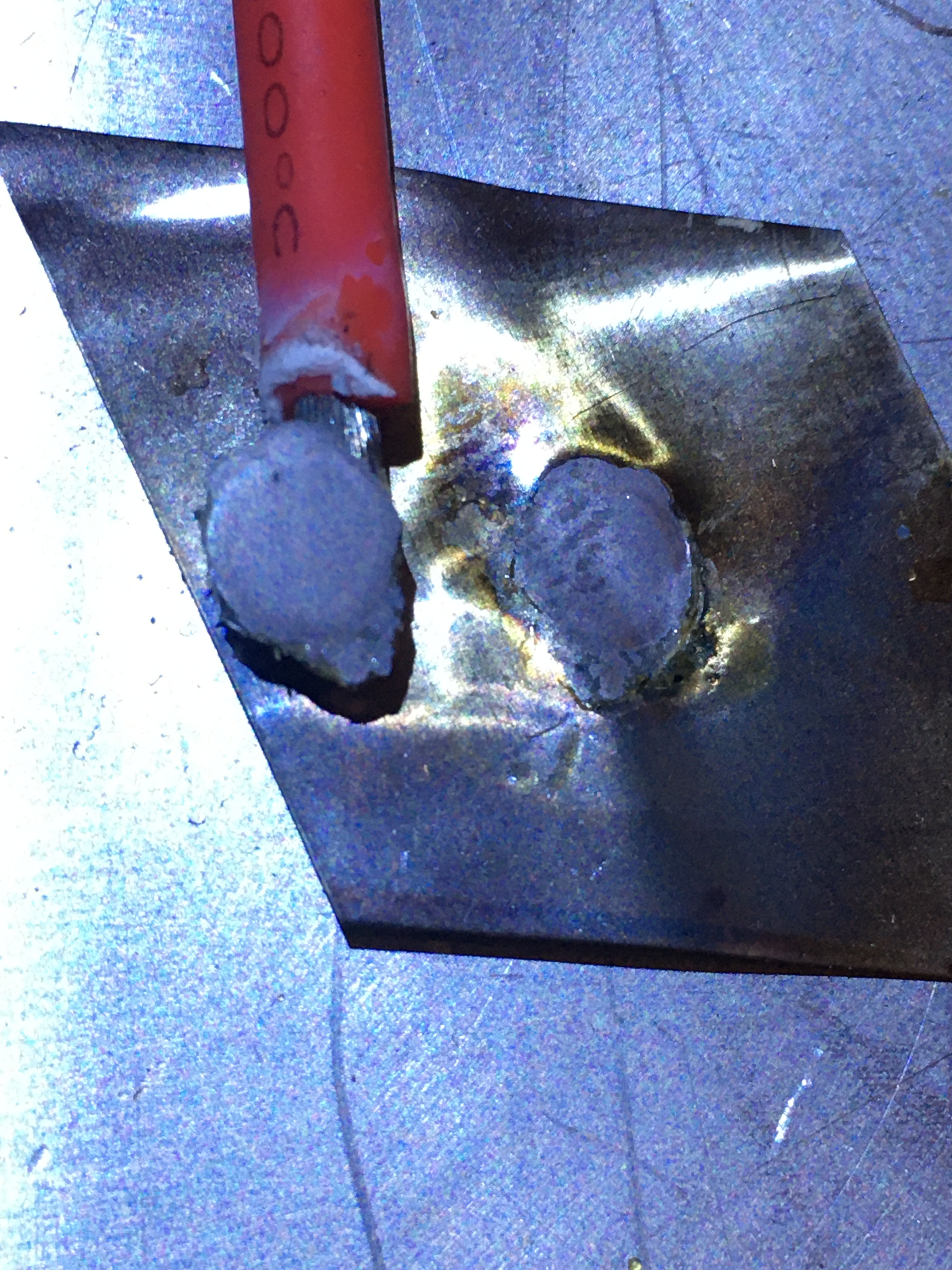

Best way to do that (IMO) is as follows:
  • get the wire soaked with solder
  • put a pea-size dab of solder on the nickel
  • put the wire on the dab of solder and add heat from the top; keep heating it from the top until the wire goes all the way through the dab of solder; all the solder should be fluid at that point
That way you should get a solid joint. The wire will get really hot, probably too hot to hold in your hand. Best to hold it with pliers.
Since you’re going to do the soldering away from the battery pack, you can take your time, which is good.
:raised_hands:
not sure what’s going on here, i have made 2 good joints that won’t pull apart but most of my attempts are like this.
I’m soldering on top of an aluminum plate, could that be taking all the heat away, or maybe my soldering iron doesn’t have enough ooomf?
following these steps
I like ABS for this, nice and cheap and easy to get ahold of. Could of course print something. If it’s getting hot enough to bother abs/acrylic/pla, no bueno…
Are you using flux? 60/40 or 63/37 (not lead free)?
Try soldering on top of wood or silicone or some other insulating material.
If still having trouble, you can maybe scratch the nickel a bit with sandpaper, to help with oxidation and to give some teeth to the surface.
using some flux, and the solder is 60/40 (not sure if it’s lead free), i will try scratching up the surface a bit and grab a brick or some wood to solder on, appreciate the advice!
just tried it on a piece of wood and the solder melted well and made a solid joint,
the aluminum must have been sucking all the heat out of it, thanks!
