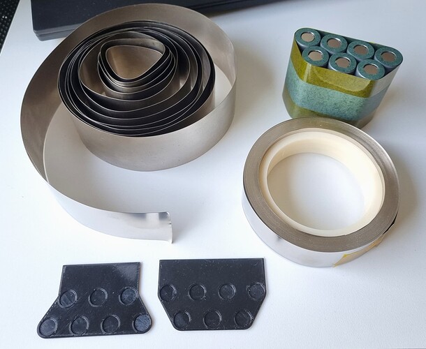

I am building a 14S7P battery out of LG M50LT cells. I have a large roll of 30mm wide 0.2mm nickel, but I figured it would be better to get some 50mm wide nickel in the same thickness. That way I don’t have to weld layers, and it’s easy to fold the nickel on top of the horizontal cells for soldering the series connections.
I ordered the 50mm wide stuff from NKON, and it passed the salt water test. No sparks when grinding with dremel. However, it is quite stiff. It is also a bit springy. The roll in the picture was wound tightly during shipping, and it sprung open like in the picture.

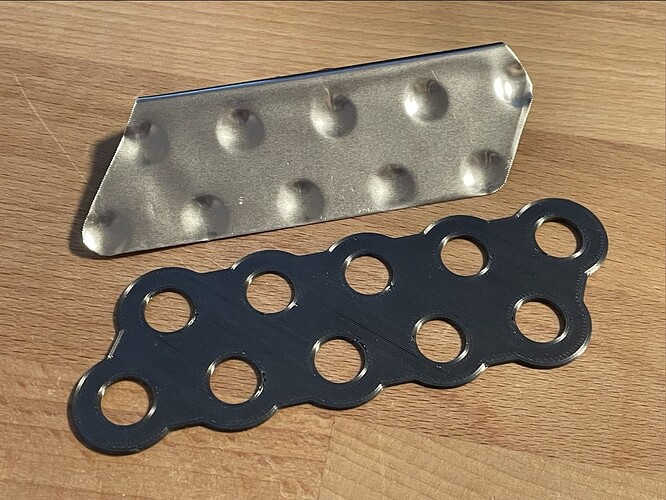

Because the top of the LG M50LT is recessed, I plan to use 3D printed guides to dent the nickel before welding. I can dent my 30mm wide nickel with a fingernail. With the 50mm wide, I need to apply a lot of pressure with a hard object such as a screwdriver to get it to form the dented shape. It’s not pretty.
What’s your take on this? Are some nickel strips just harder than others by default? Can it be that it’s not nickel? I think I can bend it easily enough to allow me to build the negative sides with it. I think that my plan A is to use the 50mm wide for the negatives, and two strips of 30mm wide for the positives. What do you think?
Yes. I believe it comes down to whether or not the nickel has been annealed.
Thanks! I’ll then proceed with the plan I outlined. Two strips of soft 30mm nickel for the positives since I can easily dent it to conform with the recessed cell tops, and a single strip of 50mm for the negatives.

@glyphiks is totally correct, your nickel is just not annealed.
If you are interested in more info, I answered this same question in detail a while ago:
