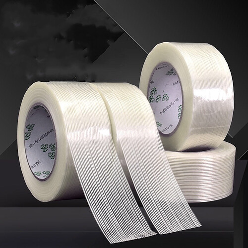

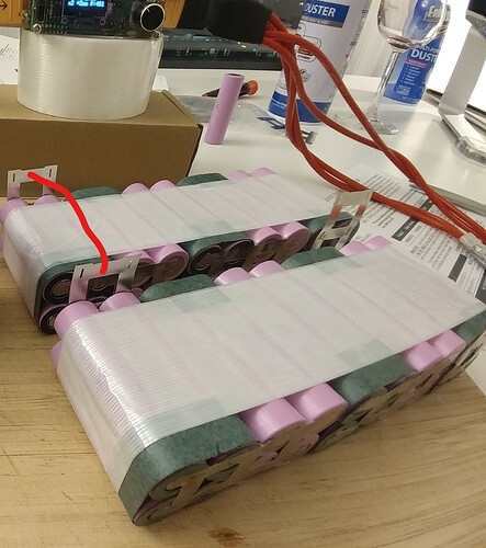

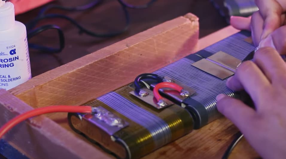

Does anyone know what is the name of the following tapes?
a.
b.
(taken from message 115 here)
the fiberglass tape?
Yes. How can I find it, and what is speical about it?
Filament tape. It has fibreglass in it and is very strong.
I got mine from aliexpress, and it’s just very strong tape. You can’t tear it.
