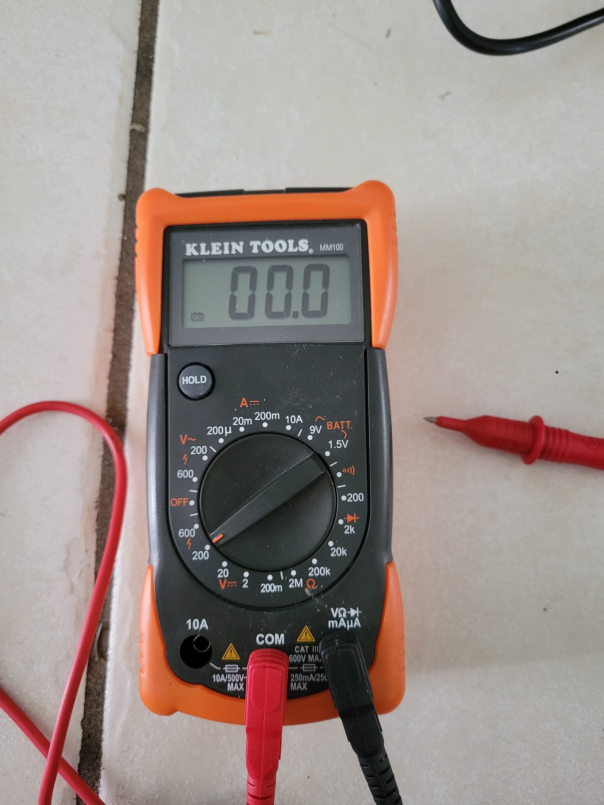

@ceasium can you measure the voltage at the charger leads with it plugged into the wall

The charger is saying 43.3v also.
I have a second multimeter to test the voltage with.
Just to double check this is on the right setting?
yep, and your charger seems to be faulty. not sure why your BMS didn’t cut off charging at max cell voltage though so there may also be a problem there.
youre gonna haver to adjust the voltage in it. its really strange that the bms didnt cut off charging.
anyways, if you have your esc and motors, plug your esc into the battery (itll spark without an antispark connector but its fine), run motor detection, and either in the vesc tool app or with a remote keep the wheels spinning till it drains below 42v. You shouldnt store the battery at full either but thats not the end of the world.
The new multi meter is saying 41.6v.
