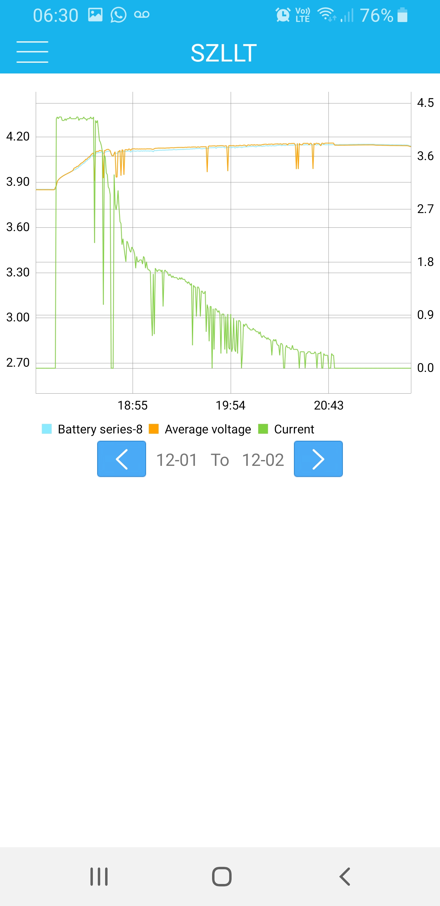

@Darkie02 my bms is wired correctly. The balance connector is upside down, hence the reversed numbers. I took this bms from a working pack, I labeled every wire and position before removing it from the old pack.
That’s either a faulty bms or pgroup. Since it’s only happening on 1, I’d turn towards a faulty bms.

Verify that touching any wire doesnt change anything. (IE: touching wires badly soldered could disconnect and would show up as dead in the app)

Interesting, I’m pretty sure my pack soldering is ok, I will open it up if needed but would not be happy if I split it and it was a faulty bms!
Just looking at the S charge graphs, looks l9ke it was only S pack 1 that exhibited the red bar.
Dont think a dead pgroup would react this way. Do you have another pack you could connect the bms to?
I do have another but wasnt planning on chopping into it as it’s in my other board. But it sure would tell. Good shout.
Thinking about it, I have another new llt bms too, maybe I’ll try that first…
