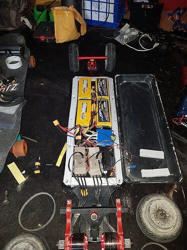

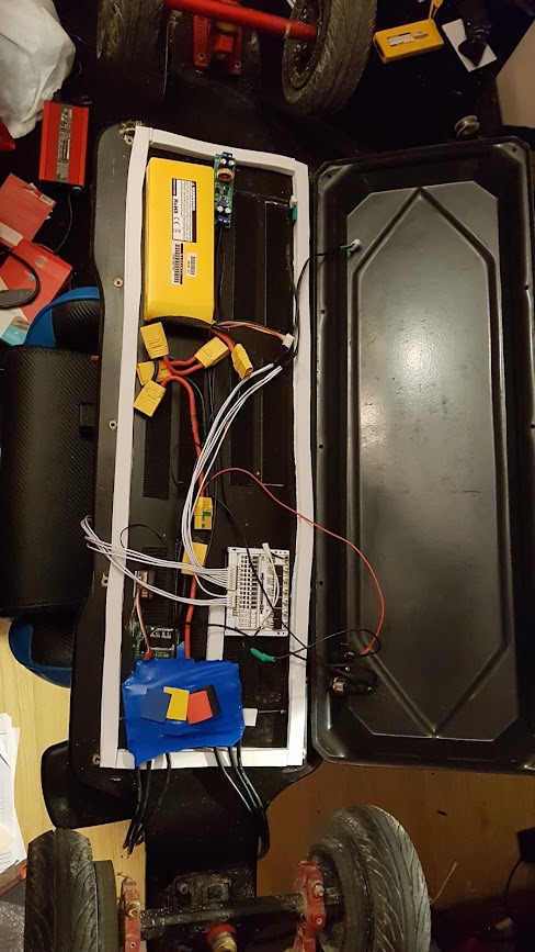

I ran a build with original XT90s on the batteries with complete disregard to inductance/resistance in the lines and it ran smooth at 12s on glorified 4.12s and then neoboxes logs show about 1.5V of drop on 45V @ ~85 battery amps and I imagine a majority from that is from the cheap LiPos. Ran for 2500km before being run over by a car and “decommissioned”
(old pictures, forgive me)
Yes, I shamelessly copied your design. Same enclosure, same configuration, same cases. What else can one do? :smiley:

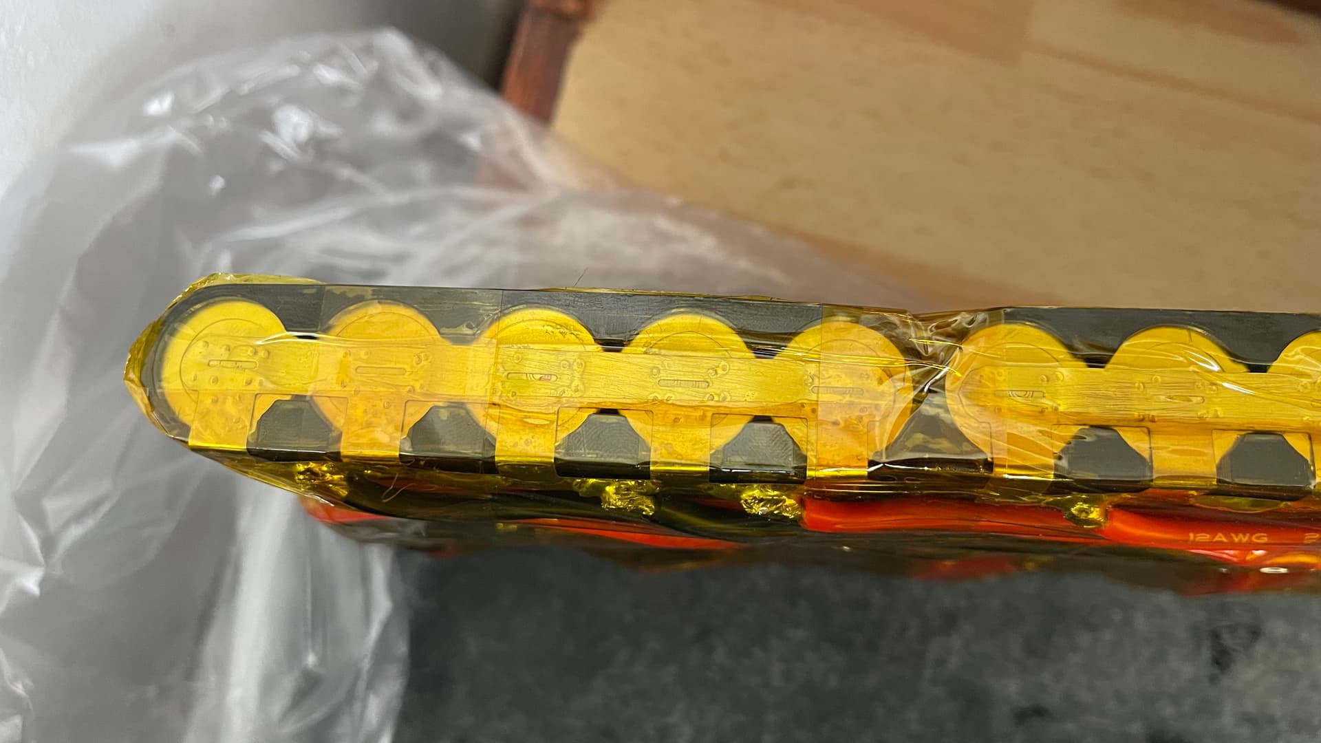

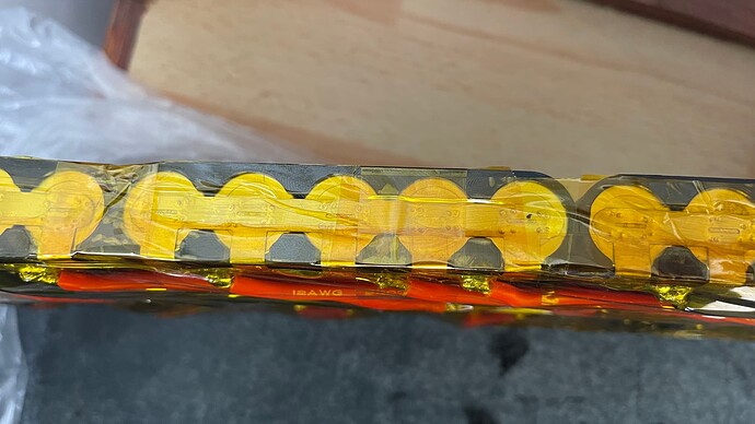

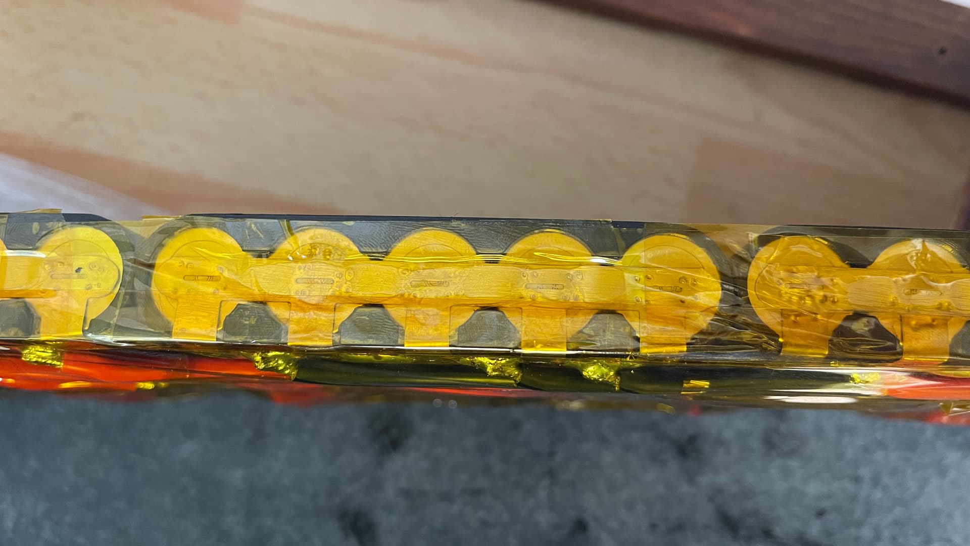

I am aware that the wiring that I used is an overkill, but this was kind of intentional. Since it is my first build I decided to add some margin for any errors that I might do. I already learned that AWG 8 is a pain when it comes to soldering XT90 on it, but I somehow managed to do it.
The reasoning behind 150A fuse it that is should never ever pop under normal circumstances. It is just there to save the battery if the ESC shorts or something like that. At which point I won’t care about ESC or any other part. The only thing I care in such scenario is battery not going up in flames.
The plan is to use shrink wrap for sure. I will do a few test runs and when I am confident that the pack behaves as it should I will wrap it.
Unfortunately I forgot to make photos of the packs after welding so I can’t really show that. I was able to get a few photos from the side of the pack, but these are just the negative sides:
On positive sides I did use insulation rings and was careful not to weld over them.

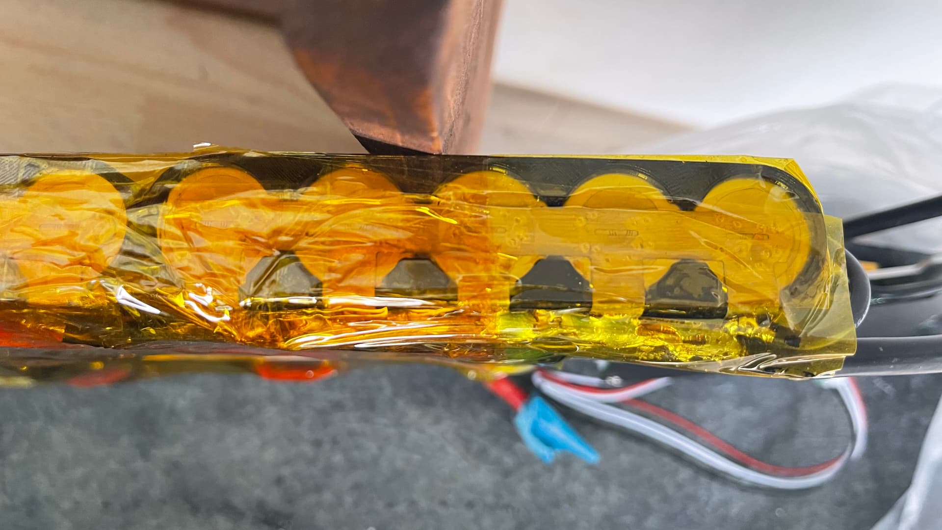

The spots look a bit cold, did you do some pull tests beforehand?
I did. I was using 30J setting on kWeld.
