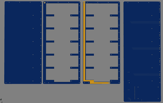

So i’ve designed a circuit board system to eliminate this issue. (This is where it gets exciting hehe)
^ View of the 4 from the front ^
^ View of the 4 from the back ^
The principle behind this design is to be a 4 layer stack of pcbs, held together with standoff’s.
The layer with the BMS goes at the bottom, and the pads to the right of the bms are to use the original BMS wiring harness cut short to go straight up into the bms. The holes on this board are lined up with all all other layers.
Layer 2 and 3 are designed to hold the batteries inside them. All exposed traces will have their current capacity increased with lengths of 3mm copper rod, and insulated with kapton tape. The ends will be where the batteries connect, with an XT90 (one pin of the xt90 on each pcb)
(i really hope im making sense here lol) Longest PCB is 185 x 499mm
The bottom of the bottom PCB will have the BMS Mounted to it, and has cable tie holes for the BT module to be mounted to the side with double sided tape.
The pcbs will be spaced with standoff’s to the appropriate widths so that the far right pcb can act as a lid, so that i can keep the batteries on the circuit board, but just unplug them, hang them out of the enclosure and insulate them as i want to take them to germany to visit my Oma and @City-Blade-101 when the world opens up again.
I also want to take it flying with me so i have transport outside of small airports when i go outback.
All the batteries will have cushioning foam around them, as well as velcro below them to hold them tight. Overall thickness ~43mm
I will be having a 12s charger hopefully at 15-18a (nano techs are great like that) so that i can get as much range as possible in the least amount of time (this will only be for longer rides…like this one ).
For normal charging, it’ll probably be like 4a or something easy.
From here, i will design a heatsink that will hold both the buck converter and my esc’s so that they can both run nice and cool. The main leads will be either 8awg or 10awg cable, as im setting this bitch right up to 80a battery amps each side straight away lol.
I’m yet to order the circuit boards from JLCPCB (MOQ of 5 of each board…ouch…anyone want to buy one…?), however i’m fairly certain this should all come up great
What do you guys think? Any suggestions on cool shit? i’m all ears :call_me_hand:t2:

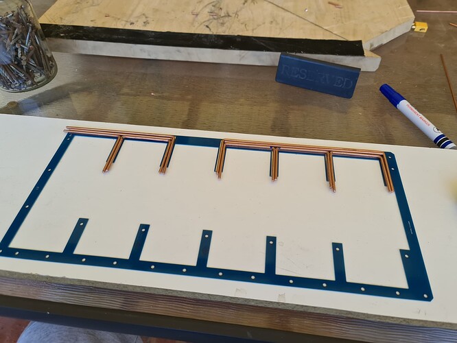

So the pcb’s came in and they fit!!! Next step is soldering on the Copper and balance plugs! So excited :grin::grin:

Alrighty so an update
The coppers on the pcb, the standoffs are in and the pcb is insulated, and pretty much ready to go.

No, Thank you for posting. I am at a fork, cut leads and shrink wrap into a 12s with multiple balance leads poking out, or do close what you did.
Look, my way is a bit of a fuck around, but i just hate cables :rofl: also hope you have a strong as fuck soldering iron, as the copper dissipates the heat in long lengths really well
if i were to do it again, I’d have made the pcb only with pads at each point to solder to so that i didnt need literally a whole roll of solder lol
