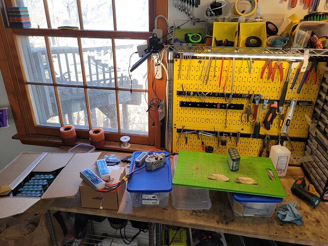

here is your friendly reminder to double check you can spotweld your nickel before doing a bunch of work.
I know this.
I didn’t do this…
this was 0.2 x 50mm i got from Ali a long long time ago.
I am sure it did fine on the salt water test…
so yesterday in spent a ton of time cutting, sanding, soldering, and cleaning for my 12s9p BAK Pack.
and got started welding…
and immediately realize oh no. this does not seem good.
first attempt popped right off…
I think at some point in cranked Malectrics up to 45( usually around 30)
and no go.

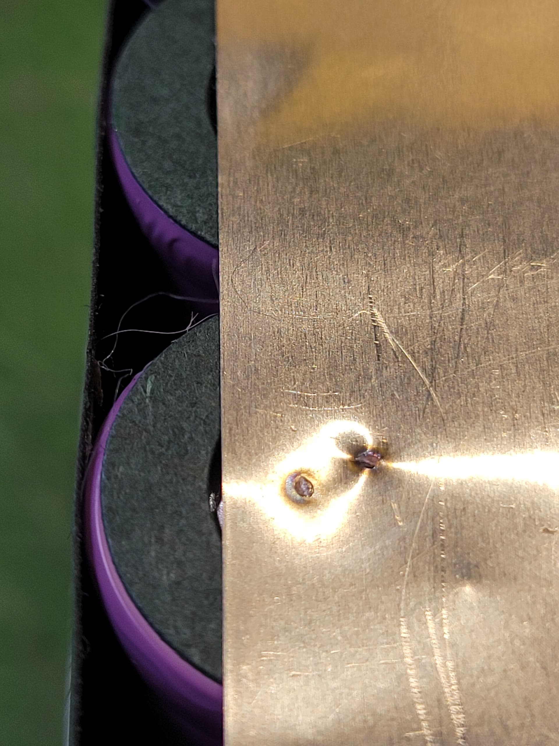

here is what 32 does on normal nickel.

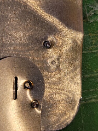

and here is what it does in my paperweight roll…
Well, is it steel then? Because then it should weld even better. Or is your welder broken?
Or is it thinner an advertised
but then why would he crank the welder up… I’m kinda confused what the problem here is tbh
