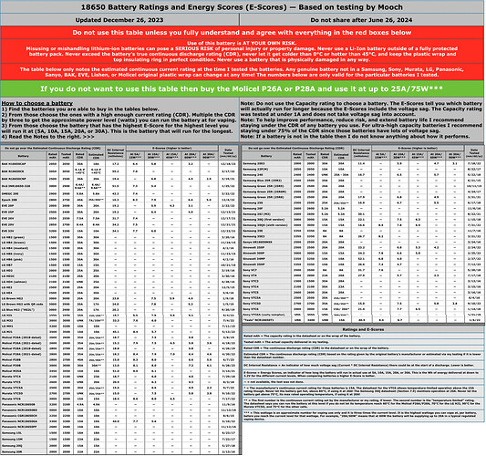

Moochs e-Rating is about the same and the as expected 30Q last more Ah than the P26A
only thing i see is that P26A has less initial sag and is about 0.1V higher (does this make much of a difference?)
wait
in a 12S pack 0.1V adds up to 1.2V sag
But that just means i don’t have the same top speed?
sry, quite some time since i last looked into batteries
The p26a delivers as much energy total as a 30q at 10 amps, more at 15 amps, and can be pushed to higher currents. It is also much cheaper from what I’ve seen. The 30q may be better below 10 A, but it’s still much more expensive and most of the time we’re looking to use more power than that.
On the escore table, the p26a beats the 30qs at 15 amps. 30Qs have an unbearable amount of sag at 15 amps compared to the tolerable amount of the p26a.
In terms of usable voltage, when your battery is lower, the 30Qs are gonna sag down to the soft cutoff of your esc much earlier than the p26a. You’ll have more usable power on the lower end.
Not to mention how bloody unreliable 30Qs can be. Dead cells, really quick degradation, inconsistencies make them a pain.
I think the main thing is that energy, which is what really matters in the end, is basically the integral of this curve. Being higher for most of the curve outweighs the little bit at the end.
