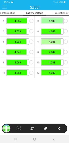

Hi guys. I’m after some advice please… This 12s10p 30q pack is about 2 years old (heavy use), and now does this when charging - One bank gets full early so the others never get a full charge. When riding it levels out and stays level until drained (so doesn’t feel too dangerous). Dodgy cell i assume? As they’re old cells i guess I can’t dismantle and replace it with a new one. Am I limited to rebuilding the pack as 12s9p without the dodgy one? Thanks!

Yep, probably one cell in group 2 is giving up.

30Q…
After 2 years of heavy use on a 30Q pack I’m not surprised.
I’d start your balancing at a lower voltage and try to make your battery as comfortable as possible during its final season

Try starting your balancing at 3.9V or 4.0V and slow down your charging a LOT so there is less voltage rise during charging (which fools the balancer) and to give balancing more time to work (if it turns off when charging is done).
If possible, try turning on balancing when not charging too…just until the pack is balanced again. Stay close the entire time any charging or balancing is being done.
