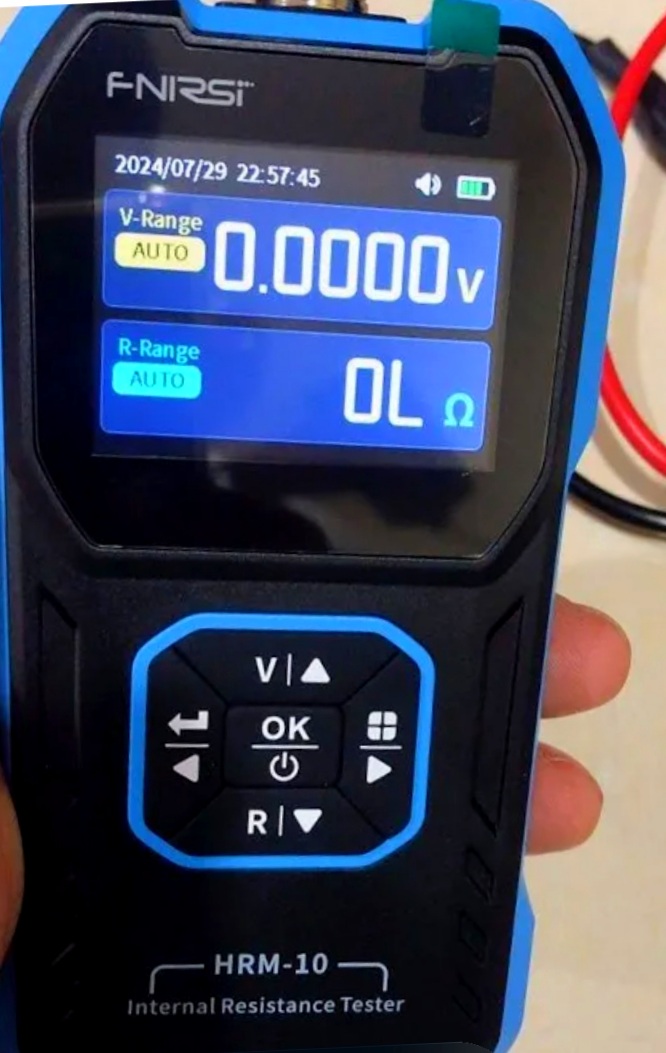

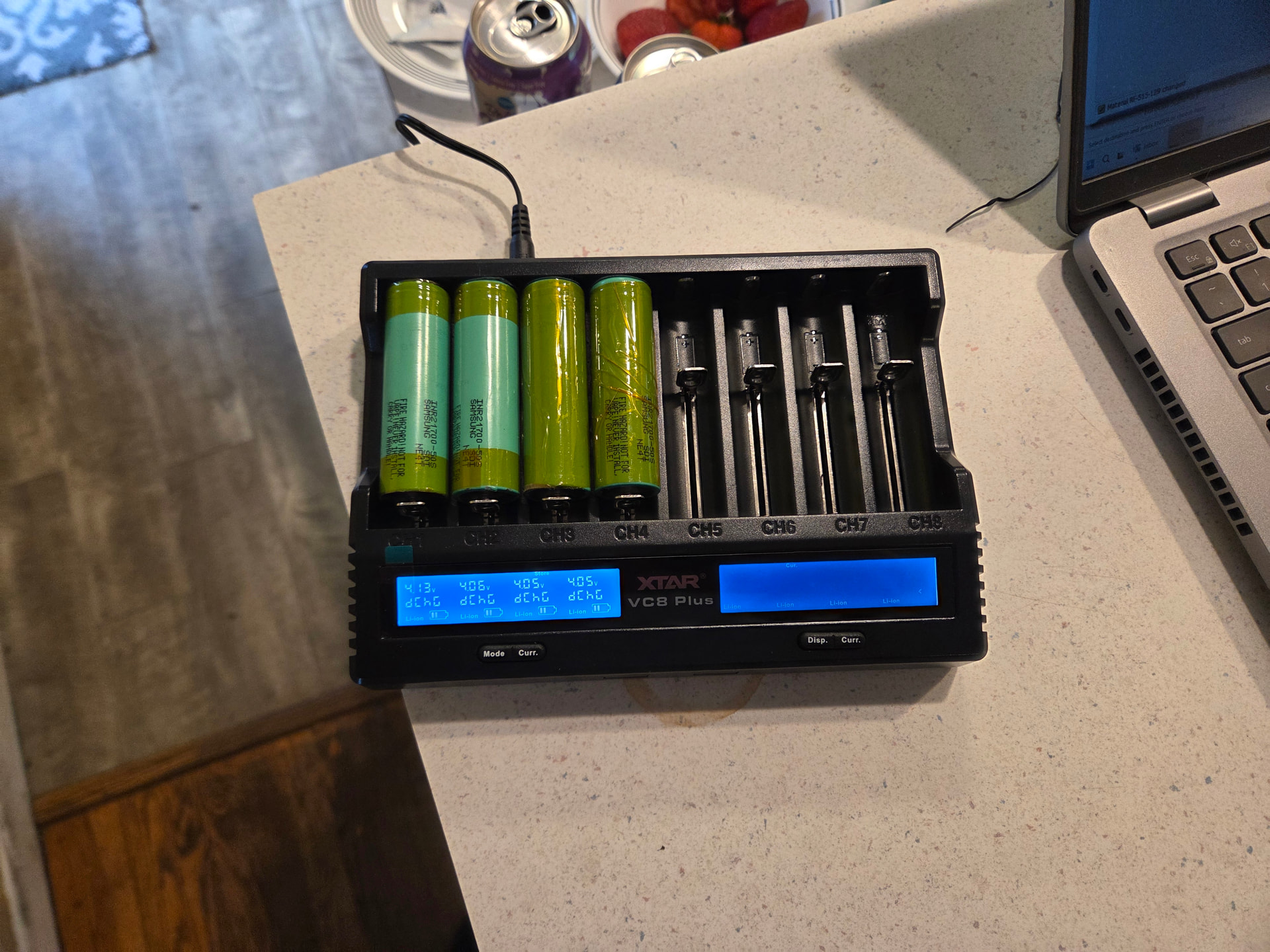

Appreciate it.
I would prefer to do a process that is relatively quick. So the long term discharge is not desirable.
And I don’t really plan on recycling a bunch of cells…
This is such a small pack that the cell cost is not super high…
I’m more so just trying to make use of these Cells I have laying around rather than dumping them off at Lowe’
I feel like the VC8S will be useful to have around and expect I will keep it.
I also ordered the HRM-10 to check out.
But I am considering sending it back.
Self discharge becoming more obvious more quickly at 2.8v instead of near nominal voltage is a great point.
I was thinking used cells and a 4 decimal voltmeter would potentially yield results in a few days.
Agreed.
I use full charge instead though. It offers the same degree of voltage swing for a charge loss, is easy to set up (just charge and leave for 1-3 days before measuring starting voltage), and the self-discharge is faster. That makes it easier to better sort cells and/or have a shorter test period.
If a decent, high-precision and consistent meter (accuracy isn’t as important for comparing cells) is available, the HRM-10 should work great, then a week is typically long enough to start sorting out the crap. Then check back in another week to start sorting for p-groups.
Just a couple of data points…I had high grade 50PL’s that only dropped about 180uV-200uV a day but some lower grade China junk that was dropping about 7mV a day.
It’s critical to wait at least a day after bringing the cells to whatever voltage will be used so they can settle to their true resting voltage. Three days is much better as the 50PL’s needed that, otherwise their “leakage” would have looked like it was up near 1mV a day.

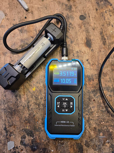

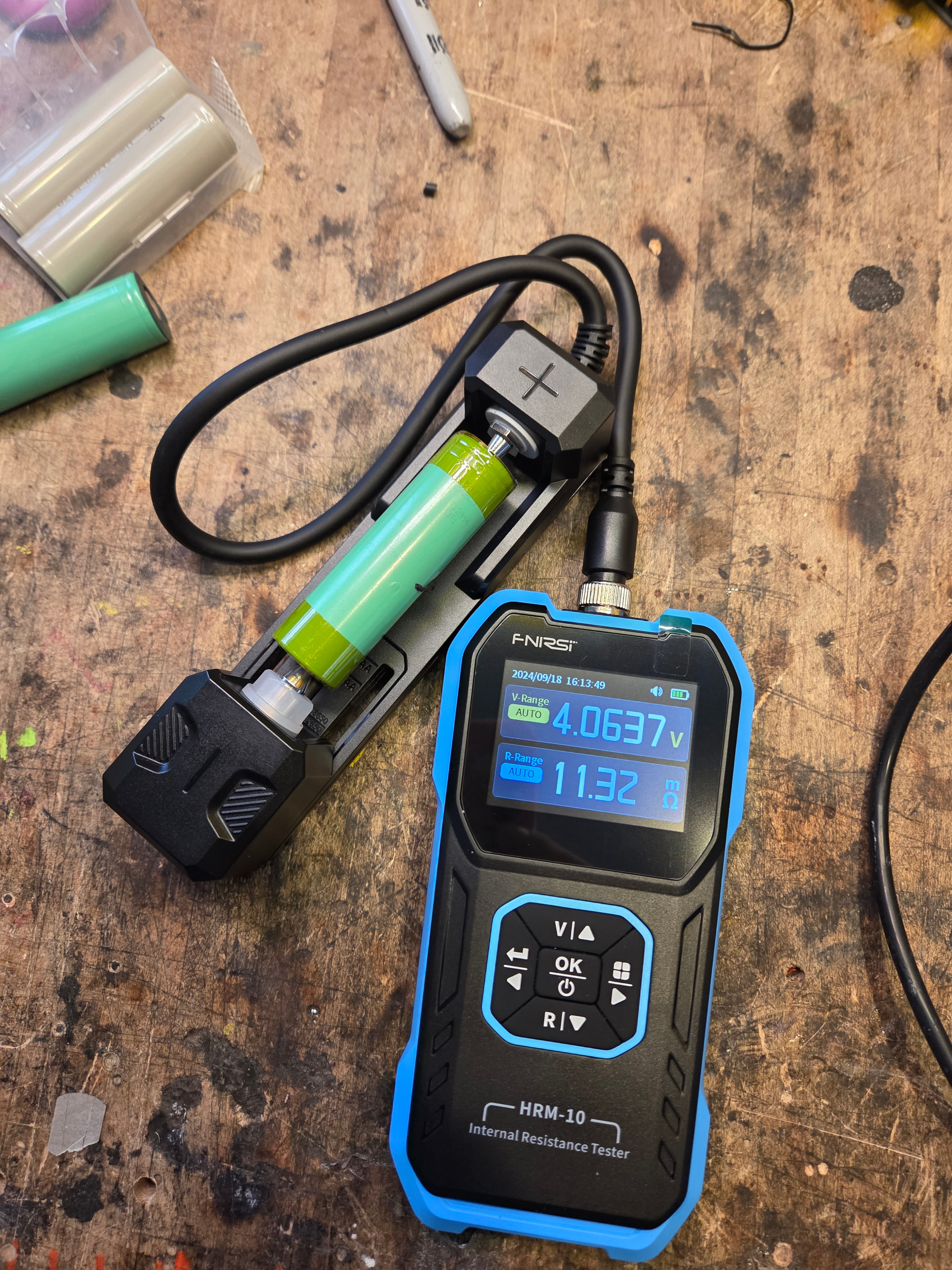

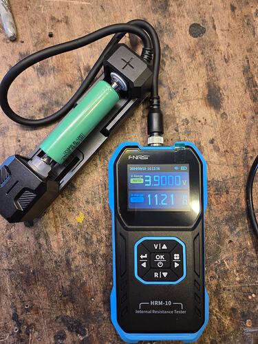

The right Tools are nice to have!!!
Discharging to storage voltage.
And I have not checked all the cells.
But at a glance the used Samsung 50s look viable with about 11 mili ohms

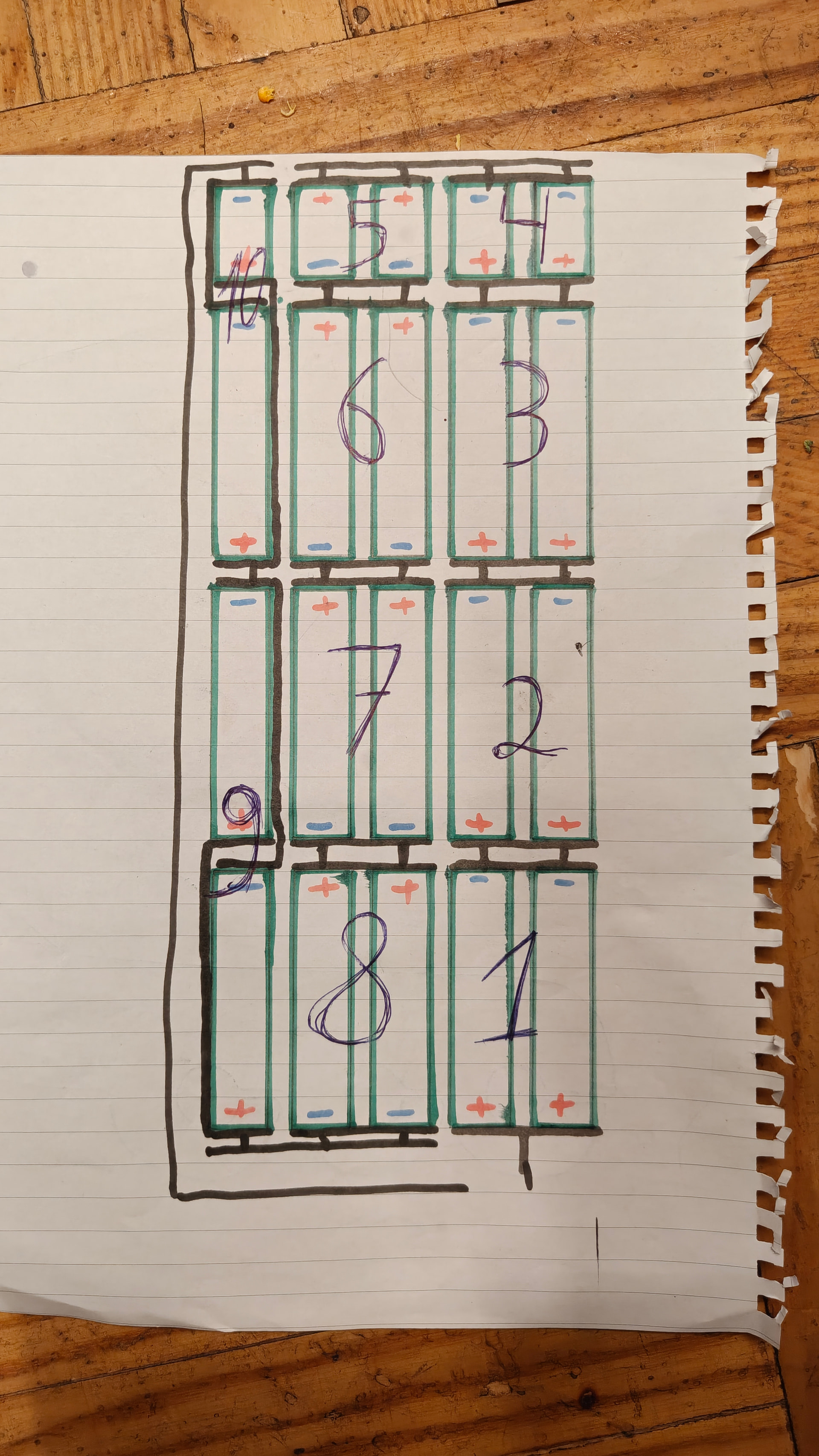

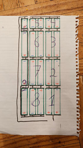

I have built this battery before and was very unsure when, as well as I am not fully sure now. I have a space for battery that fits 5 wide x 4 long cell. Is this a good way to make those side P groups? The battery has to be 10s2p, so no way around it. The other 8p block is made.

What’s the actual space you have available? Split groups like that are no fun
