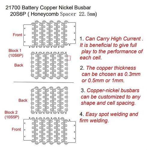

I wonder how well the centers line up on the cells, when there are long P groups, as most 21700’s are growing in thickness, and center to center distance is also growing.
21.3 and 21.5mm is not uncommon, and if one places their cells inside digital calipers and spin them, they will find the cells are not perfectly round either.

I can see this oversized inconsistency causing a premade busbar to not align very well on say a long 10P pack, especially if one is needing to avoid the 6mm center of the cell.
I like the Idea of 0.3mm copper series connections and easier to weld nickel plated copper( on one side, pre-sandwiched) on the cells themselves.

So these wellgo busbars seem to be a great option on packs with more compact P groups, and/or for those with spot welders of limited power.
I can see them being a real time saver on many brick style builds.
The wellgo give a bit of room between for fish paper or more.
They definitely make building easier n faster and barely take much power to weld. I’ve gotten them custom made but getting the pre-made sheets you can cut would save bucks
Wellgo has been very good to work with and has had very reasonable prices for what I have been working on with them.
I had them cut almost 40 custom 300x50mm, .2mm copper strips and they were delivered by air for under $100.
I think all their stuff is at least .3mm copper

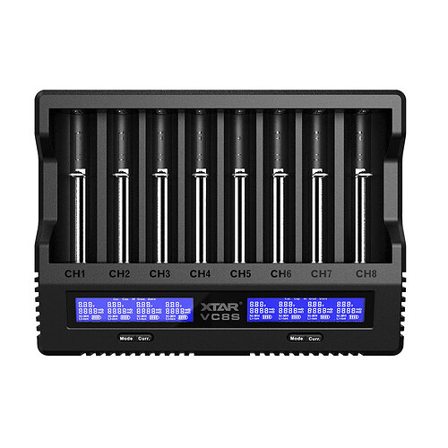

Has anyone used one of these 21700 chargers to check battery health on used cells.
XSTAR VC8S
Im looking to repurpose some Samsung 50s cells and I’m wondering if this could in fact help me pick healthy cells???
These chargers do display a mah figure after full charging and discharging a cell, but from what i read they tend to be generous, and the same channel might always read a bit high or low.
The capacity delivered at the low discharge rate of the charger might mean very little in a higher discharge rate application that has a hard cut at 3.0v opposed to 2.5v

So I ordered the VC8S because it has 4 slots they will bring it down to 3.7.
So it’s still going to be useful for me for that purpose.
But are you saying that the ā€œgradeā€ I get for the cell out of it may not be very helpful?

I am not sure of charge / discharge rate of that charger, so it could take many hours to spit out a mah figure. it might also display resistance, but from what I have read on budgetlightforum, this is also suspect on some models but i don’t recall which ones.
That mah figure is good to compare to all the other cells, and eliminate the outliers from contention.

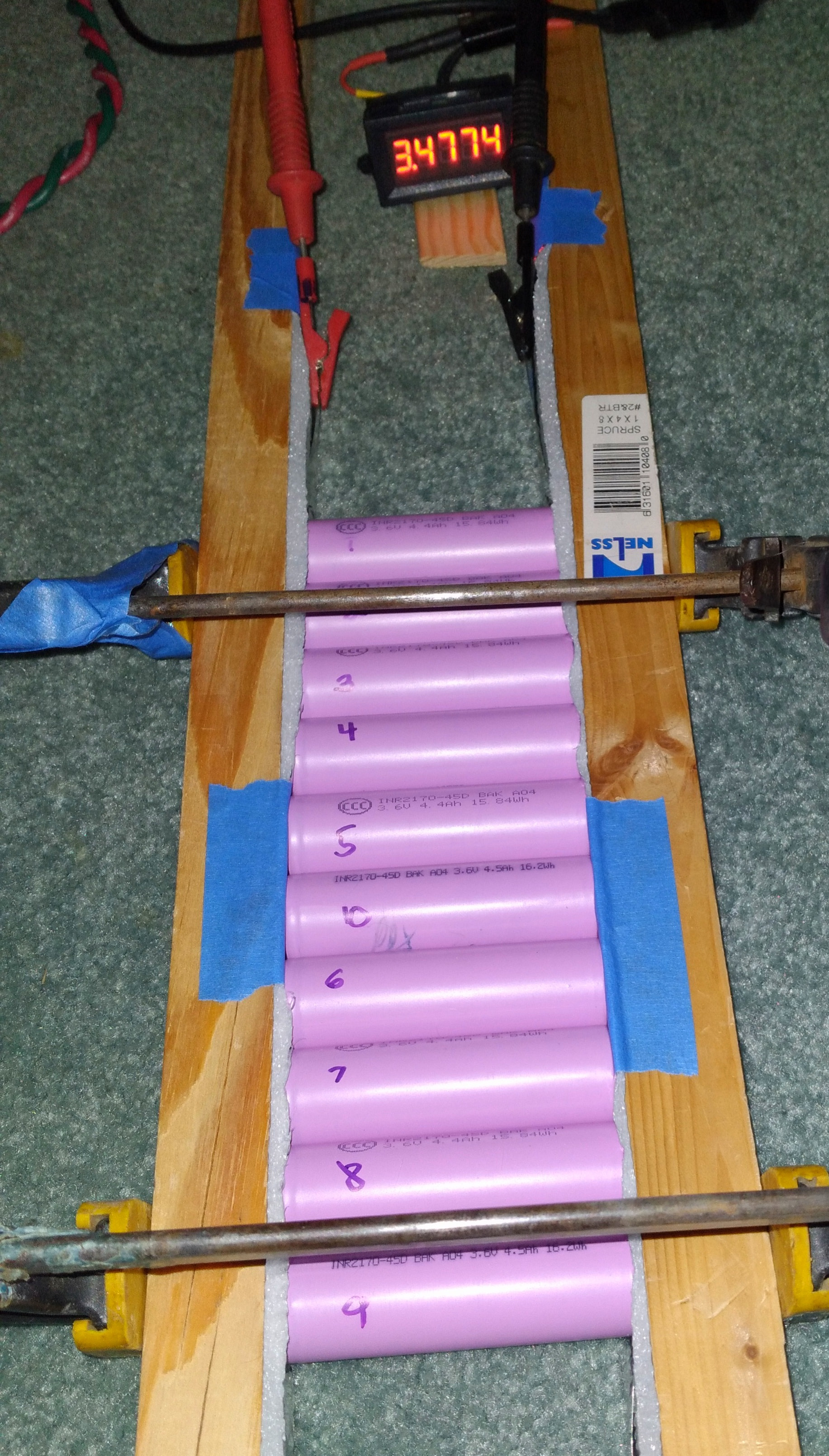

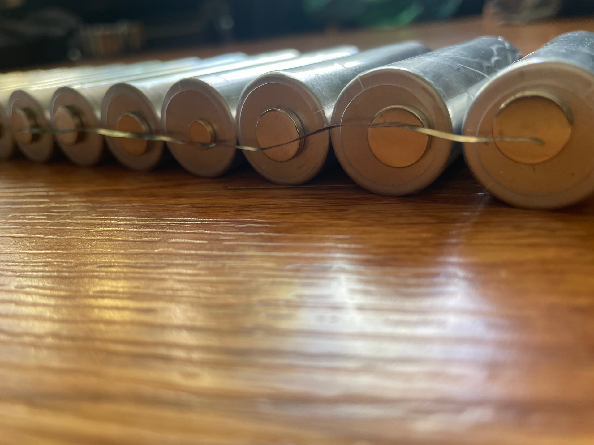

I use a simple jig to parallel all my cells for 24+ hours to get them all to the same exact voltage.
This is just some nickel plated steel strip taped to easily compressed Foam taped to wood straight edges, then clamped.
I do add fishpaper rings first.
After 24 hours in parallel, and they are all balanced to within 0.0000 volts, let them rest for 24+ hours. If any lose voltage faster than others, remove from contention.

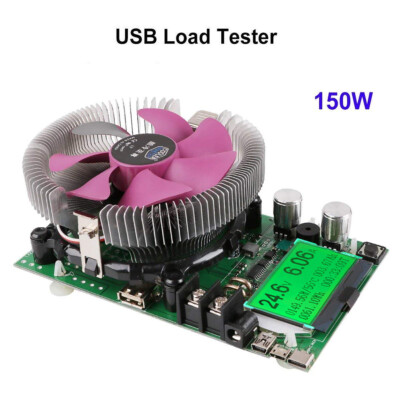

A load tester is another method to judge the health of a cell, but it will be time consuming to test 20. At with least a load tester one can crank it up to 10 amps, closer to the load the cell will see in actual intended use. If you are expecting to see 4200mah from the a new 50S at 10 amps continuous, then 3800mah from a used one is still pretty good, but if it is down at 3360mah/80% of what it was new then it might not be worth the effort of building into a 10 amp application.

The only real way to do that is to charge and/or discharge the battery. That is what that charger does. You can also buy cheap stuff off amazon. I’ve got something like HiLetgo Battery Capacity Meter Discharge Tester Analyzer 1.5V-12V Battery Capacity Meter Discharge Tester - Amazon.com , and it seems to work well enough considering it’s super cheap. Effectively, it just discharges the battery through a resistor and measures the voltage as it goes. You set the start and end voltage. You can adjust the rate somewhat by changing the resistor, but the unit is also limited. Also, a better version would ensure constant current, but that would complicate it and make things more expensive. That charger may operate in constant-current for discharge. I partially bought a couple of those things just to have a controlled way to discharge batteries.
Internal resistance is measured by sending an AC signal, usually 1 kHz, through the battery and measuring the resistance. You can’t easily measure the DC resistances of something that already has a DC voltage and also can store and provide energy. That charger also claims to measure internal resistance, but how good it is is probably pretty questionable.
IMO, if you aren’t planning on recycling tons of cells, then getting that charger and making your decisions based on that is probably good enough. If you’re super concerned, your best bet would be buying new cells unless you’re doing this all the time. If you were trying to recycle cells on a mass scale, better tools would be worth the money, but that charger can give you some information, it isn’t that expensive, and it has multiple uses.
