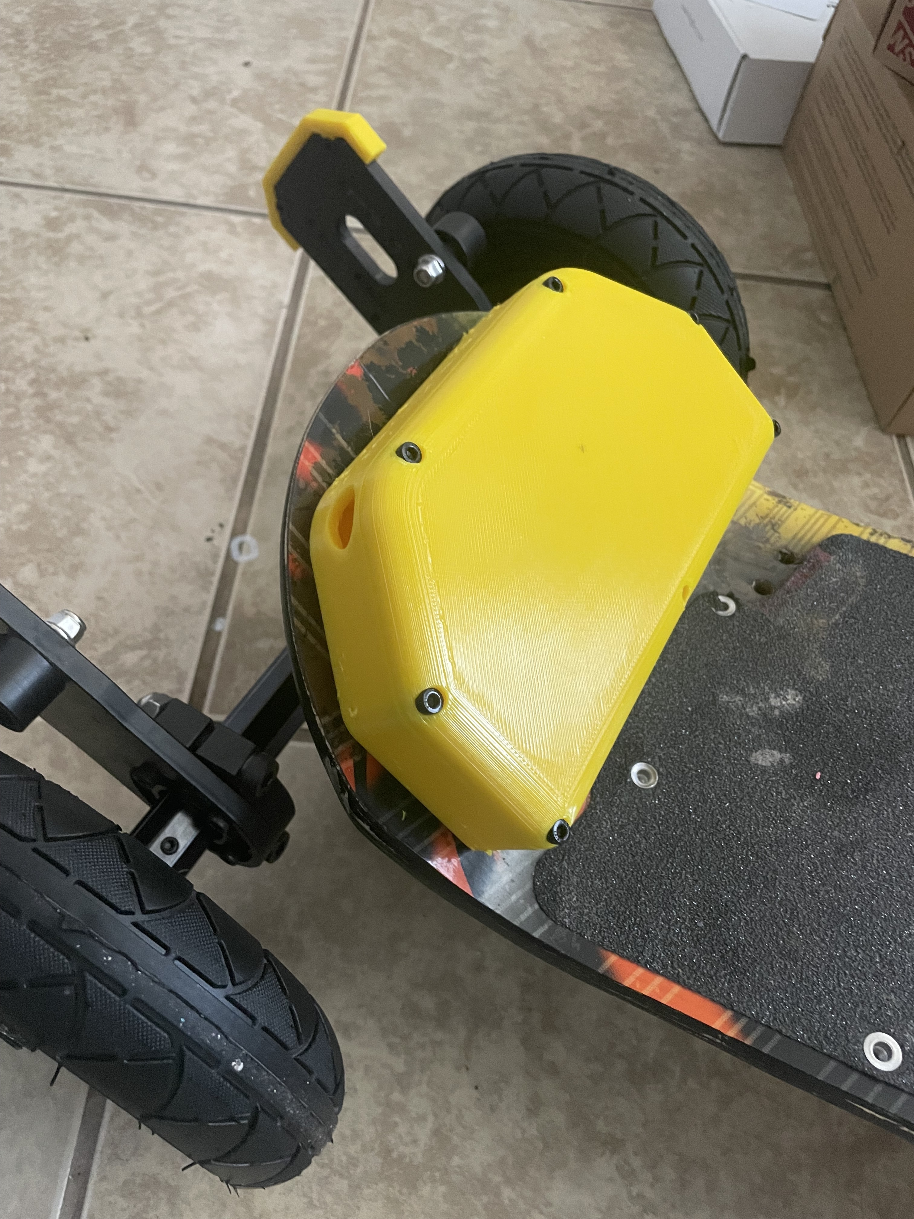

I got laid off about a week after I took those photos so it gave me A LOT more time to work on it. I printed out a vesc case and some bumpers and started to think about what I wanted to do for a battery. I have a flat 12s4p battery laying around but I would have to cut up to put it in a top box so I forgot about that. I ended up going with 2x 6s 20Ah Turnigy packs after seeing a lot of folks running those. I got em on deal for about $300 delivered, so all things considered I am happy with them vs liion.
I ran them in series thru the top with a loop key. I wanted to keep it simple and easy to change for when I want to inevitably change it. I bought the case off amazon and the fit is so perfect I did a flip when I put the batteries in.
Both the battery and vesc case are held on with good ol 3m VHB tape. If you have never used it before, use it. It’s like glue for tape. And before you tell me why not to use it. It holds the roof onto my pergola in my yard, I have watched this stuff day in and day out for the last 6 years holding it on doing great.

Nice build dude! Congrats on your first mtn board build
That vesc case is slick, a custom design? Does it get in the way of your foot at all?
VHB is king🤙
I tried to do something custom, but didn’t have time at the time. That is one I found off thingiverse. So far so good doesn’t bother my feet at all. (Size 12 usm)
