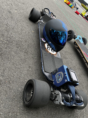

Raced at Electrify Expo San Francisco. Really proud of my performance, finished 1st overall on Saturday. Was a hell of a weekend, had an absolute blast. Few months later, and it’s still surreal.
The only way this was possible was Reggie and Mario crashing into eachother twice in the same race. Still chasing a fair win against those two :blue_heart:
Following EE San Fran, I was in 3rd place overall in Mod and Pro.
But with @poastoast’s great performance at EE NY he pushing me off the pro class overall podium
Thrilled with 3rd in mod though :tada:

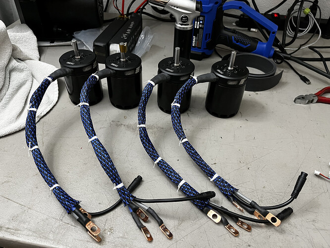

They came with 4mm bullets, but those won’t work with my G300s, so off they come.
Out comes the hydraulic crimper
All tied up and ready for install

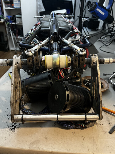

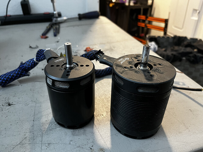

Rear Replacement
Crazy amount of dirt from inside the pinion
Old vs New
I took the chance to turn my extra collars 90 degrees.

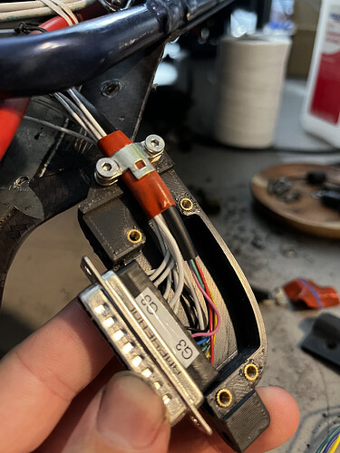

The 6484s came with a waterproof sensor connector, and then an adaptor to the standard VESC JST. I already had the G300’s broken out to a JST, so I could’ve just used that.
Instead, I re-pinning the waterproof connector adaptor directly into the G300’s DB25 connector. One less thing to fail.
Before/after (the crimped pins then gets inserted into the connector housing)
Reassembling the connector, I had previously foolish forgotten to add F4 tape to the strain relief bracket. I think I was only saved by the high-quality wire that I used. I rectified that (the red stuff)
Looking good

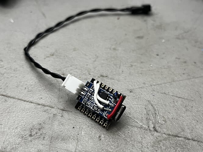

Few months ago, I made one of those little DIY CAN adaptors
I made it to fix a problem with Ankle Wreacher- the USB ports are comically inaccessible.
I added a branch/splice off my Megan’s CAN connector (by re-crimping it)
VHB taped it to my front box. Noice.

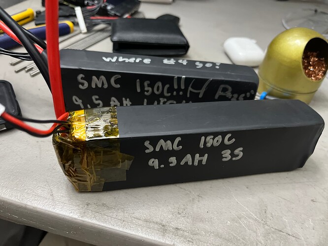

The two 4s packs that I used to run (that had this top cell drained to zero volts) have been sitting in a corner for months. I figured I’d do something with em.
I ripped out the broken pouch cell, resoldered the power wires, and re-crimped with 3s balance connectors.
And by “I”, I mean I did one and @HAIRYMANJACK did the other one.
Good as new, like it’s from the factory.
Tape some foam to the top and we’re good to go
Small Problem: the BMS harness has 4s connectors, but this battery is now 3s.
Big Brain Solution: cut away the plastic so the 3s connector will fit in the 4s
imagenius
The reworked battery lead was a little short…
so had to do some heatshrink surgery
Wired up and not on fire :+1:

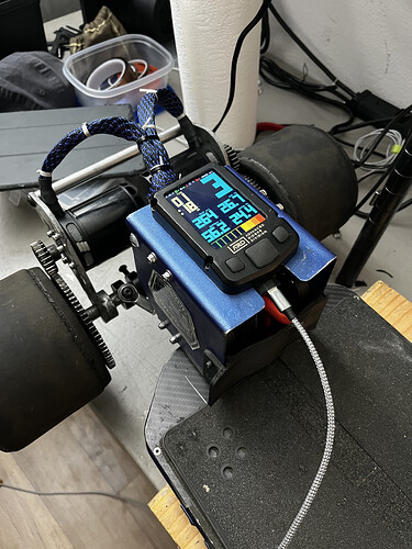

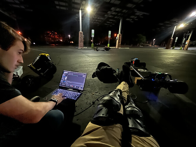

I had a bunch of trouble programming the thing. Apparently motor detection doesn’t work with the CAN adaptor? So I had to access the inconveniently located USB port.
After reprogramming, only 2 of the 4 motors spun when given power. No idea why.
Giving up at 3am, I brought the non-function board to i2s SD the following night. After some professional programming help from the man himself, @HAIRYMANJACK got my board working again. He didn’t even spend any time on track that night :blue_heart:
So, was this change worth it?
HOLLYYYYYY CRAP. yes.
This thing feels like a whole, brand spanking new board!
Most notable, the power delivery is significantly smother and more predictable. This thing isn’t jerky at all anymore, I can smoothly go from brake to coast to throttle around a corner.
Within minutes, I was doing 4 wheel slides on the BRP wides. Something I wouldn’t dare do intentially with the old motors.
That track night, I was averaging ~70Wh/mi. Significantly better then 110Wh/mi !!

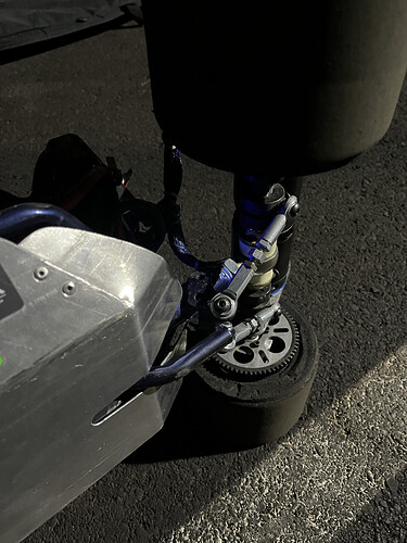

On a whim, I changed up my linkage geometry to have less stear.
I think I like it for short track, not sure how I feel about long track yet.
