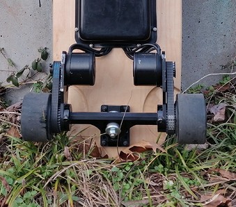

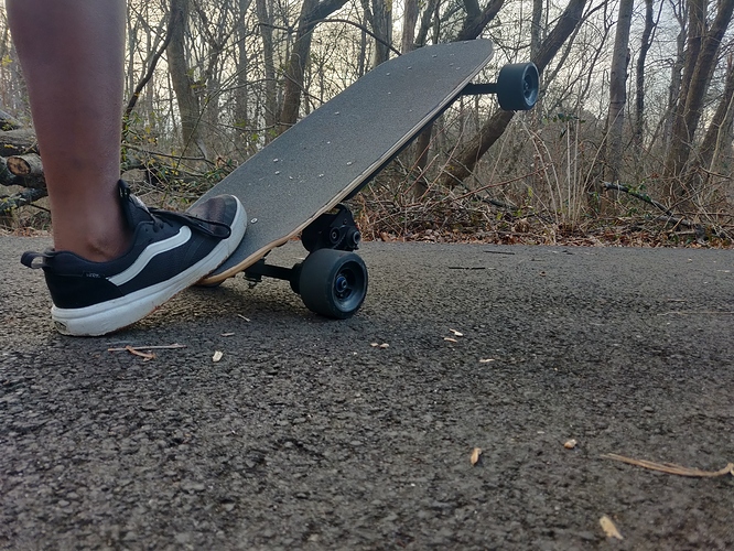

your photos have abec cored wheels
Motors: 2 x high performance 6374 brushless motors
your photos have 6355 motors.

I’m sorry but, which part of this is engineering…? I just see parts very poorly assembled… (no motor phase wire sleeves, bad phase wire management, misaligned belts (your motor mount isn’t square with your trucks btw…). And i’ve not even looked inside your enclosure; pretty sure it’s another can of worms in there.
I have so many more comments but I don’t even know where to begin…
