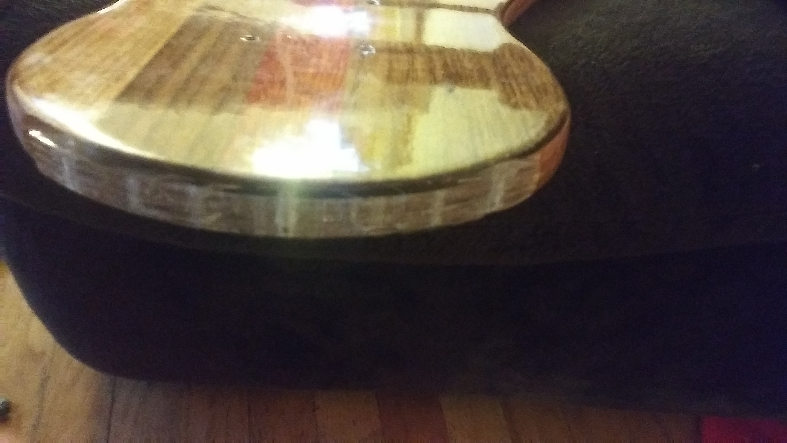

What about something like this. Would this work??
That is a very cool brake light solution! Do you know what LEDs you will be using? The TTL system outputs 12v, so as long as the light takes 12v it would work :slight_smile:
P.S. I saw your post on the builders forum. I definitely think some people would want to buy a deck with integrated brake lights :slight_smile:
