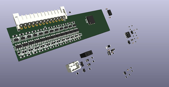

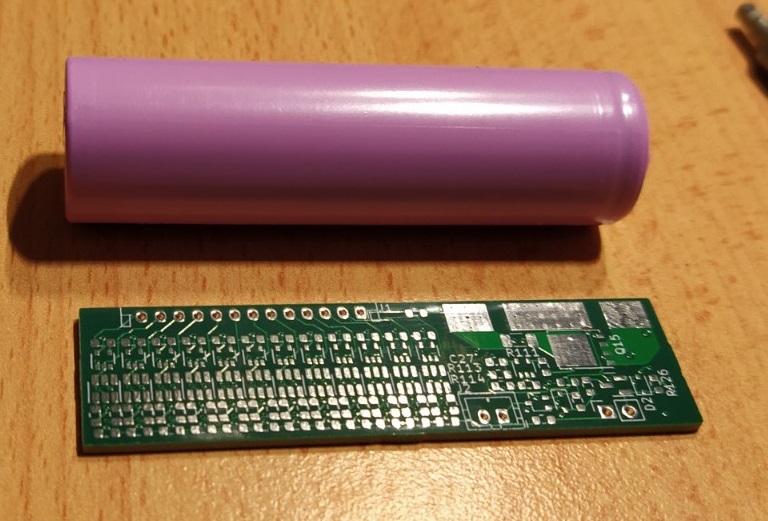

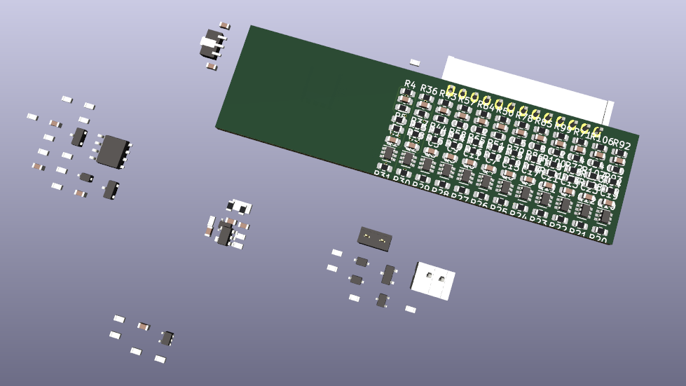

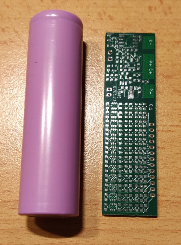

I have been getting the schematic side locked in for the first version and been working on the layout side. The 18650 sized pcb is possible.
I’ll have the first proof-of-concept board ordered next week.

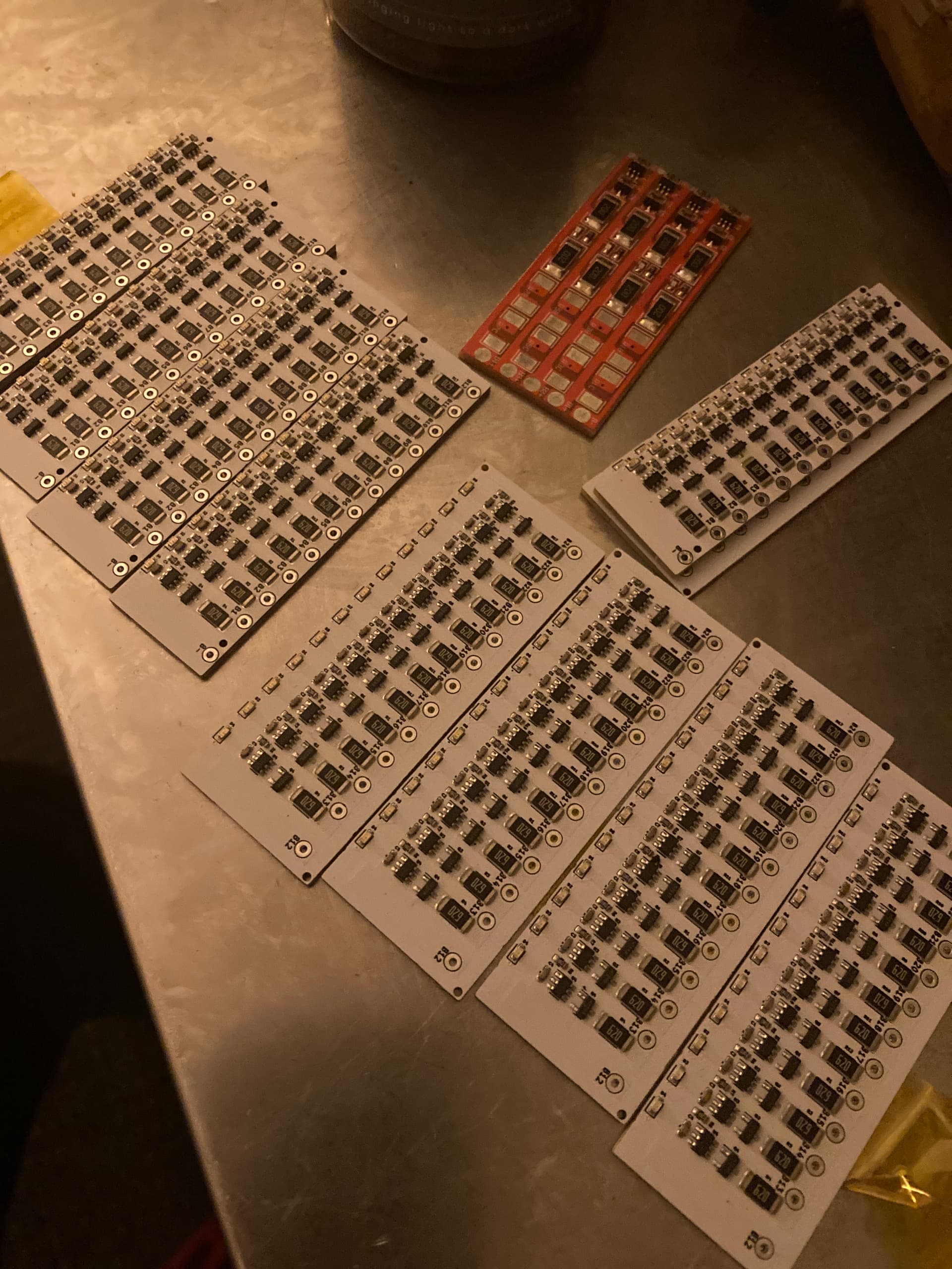

I use just discharge balancers with lifepo4 since seems safe enough; what other features are worth having with more dangerous chemistries? I had these 24s lifepo4 balancers custom made to fit a small space. The red one is the commonly available discharge balancer.

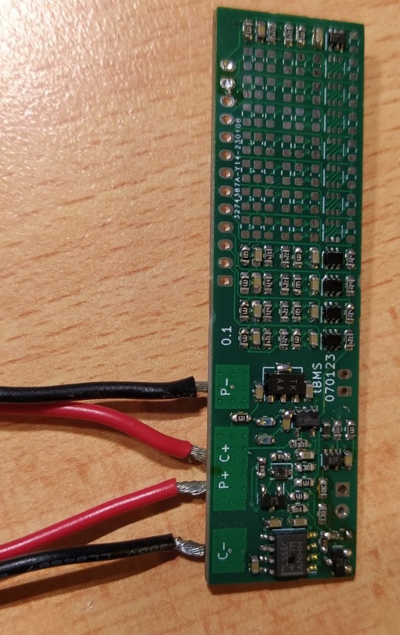

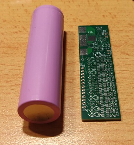

Got the first boards for the first prototype. Note, component and connector placement is not finalized yet, this is a proof-of-concept board, aka does everything work as intended.
I’ll get the parts ordered.

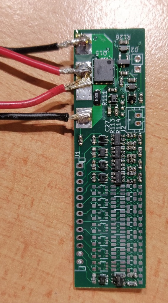

Getting some testing done on the first board. Haven’t assembled it fully yet, as I have been testing it in it’s functional blocks and then adding new ones, as I have tested, modified and verified the earlier ones. So far nothing terribly wrong in the design although I had misread a comparator’s output behavior, which caused the logic output to behave inverted then what I had thought. At least with this specific linear regulator, the minimum battery voltage for it to work correctly is about 12V (in my testing with benchtop lab PSU), but I think 15V would be a bit safer, considering the datasheet recommends a minimum of 25V, but this affects the possibility of supported S-cell configurations, as to meet that minimum voltage requirement.
I have been thinking about the possibility of ditching some of the logic level ICs and plonking a cheap and small MCU on to the board to be honest. Would simplify the control circuits and allow for more control over the whole behavior, which would balloon out of control if it was to be implemented via logic ICs.
Something like this 20-pin low tier STM32, which in a QFN-package would be just 3x3mm in size. The 555-timer circuit on the bottom side (at bottom of the picture on the right) is 3.9x4.9mm. No connections outside, just programming pads for production. I’ll look into it a bit more. It might become just a “slightly dumb” BMS https://www.digikey.fi/en/products/detail/stmicroelectronics/STM32C011F6U6TR/17075954
