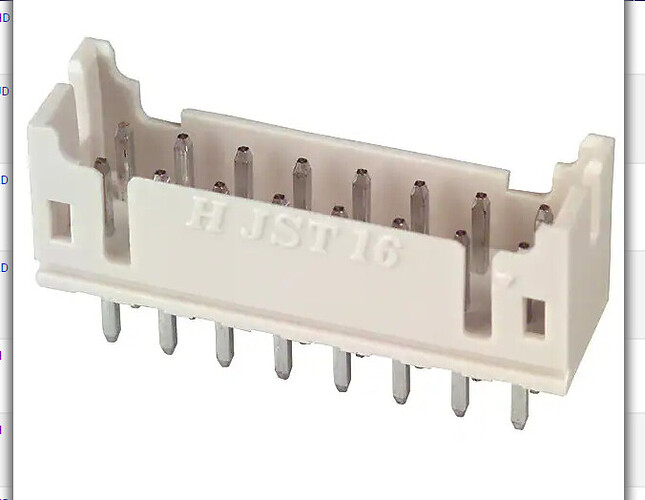

EDIT: Balance connector is gonna PITA though, as the JST PH -serie goes only up to 16-pin wide and it needs at least 17 for an ideal connection… after that the connectors start to go double-row

You could use a 16 pin connector and rely on the B- pad for 16S usage. Aren’t the B0 and B- connected together anyway? Some BMS I’ve seen don’t have B0 at all on the balance connector. Though it’s more common to have it, from what I’ve seen. Would that also mean things need to be connected in a certain order? B- would need to be connected before the balance wires are plugged in?
says “dumb BMS” right in the thread title
The reason why you usually see the dedicated wire for the B0 is that it provides a kelvin connection to the bottom-of-stack, as otherwise it’s relying on the actual pack’s negative terminal lead, which will have some extra voltage dropp over it during charging/discharging, which then causes the lowest cell’s voltage to read slightly askew. With the B0 wire, there isn’t any other current except for possible
cell balancing current to cause voltage drop.
Same as with the FlexiBMS. I recommend first connecting the pack’s terminal leads P+ and P- and then plugging in the balance connector. This allows everything to get biased to the battery pack, so there shouldn’t be any big voltage spikes when connecting the balance connector afterwards.

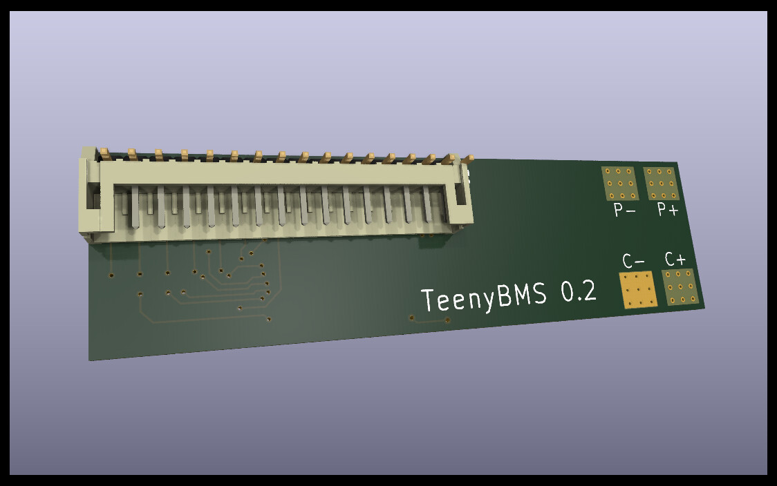

I’ve had some time again to develope the new board version (0.2) further and I really like how it’s turning out. I think I can make the whole layout one-sided, which would be BIG assembly wise and it also shows how much the total component count has gone down from the initial version.
I’m thinking of putting all the components on the bottom side and then leaving all the connectors and solder pads on the other side. PCB size is still the 18x65mm
WIP pics.

Layout wise I believe it’s doable to fit everything in a one-sided 18x65mm formfactor, but at this point it would probably need another dozen hours to optimize the layout for it, so I think at this point I want to start getting further on testing the new ICs and not spend optimizing the layout completely, so I’ll probably stretch this functional test version couple mm extra in the width direction, just so I can fit everything in faster and get started on the electrical testing and firmware writing.
WIP pics, couple components and connectors still missing and the layout is not finished.
Where are you sourcing those 17 pin JST PH headers? I know they exist because the 16s Daly BMSs come with them, but when i tried to source them for my own purposes, I couldn’t find them anywhere.
