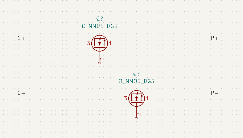

TeenyBMS, a small form factor 16S smart BMS
Guess a simple diode would do the trick, but its abit unsexy
Had the same idea and the same thought about it too, just a bit unsexy :smiley:
Well, I guess if we’re not charging with alot of amps, it kinda makes sense. Should be a fairly cheap solve tbh
I suppose something like this could solve it.
Need to figure out the biasing although :smiley:
Lets see who can solve it with the least amount of components :joy:
And no ICs
Managed to round it down to 4 components, gate might need some help tho

think its hard to solve it all with just discrete circuitry, atleast if you dont want a vast amount of components. DieBiems does most of these things, but it uses a clever IC and an opto to detect the charger if i remember correctly.
With the blocking diode you still get the full bat voltage over the port if you remove the 10k resistor. leakage thru the diode brings it up to roughly Vbat. You can’t draw any current tho, then it plummets.
Wonder if thats enough for the chargers, probably talkin micro seconds.
Been looking at different hardware implementations and I should probably specify that I meant no programmable ICs. Gonna need some ICs to implement the wanted features, is the conclusion I also ended up at.
For fault cases I think I’ll use a 555/556 timer in monostable (one-shot) configuration to have triggerable delay for stopping charging, like in an overcurrent event or too high pack temperature measured via NTC.

Not gonna help, because the problem is that to allow the BMS to work with the chargers that expect to see a voltage on their output for them to start charging, you need to get the battery connected to the charge port and the FETs on the BMS in that configuration are only able to detect the overcurrent event in the charger → pack direction and cut it off, but not towards the charge port, aka charging port short-circuit cannot be protected against on the BMS.
One problem though is that I don’t own any of those types of chargers, so I can’t test how sensitive they are to start charging. How much voltage do they need to detect on their output? Or is it based on current flow?
Should the user be responsible to place an external fuse to protect against the possible charging port side short-circuits and call it a day?
Yes. :smiley:
