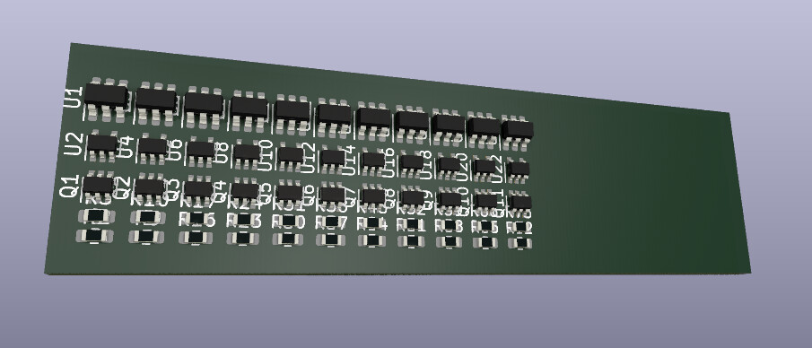

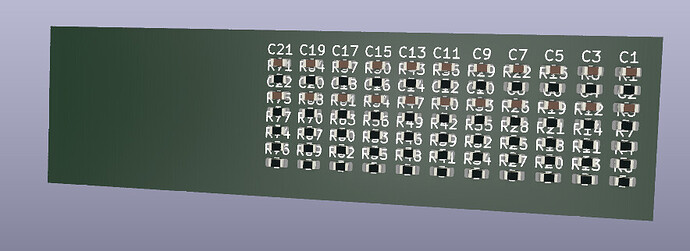

Here’s a quick mock-up with no traces routed yet of a 18x65mm (18650 footprint) size PCB with 12 sense/balance circuits placed, just to check space wise is it doable and I’d say it is. There is also space available at the end for all the discharge/charge path control hardware. Probably gonna be a bit of a squeeze, but I’ve been squeezing a lot into PCBs before.
What kind of sense/balance connector would you want? 13-pin JST-XH? and probably solder pads for all the charger, pack and load connections?
hm, if one would skip the discharge port but keep the charge port.
It could end up purdy small.

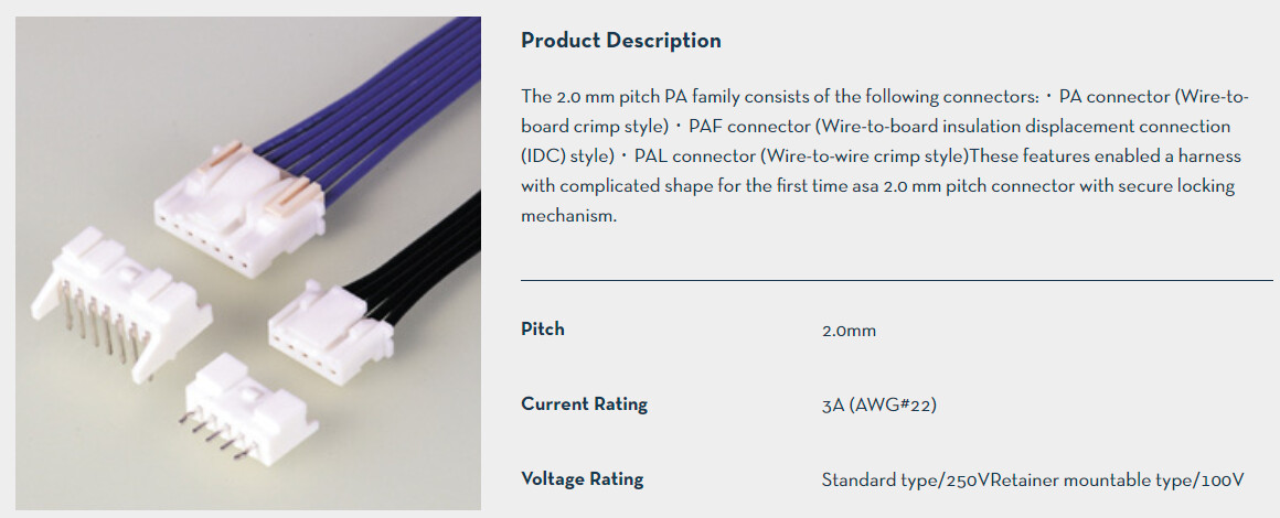

I did some checking and there are multiple different connectors used in the different models from Daly, so would you have a specific model in mind?

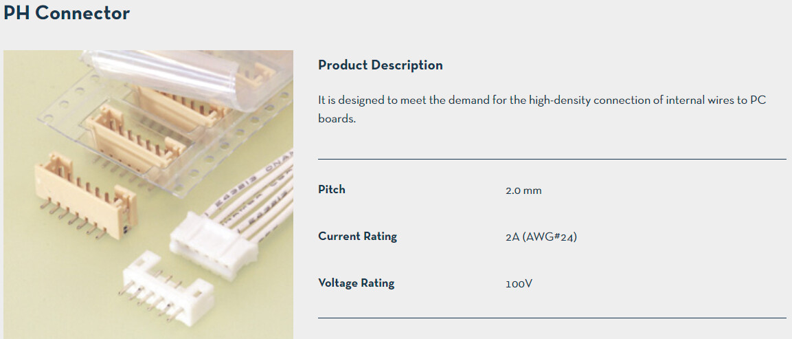

After more digging, it looks like they are JST PH -series (2.0mm pitch), aka the same connector as the VESC’s I/O-connectors.
Just to keep the footprint as small as possible, I guess you could place the connector such so the connector header and wire side housing don’t extrude so much out to the side.
This makes the most sense to me since a lot of us are stocked on 2.0 crimps

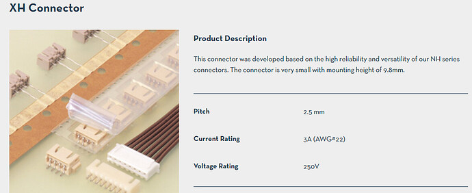

JST 2.54mm pitch locking connectors. I’m pretty damn sure it’s XH, but have to check in the morning…

It’s the pitch&connector that basically all LiPo balance chargers use w/their silicone cables…
There is however a BMS that floats around this forum that has a 4pin connector & 9 pin connector separate to plug in… I think some refer to it as a D140, but unless my memory is failing me (it is) the D140 was different & has a singular 13 pin JST connector of the favored/more common pitch. Or there are subtypes.
Anyways, the 4+9 balance connector D140 uses the wrong pitch. It is slightly fatter than the usual . We do not want that… genuinely fuck whatever engineer over there that made the choice to use the chonkier connector.

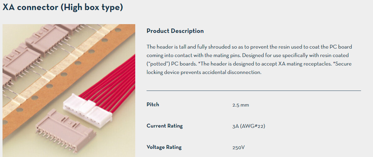

AFAIK, JST makes only metric pitched connectors. JST XH -series is 2.50mm pitched, not 2.54mm (100mil) pitch. JST XA, is the locking latch variant of the XH. I know this because I have XH, XA and PH and PA connectors in my own shelf.
