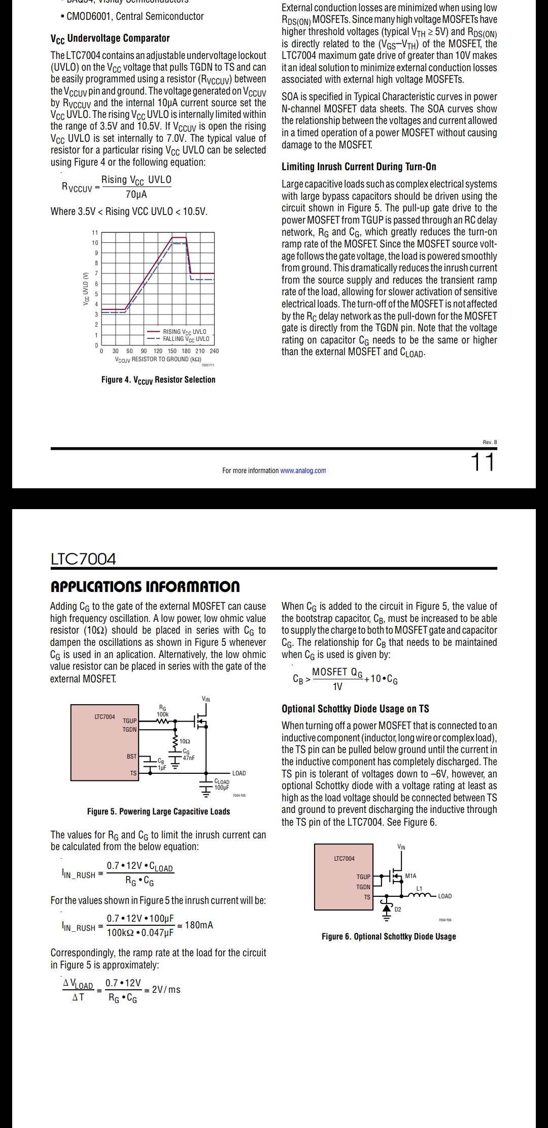

I chose a value of 220n for C1 and 470k for R1.
This results in a dV/dt of about 100V/s
Multiply this by capacitance to get inrush current.
