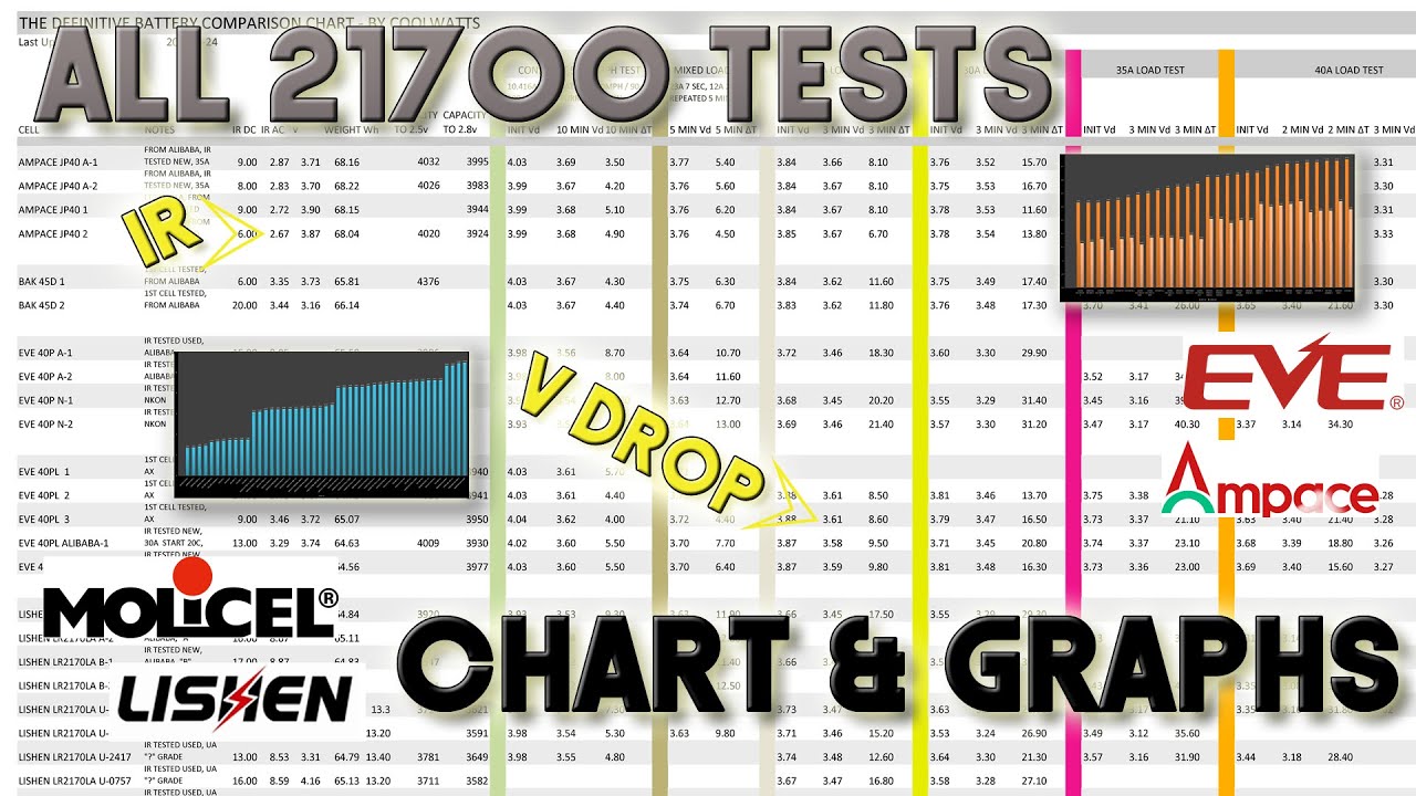

Coolwatts collated all his testing information in a new video. Graphs and such vs the earlier handwritten results.
Spent a lot of time on that. (I’m CoolWatts BTW).
Hope it’s helpful!
I think the charts really help put the results in perspective.
Just watched you video on the tabless, man what a wealth of info. Thanks for sharing!
Welp the 45D has too much sag at the current levels I would run ideally, so they aren’t looking that good for my build anymore. Where do you all buy JP40s and EVE 40PLs? I’m in Europe. I think nkon doesn’t stock either.
Edit: nvm the test data I saw was the wrong cells
