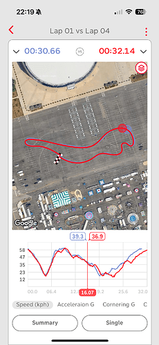

if any of y’all are curious
here’s my racbox log for the last race of the weekend comparing every lap to lap 1
especially on that first section, they did exactly as i wanted and apart from lap 5 i don’t think i could be any more identical between laps in that section

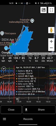

This is all I have logged, 160A reached on T-race in the 2wd days.
There’s 13.1V difference between 15A regen and 160A load, and this is a 21S pack.
